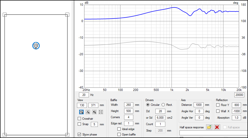

Also there may be the measurement error or very very unlucky baffle dimensions combination or similar: you have more SPL from tweeter off-axis on 2 separate regions: 3-9kHz, 11-20kHz on 10-20deg listening angle. I never observed such behavior. For my ears exactly the sweet spot is ~15-30 degrees.

Baffle is far from optimal. But fixed constraint in this build. Grill cloth is mandatory. But measurements taken without cloth.

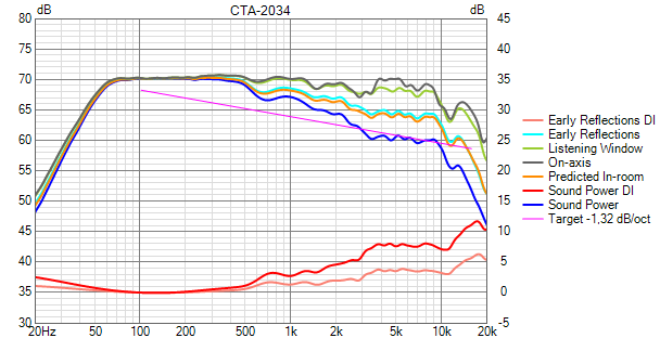

Measurements at 0 degree no EQ:
0 degree:

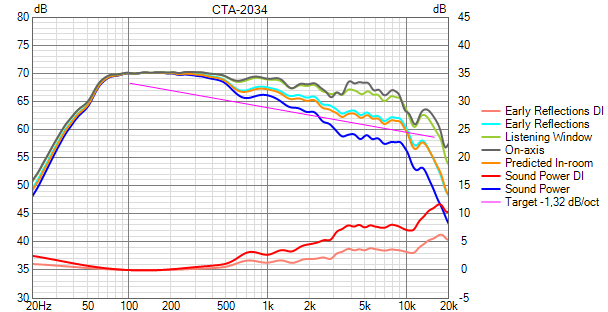

0 degree with EQ

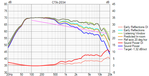

20 degree with EQ:
0 degree:
0 degree with EQ
20 degree with EQ:

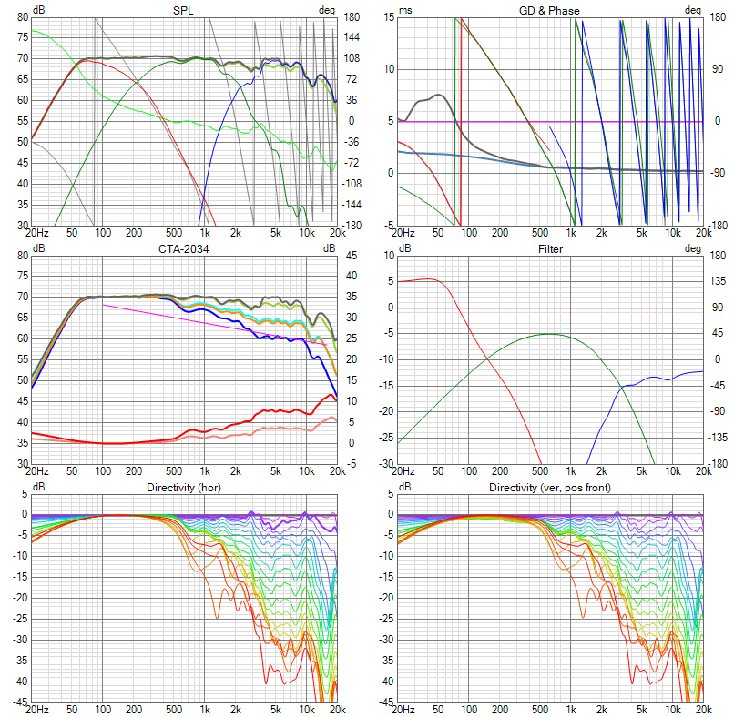

From beginning:
I did not noticed, that your sim is done at #180 at 20 degrees, that explains some ripples. #182 looks even better.
The biggest influence for high freq ripples (uneven directivity) is the area very close to the tweeter. As this is coax - there are not much you can influence. At least physics say that. Everything looks more or less ok now.

Your sim can be a little incorrect, because variable impedance does impact overall SPL curves.
For now you can try to use impedance from VituixCAD cabinet sim for woofer(s), There is export function. Use manufacturer data for tweeter as is. You probably will need to use another VituixCAD tool for that: SPL trace.
After this I think your sim will look somewhat different.
