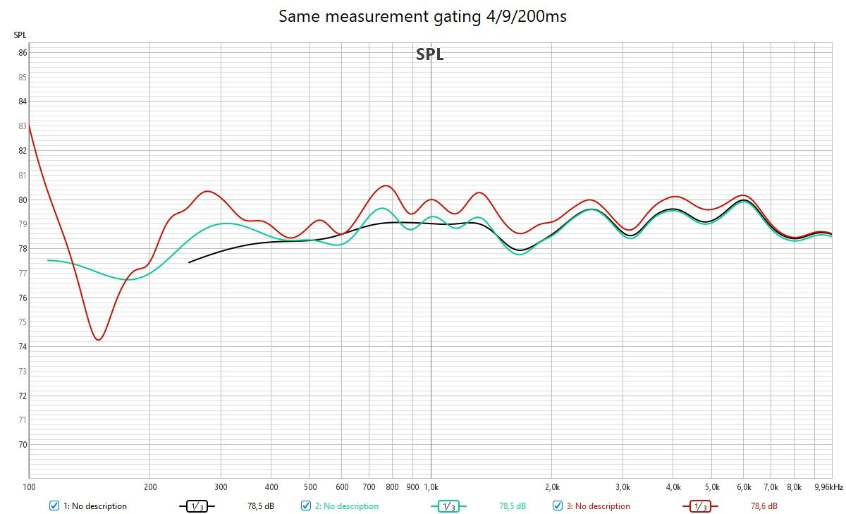

Ok, such short gating shows lower bass spl than long gating. As well cuboid "baffle" has more loss than "normal" box with flat baffle.

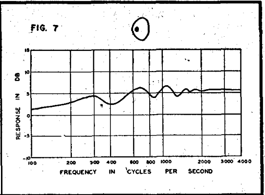

Let me recite Olson (AES November 1951...) once more. The half sphere isn't exactly a favourable shape for a loudspeaker.
diyaudio has many threads of spherical enclosures, most with fullrange or coaxial.

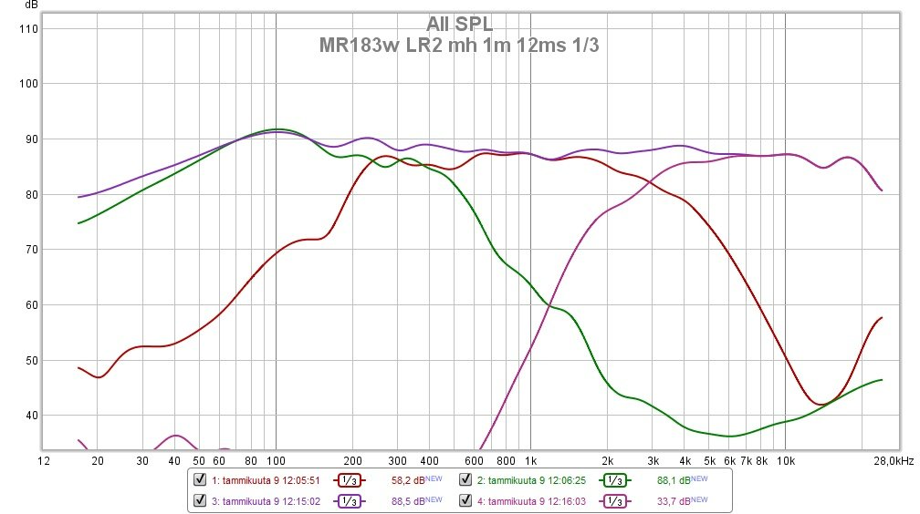

I didn't save individual drivers' dispersion measurements. The midwoofer was relatively easy to eq.
An example of the effect of short gating to bass spl

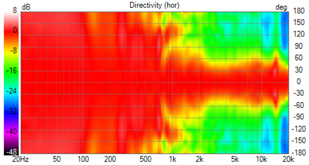

Half sphere connected to cuboid, so it is a hybrid between full sphere or even "droplet" type, like B&W Nautilus AND classic rounded edges cuboid. I mentioned that in #167. In other words, you take classic box, add a small bowl on front and put driver in there. And the measurements show very gradual change from 0 to 180 degrees, no signs of heavy diffraction.
It is NOT a classic half-sphere with flat back - that thing probably is awful from ~90 to 180 degrees.

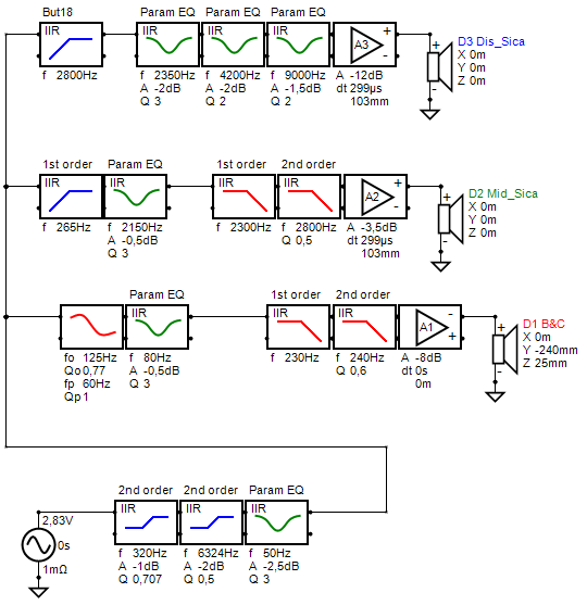

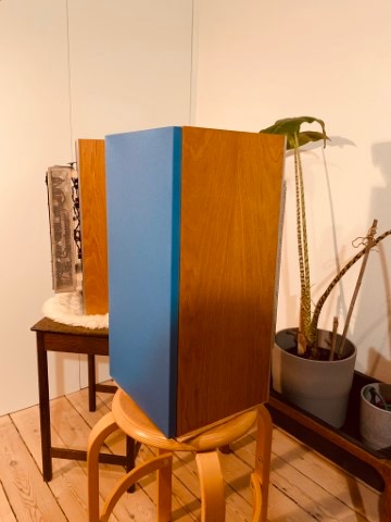

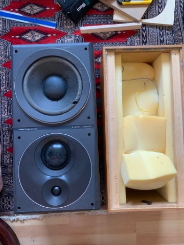

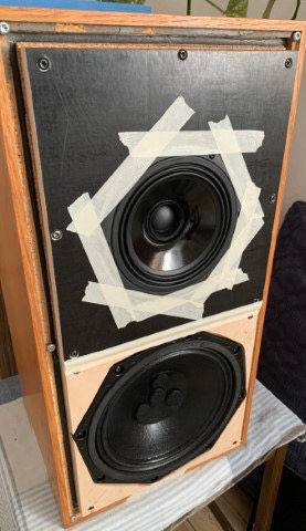

Here is my take on Sica Coax 5”. Paired with B&C 51ndl.
Cabinet is old B&O that I sacrificed from rain on the street. Then enforced and added front grill attached with magnets.
I have made inner cabinet for the Coax. Takes to much volume, so B&C is limited because of only some 7-8 liters of volume.

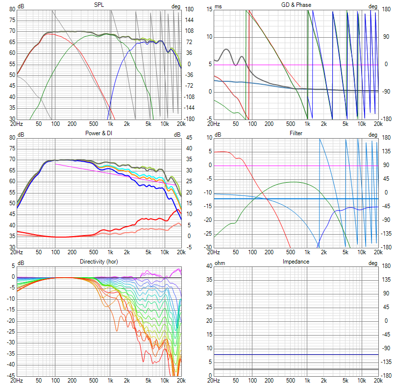

It was my first serious take with VituixCAD. It took many iterations before I was happy with sound. Global EQ could of course be removed and also pictures of simulation is at 20 degree.
Maybe because of my room, but In this build I found it important to tilt power response downwards quite a bit from 6000 hz and up. Else treble was to hard to my liking.
