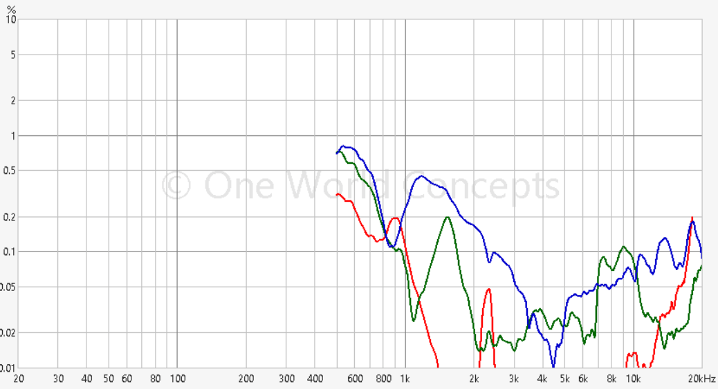

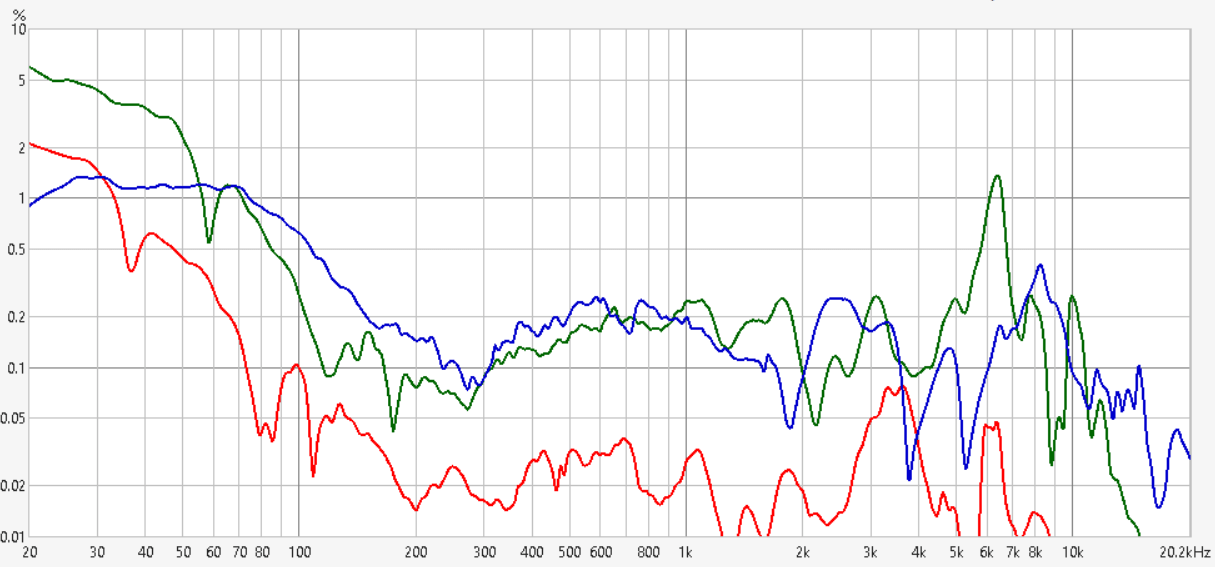

Here some measurements.
Hopefully I can do a full set next week or the week after.
Not sure exactly about SPL, but must have been around 90dB @ 1m or so.
Measured with Line Audio Microphone at 96kHz Sample rate in a VERY stuffed little cabinet of just a few liters.
So some very small issues might show up from internal resonances.
edit: resonances will be around roughly 765Hz, 1150Hz and 3kHz
Nothing really to see there 🙂
Although we've already decided to go for the other mysterious coax
This is the SICA 5 inch coax.
blue: 2nd order
green: 3rd order
red: 5th order
(other harmonics didn't show any relevant data)
Woofer at 10cm:
Tweeter at 28 cm:

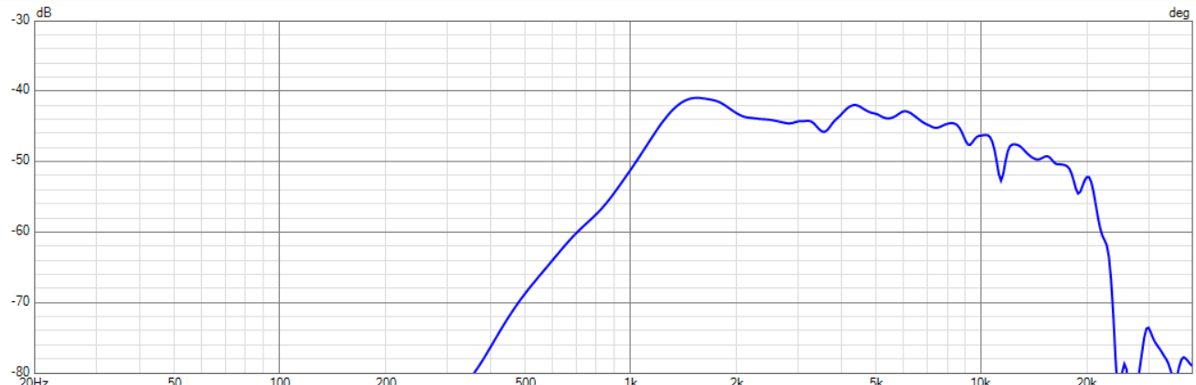

Freq resp of the tweeter on-axis, 26x40cm baffle driver placed at 30cm.
Distance about 80cm or so
There is a bit of a dip around 11.5kHz
I haven't checked other measurements yet or if that could be an issue of the baffle.
Nevertheless, any dip that high is not problematic.

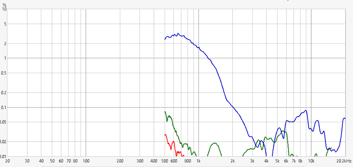

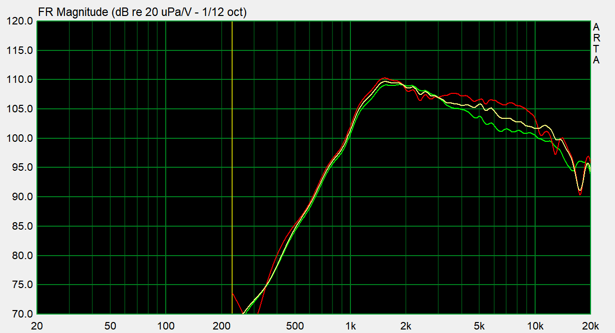

Here some preliminary data of the mystery coax.
Levels aren't calibrated, so don't look at those.
No pixel peeping allowed either! 😉
I am nog gonna show the performance of the woofer.
Freq resp is 0, 15 and 30 degrees and is pretty workable.
It starts to have some issues above 12kHz or so, which seems to be common for these kinds of coax units
The 5 inch Sica has this as well, and is in fact even a bit worse.
Haven't checked the full directivity yet, but will do that in the next couple of weeks.
Distortion measured at 10cm and 51cm with a Line Audio microphone.
Didn't check the levels (ref to 1 meter) either.
I have to measure the impedance as well, but the report from the manufactuur says it has a Fs around 1500Hz.
Looking at the distortion graphs as well, I was hoping that the distortion would go up at a lower frequency.
2500Hz might be just doable.
The tweeter is smaller compared to the Sica btw.
Levels are NOT the same as previous measurements!!!!
The performance of the woofer will be heaps better than the Sica.

edit;
My apologies, I just saw that my previous measurements were done at 28cm.
So I will do that again 🙂

Measured on a typical baffle or "IB"? Some bunching between 2-3kHz 🤔Freq resp is 0, 15 and 30 degrees and is pretty workable.
Oh yes, this is just a simple baffle, not a AES baffle (yet)
So there are some obvious diffraction and baffelstep problems going on 🙂
