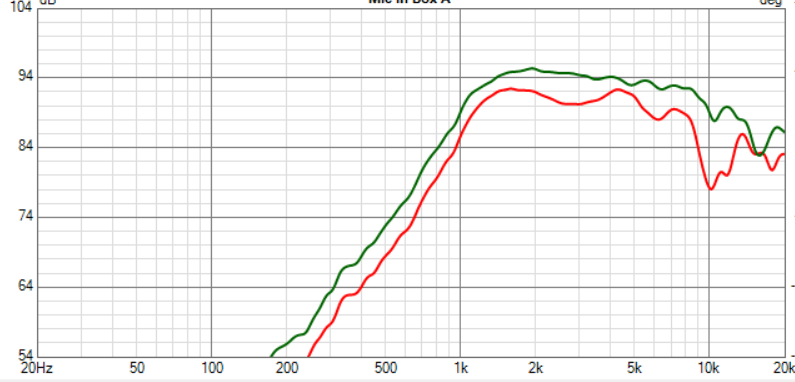

I thought this would be some very useful information for those who're interested.
Still a mystery coax unit (sorry guys), but the only difference between the two is a single roll "rubber" surround (red) and triple roll surround (green).
Literally ALL other parts are exactly the same.
Added 3dB to the triple roll for reading clarity.
50dB scale.
I do have some off-axis information as well, but that will take a while to get ready.

b_force: you changed Sica Coax to standard rubber surround? (The Sica Surround is actually rubber btw)
This is not that (same) Sica coax (as mentioned earlier in this thread)

That was to be expected, the half roll rubber surround is a lot higher than the triple fold, which will be reducing the reflections and wave front bending. The dip at 17k isn't great but the linearity and easier handling are so much better. If you want to continue to experiment with the surround, you could try an inverse half roll and also foam surround which got very low losses while maintaining a much high inner damping. The downside is, ofc, the life expectancy of the surrounds are about 20-40 years, depending on the UV stability and UV light (daylight) exposure.
Yeah I know, but it's nice to see this 1-to-1 under the exact same conditions 🙂That was to be expected, the half roll rubber surround is a lot higher than the triple fold, which will be reducing the reflections and wave front bending.
