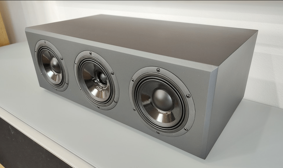

I created 5"coax + 6,5H woofer 3way, so resulting sensitivity was around 85dB/2.83V. This worked and sounded very good. I tried to model the crossover for two 6,5H woofers in parallel, and 5.5coax midrange ran out of the sensitivity, so I decided not to try further. So for higher sensitivity 3way I would recommend 6" coax, I found it also little bit easier to work with.
I am thinking of revisiting 5"coax + 6,5H woofer 3way, making it simpler and easier to build, and publish it. As I am stuck in other projects this will take some time though.

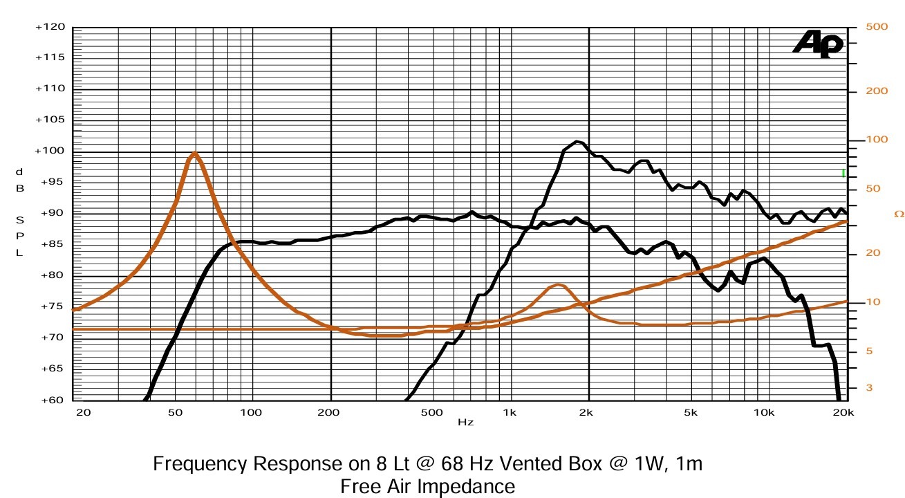

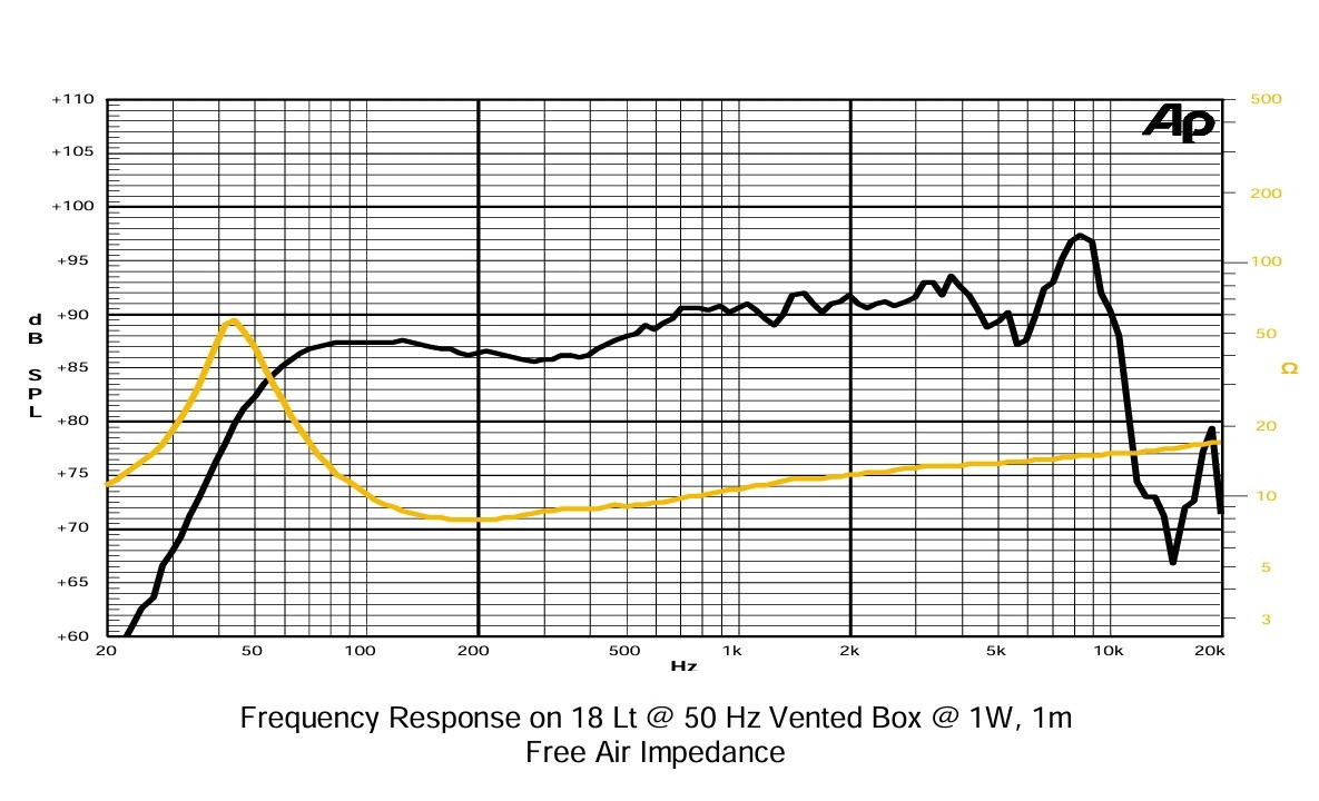

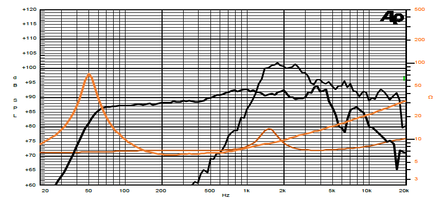

The effect of demodulating rings can be seen on the impedance graph in the mid and hi frequency range (demodulating ring reduces inductance of the voice coil and changes the frequency dependence)
Sica 5.5c1.5cp coax without demodulating rings
Sica 6.5h1.5cp mid with demodulating ring/rings
6.5h1.5cp
... and here is the coaxial 6.5C1.5CP impedance graph:
Seems in the coaxials there is not enough space for demodulation rings?
