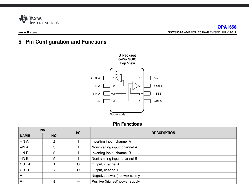

OK, so I'm about to solder some OPA1656 to DIP8-adapter boards, and start getting anxious about the pin orientation. Is pin nr. 1 the one in the lower left corner in the orientation of the text, under the white stripe? Or are there any other markings? I can't find any dimples or rings to indicate pin 1.
I believe white bar marks pin 1. This information seems hard to find, but multiple references indicate so. Here is somebody complaining about it on a TI forum (albeit 11 years ago):

Thanks! I found some indications of the same and just went ahead and did it. 🙂

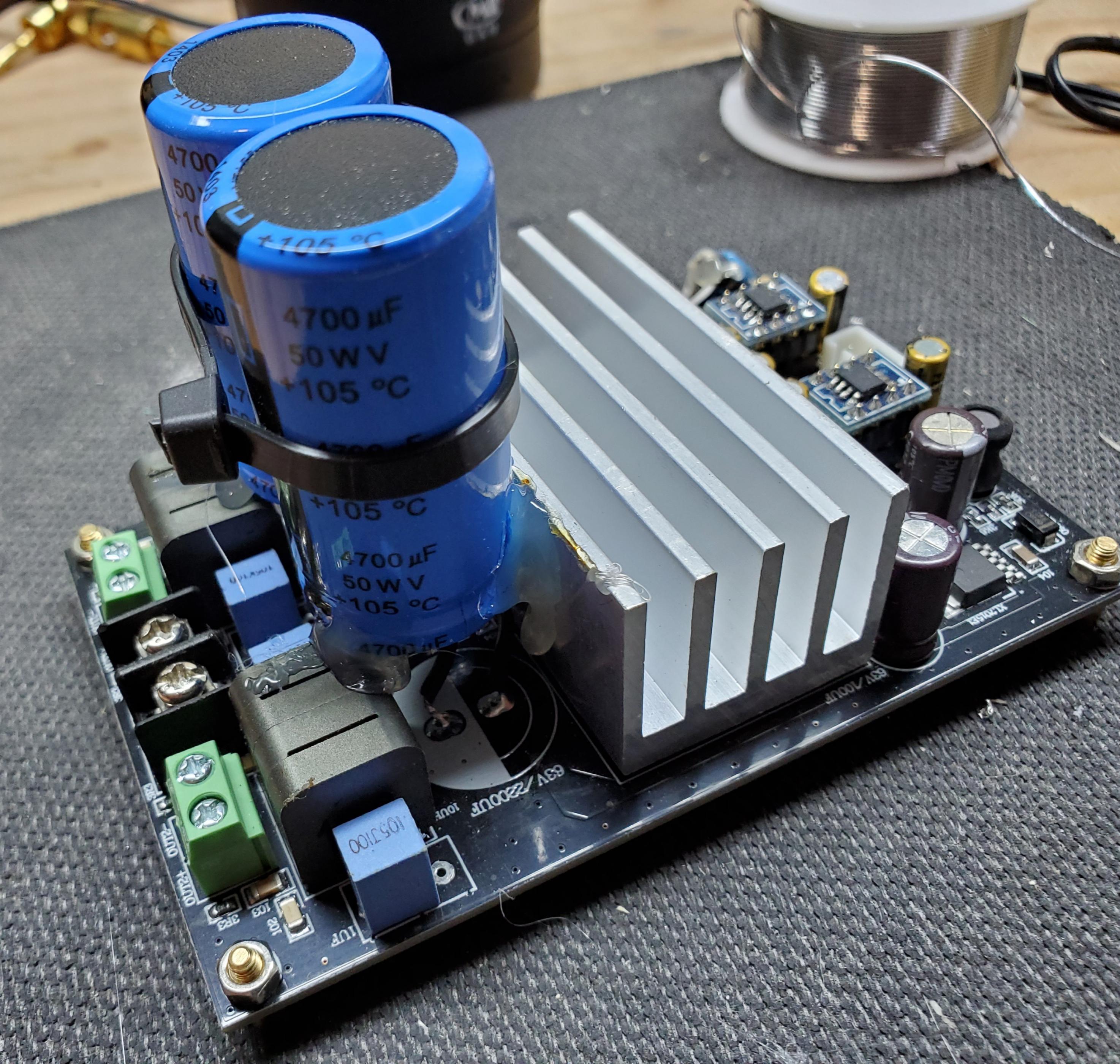

I changed the 2 supply condos to CDE 4700uf. I temporarily put OP1612.
I have to let the condos break in and then some serious listening. Quickly the change of condos seems to have dynamics at all frequencies.

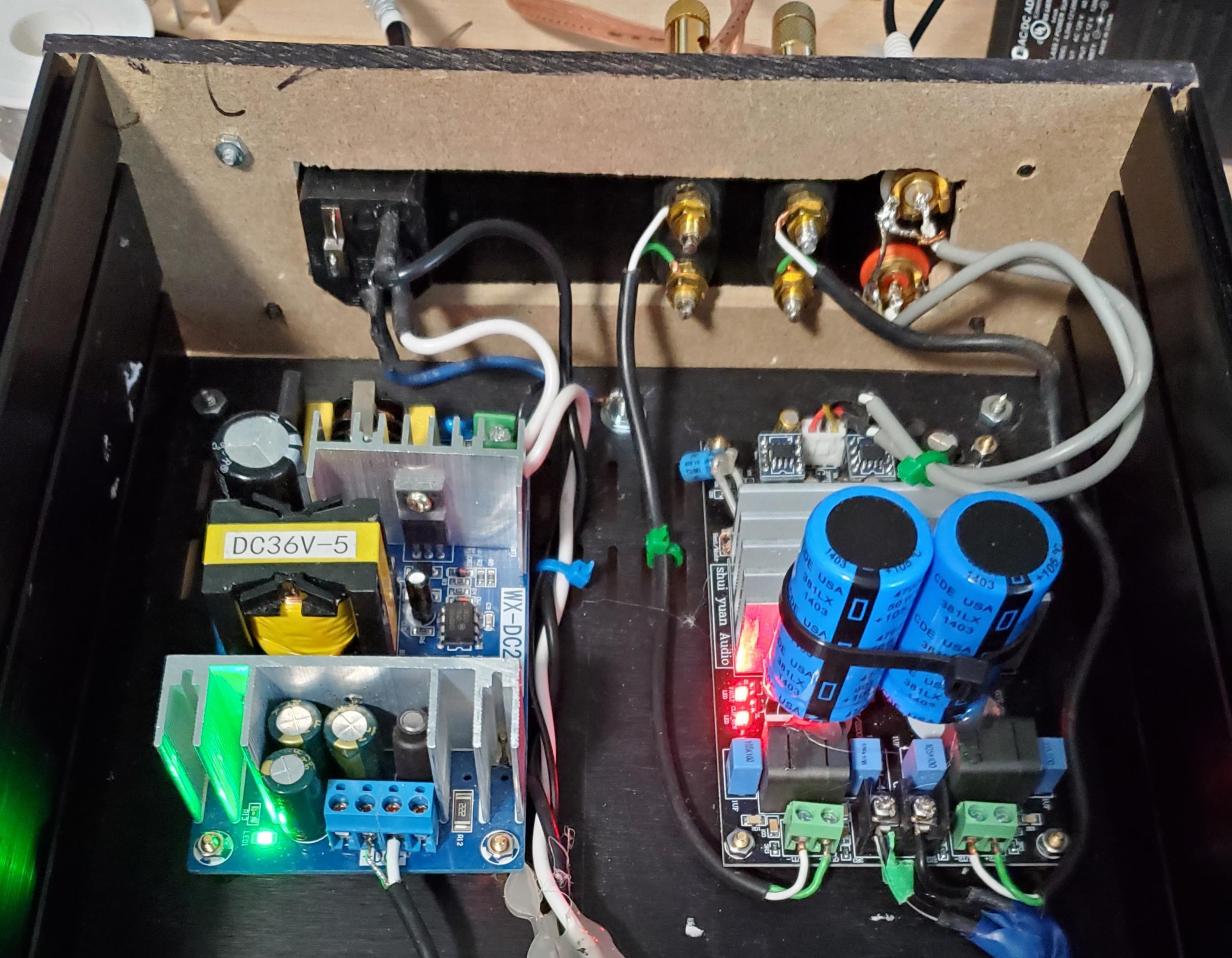

The 3255 was in a bigger case with SMPS 36V 11A, I moved the 3255 to a smaller case and added a 36V 5A SMPS. It doesn't sound like much but it's enough power with my speakers.

I wonder why did you use those big 4700UF caps ?
I am using 4700uf Nichicon Audio grade caps as well, just need to make sure you get the right diameter (see my review : max is 20mm)
Yes Daniboun,
I know about Nichicon Audio with a maximum of 20mm, but it was a friend who had these condos in stock.
The appearance doesn't matter to me anyway.
I'll come back to you with my impressions of the sound. I am waiting for the arrival of my OPA1692, but for now the OPA1612 impresses me with this 3255, I am rediscovering the OPA1612.
