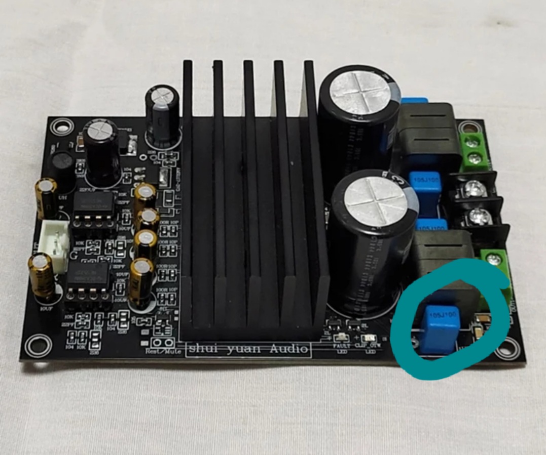

You are right that the square pins are too large for the sockets and will very easily damage them so normal chips will be too loose.
The adapters you found on Amazon are almost certainly too big to fit in the space provided for the Op Amps on most boards.
The small adapter cards are really the only solution but must be used with round pins -These are .5mm in diameter.
Thanks for your confirmation. I am too scared to try it again on the amp now, so I'll give the round pins a try when my new board arrives.

I share with you the effect of the OP Amps update on the 3E Audio TPA3255 finished amp. Rolling some new OP amps can help and improve performances.
I imagine the reasoning can be repeated for the other TPA3255 modules
The LM4562 is a Bipolar OP amps, should be nice to see VS the OPA1612 (Bipolar as well) but checkout :
OPA1612 has slightly better specs than an LM4562 > less noise and distortion, faster, and more output voltage swing.

I would answer the following :
As per THD+N + Noise : theoretically, the performance of the module is improved and as you can see the impact is not minor )
I don't know what do you mean by Sonic performance ?
If you ask this eternal question to a Class A enthusiast, he will probably answer you that the measures are not a guarantee of musicality ... and that the sonic performances are therefore better with the Class A...
I have an allegory concerning OP amps: OP amps are to class D what tubes are to class A. Even if theoretically this is not true.
But you can change a "sound signature" with a OP amps updgrade )
