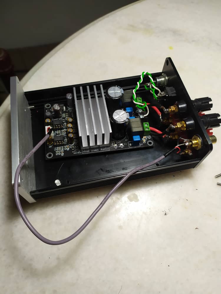

Hi there,
My unit actually came with the connector and wire. I just needed to solder it to the input terminals.
Looks like Shui Yuan may have missed that out? You could ask them to send it to you.
I use mine with a 32v power brick, and for the time being its installed in this case I got from Aliexpress :

Hi there,

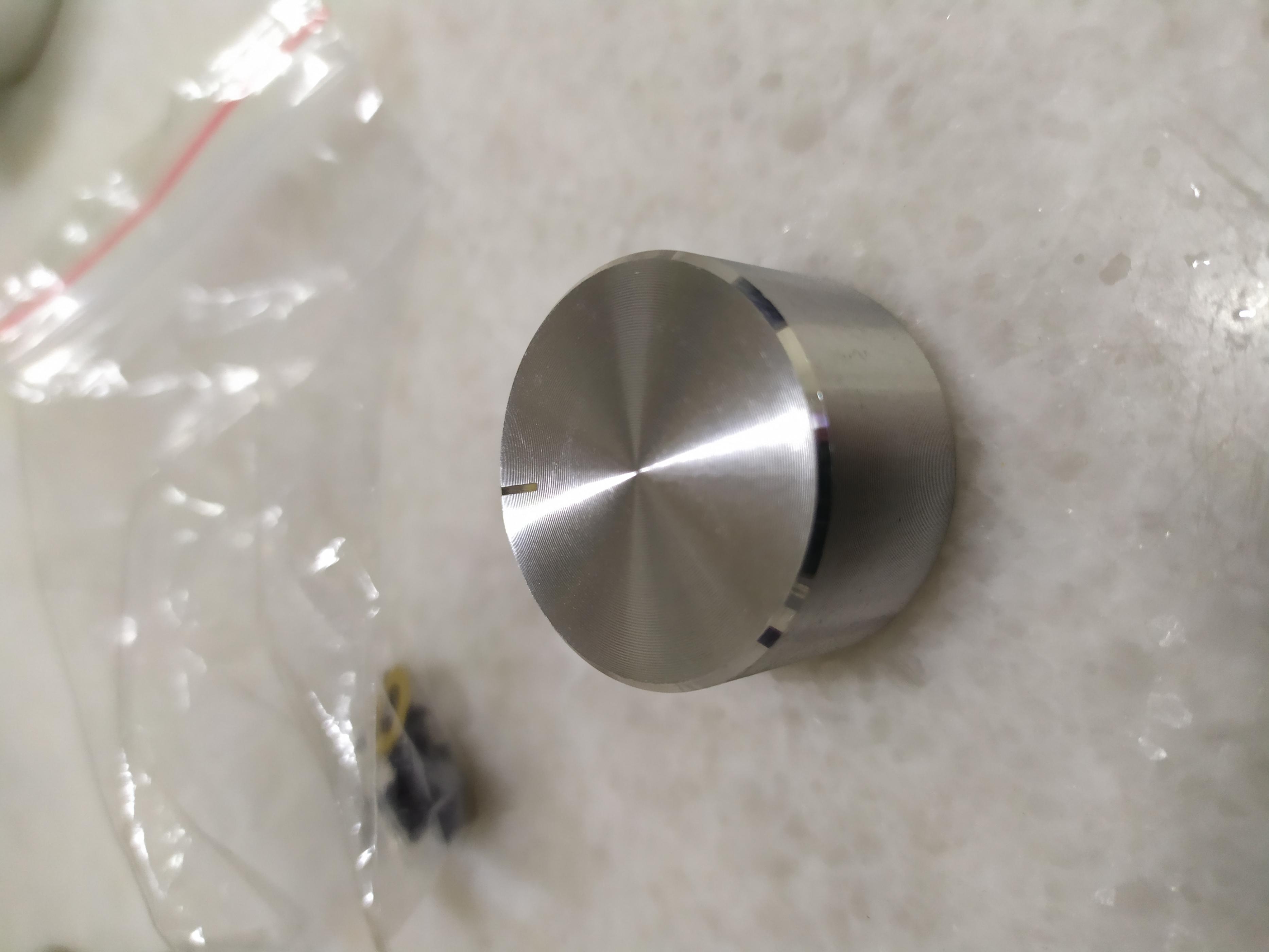

According to info from your link, the knob might be different than the one from the pic ("30 mm aluminum knob (note, not the picture of the aluminum knob").
How is the one that got delivered?
Hi, According to info from your link, the knob might be different than the one from the pic ("30 mm aluminum knob (note, not the picture of the aluminum knob"). How is the one that got delivered?
Come to think of it, you could be right, because I remember the actual knob being smaller than the one in the Ali ad. I put it somewhere since I'm using the Shui Yuan connected to a separate preamp but may decide to get a volume pot later. I'll post a pic of it once I locate it.

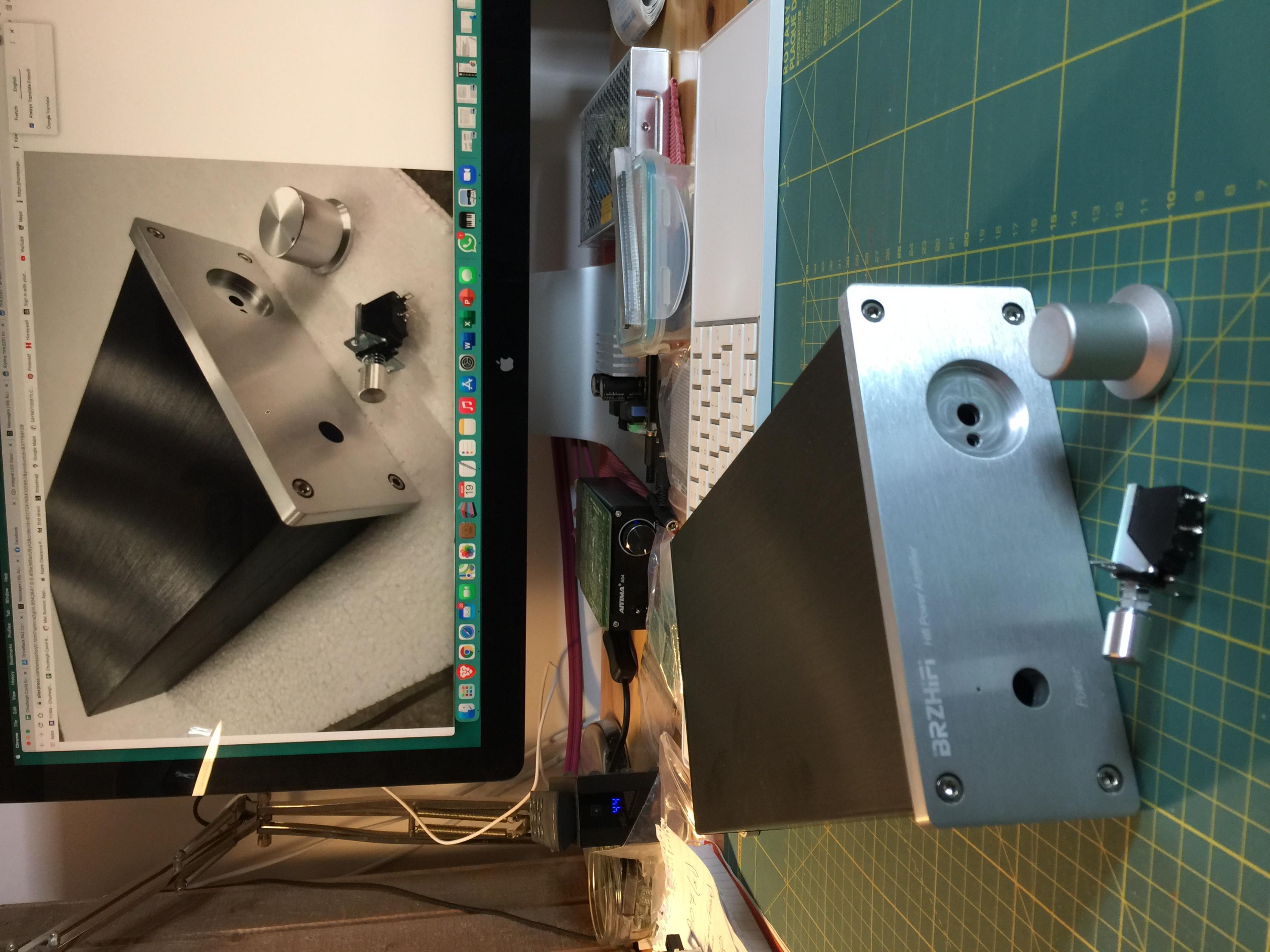

Cases not being the same as description !!
I am having real problems with some Chinese Suppliers not shipping what is in the description or in the Photos.
I just bought this case from the "Weiliang audio Official Store". Picture of the original is on my screen behind what was received.
Different Front Panel. (Engraved with BRZHiFi logo - Not wanted).
Different Back Panel (Extra hole for Bluetooth aerial - Not wanted).
Different Knob - I really wanted the nice large heavy turned knob - Not the small crappy one !!
When I complained it was not the same as the description they offered to send me replacements. Good start. So I offered for then to send me the parts with an order for another case so they could save on the postage.
Clearly this was lost in translation as I then got a reply that I should not purchase from them again and I am now blacklisted from their site !! They have refunded me for the case !!
Shame as I like their products and would happily have continued to purchase from them.

I did mine in a really compact case.
You don't need any AntiPop mod, the module has this function enabled.
The Shui Yuan module is particulary interesting if you intend to use it with a compact PSU. If you don't care about te size, the HanZao is a best choice.
here some pictures of it can help :
