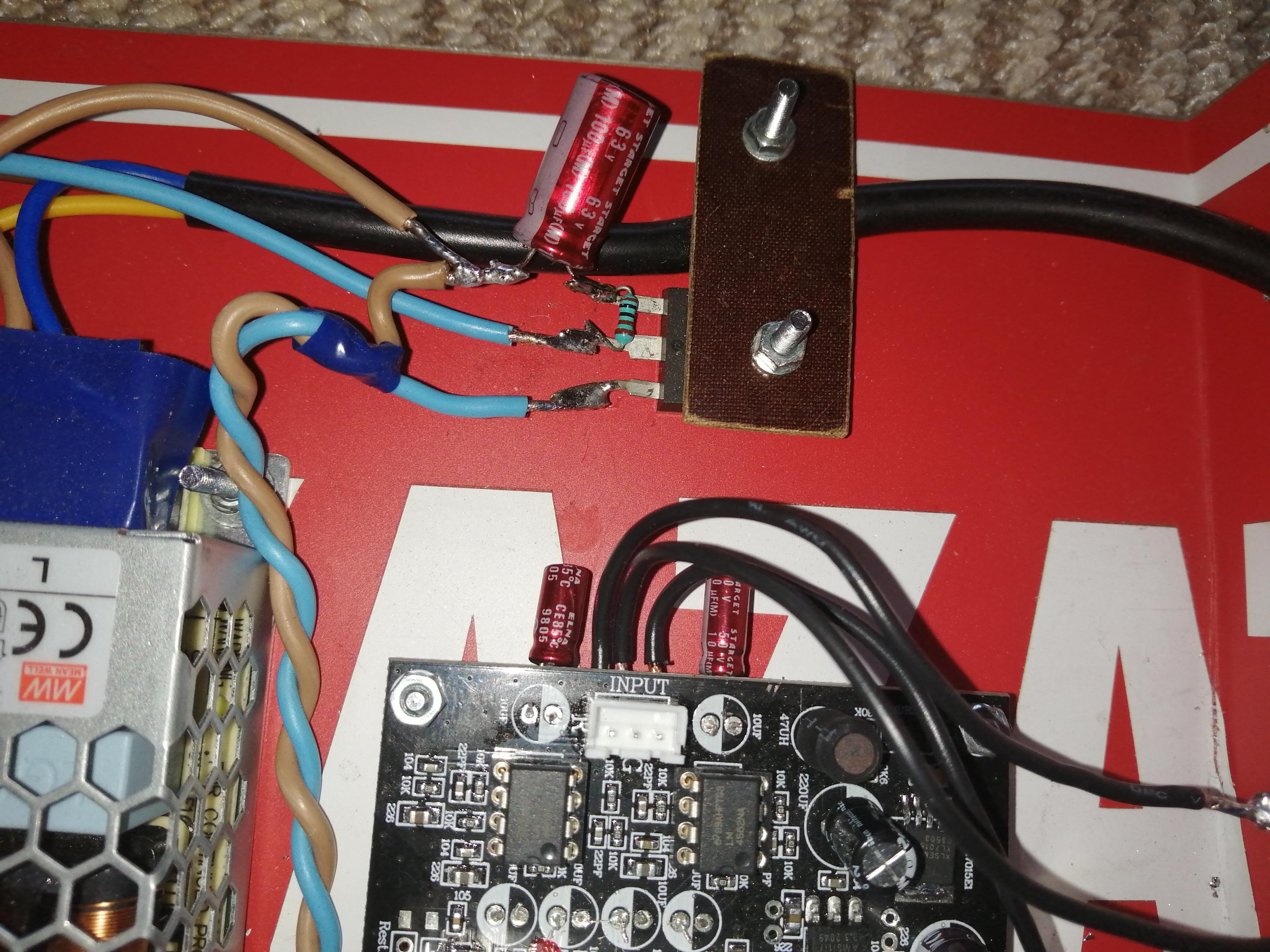

I have experimented a lot with the TPA3116 amplifier in the past. I came to the conclusion that a capacitance multiplier and a regulated power supply are beneficial. The lower voltage always resulted in a smoother sound. The situation is similar with the TPA3255 amplifier. We tested with a friend for hours yesterday and I can tell you this is one of the best sounding amplifiers I have ever had. (Various Pass Class A, Hiraga Le Monstre, JLH, Penasa Myref rev C, Tripaths, TPA3116 (8), etc.) Plays with extraordinary dynamics, musicality, liveliness. The stage is huge, with excellent separation and details. The capacitance multiplier is very sensitive to the capacitor. I use paralell 2x100uF Panasonic FCs. The supply voltage after the smps is now 29v and the sound with this solution is the most favorable for me. I think this amp is a good starting point for most diyers.

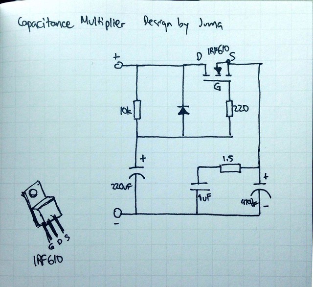

Hi Zek, I hope you understand the wiring diagram. It’s a very simple multiplier, but for me it gives the best sound.
Could I use the IRF540 or IRF640?
Hi SinGun, I only tried with TO247 mosfets (IRFP140, 150, 240). I recommend this simple multiplier up to 300-400mA. At higher currents, a Juma or Pass multiplier can be used with safety. In this case, mine works perfectly. I tried with 100uF Elna Starget and I really like it. Thanks for the suggestion.
Hey Joe, thank you and nice to hear that you could enhance the SQ with Stargates. I will implement the CM for my opamp preamp first, after that I will build a CM for my TPA3255. Could you suggest a CM schematic for at least 4A?
For high current amplifiers the multiplier doesn’t give me a better sound. Works well in preamp, DAC, D-Class. Juma’s schematic also works at higher currents, but needs to be cooled. I’m not sure at 4 amps, I’ve never tried. In the TPA multiplier, I doubled the Starget capacitor (now 2x100uF), the sound became more dynamic, the bass was better.
This capacitor multiplier will not help much with the power supply transient load response to a sudden need in high current for the load (high crest factor audio signal), it mainly just filters low frequency ripple.
