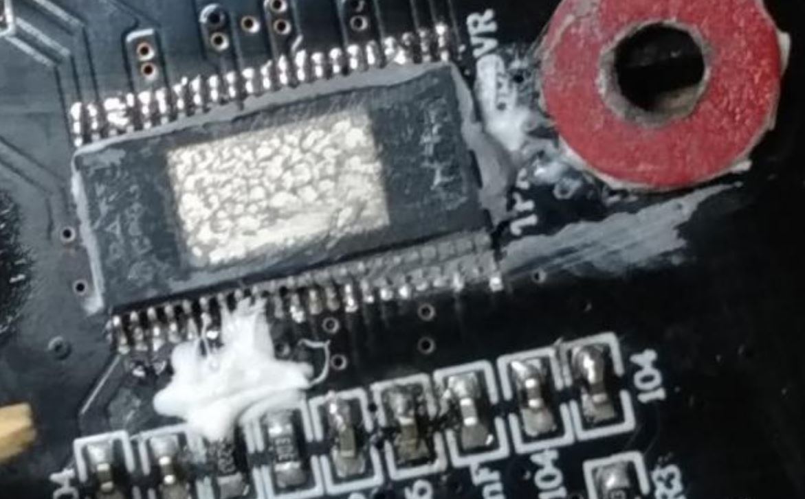

4th: seems like TPA3255 IC soldered by hands and not so good. White substance feels like caulk!

It is obvious that the welds are done manually ... Regarding the thermal paste, it seems a bit messy (I imagine, however, that having disassembled the heatsink must have spread it).

1. White substance is NOT thermal paste. It's kind of caulk to keep TPA IC in place or so.

....White substance is NOT thermal paste. It's kind of caulk to keep TPA IC in place or so.....
The White substance looks a little like RTV Silicone
Right. My point is what's reason to use it? Heatsink uses the screws to hold in place, TPA chip should be soldered etc.
The other picture of the amps boards doesn't have signs of this adhesive.

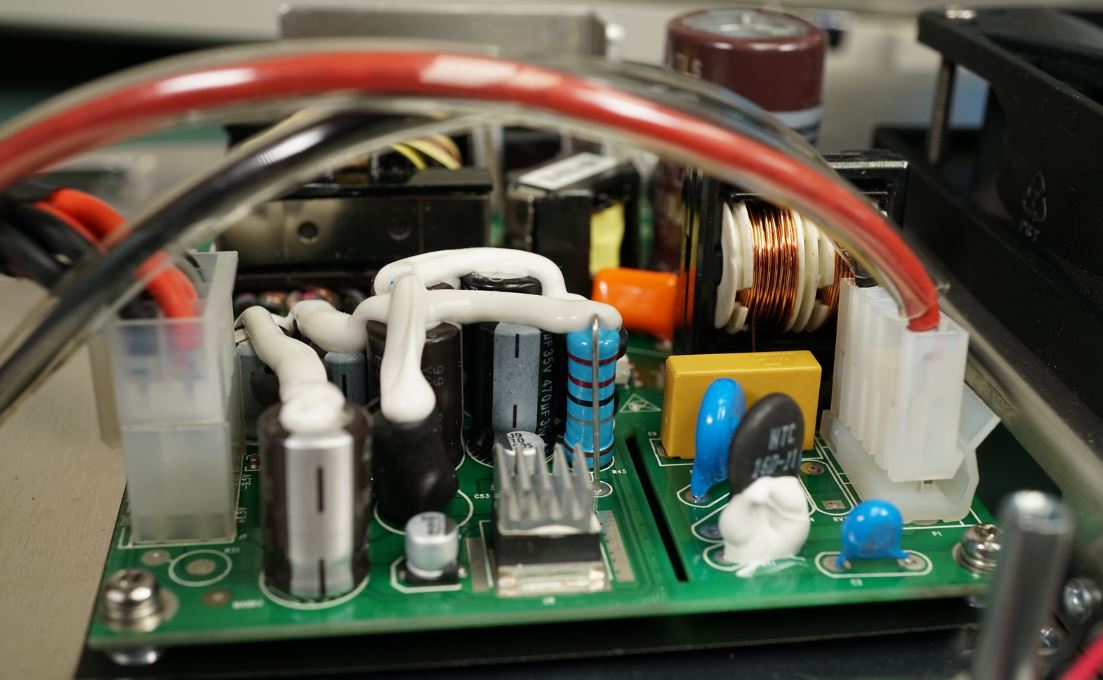

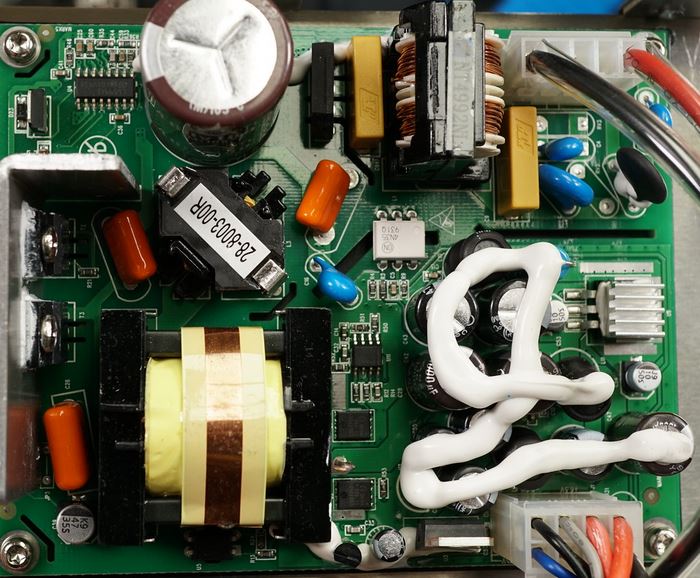

Its common to put this adhesive around SMPS components to keep them from moving around. Often these products are shipped in a container on boat for a few weeks & they get shaken a lot. The Mfr does not want anything coming loose or breaking a solder joint.
See this tear down of a Siglent SDS2000 series oscillocope. There is goop on the SMPS components: EEVblog #1309 – Siglent SDS2000X Plus Scope Teardown+Hack – EEVblog
Also Apple TV circuit board: White glue on circuit board
Siglent SMPS, below....
Guys, are you serious?!
all pictures simply show caulk on trough-hole components instead of tiny SMD chip on mine photo. The reason to use the caulk/adhesive/whatever - to fix big chunky part in place and/or additional HV protection. However, I'm not PCB design professional like each other in this discussion, I just have some engineering background.
This silicone was under the bolted down heat sink? Does it wobble, when bolted down on this board?
There is no silicon on the board I purchased as seen by the photo.
It is quite clear these boards are assembled by hand. They don’t appear to have gone through a solder flow machine. Even the SMD components and the main TPA3255 chip appears to be hand soldered.
So I am guessing there may be a little gang of people assembling these boards and each will do it in their own way.
It appears your board may have the spacer washer also “glued” in place with the silicon. Maybe this was to ensure the heat sink didn’t short out the SMD components under it. There does appear to be quite a lot of solder on some components. Probably just a quick fix !!

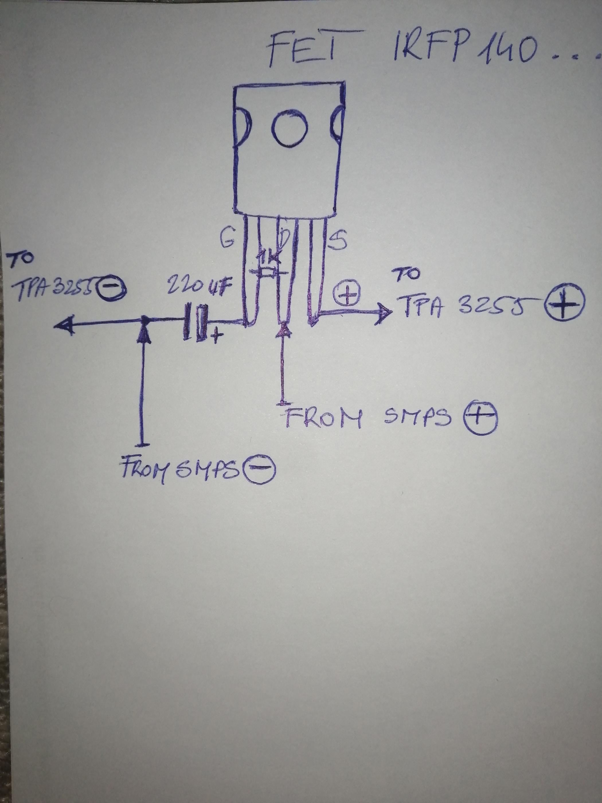

@joezpapa
Can you schematically show how you connected the power supply and a capacitance multiplier to the amplifier board.
Hi Zek, I hope you understand the wiring diagram. It’s a very simple multiplier, but for me it gives the best sound.
Thanks a lot.
What kind of resistor do you use?
