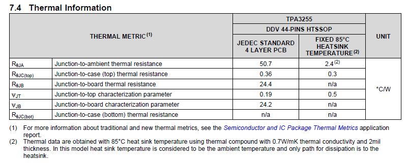

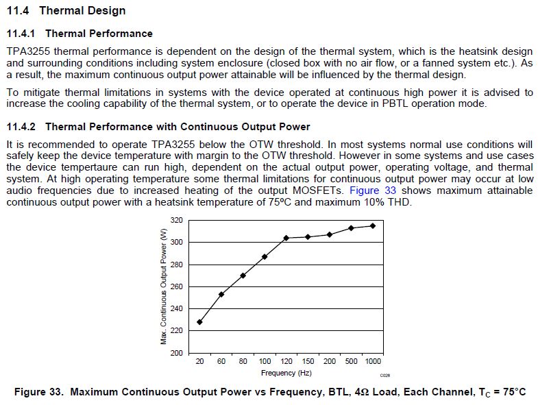

If one can hold their finger on the heat sink for a couple of seconds, without burning their finger, it is probably fine (<60C). TI planned for excessive heat.
One can calculate the thermal resistance of the current heat sink and the TPA3255 device power dissipation & one can decide if it is adequate.
Have you calculated the expected dissipation at 38V? I would think it´s easily >2W and the heatsink ist not that big (although bigger than some).My 3e running with 38v have 46 degrees celcius measured in center of heat sink playing at low volume with open case.
