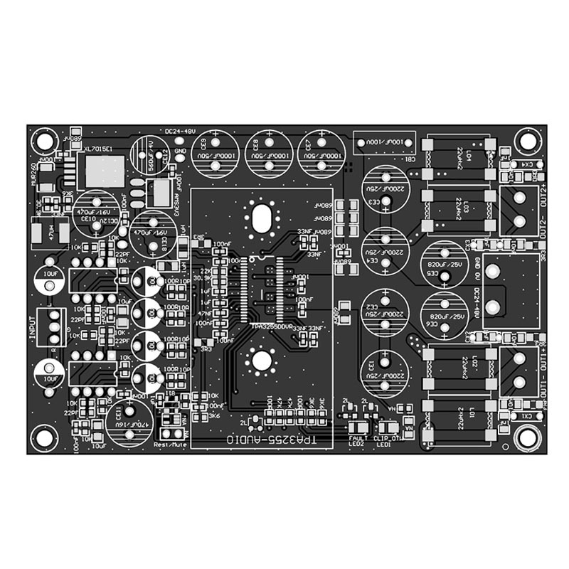

I ordered the "improved" version. I have a question about this amp: is the PCB's label correct on the filter inductor side? 22 uH? Isn't too much?
o_O

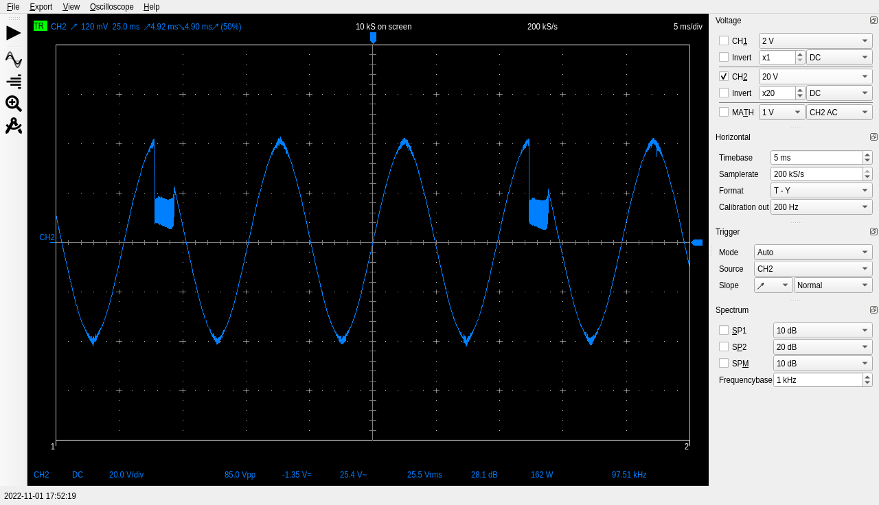

I have one of the original Shui Yuan modules and when tested at higher frequencies (ex: 1 kHz) everything works pretty much as per the spec sheet. I can see about 225 W @ 4 ohm or 125 W @ 8 ohm. But at low frequencies of, for example, 100 Hz., the module goes into a latched fault (requires a manual reset) with 4 ohm loads at as little as 165 W output. At power levels just below the fault threshold there is some sporadic oscillation near peak power:
I checked the supply voltage, and while it drops a few volts, perhaps from 48 V to 46 V as load increases, it doesn't seem to be doing anything crazy.
I confirmed OC_ADJ is 22k ohm, so per the datasheet, a latched fault with no CLIP_OTW indicates either UVP or OLP (CB3C>1.7ms) since the temperature is also low. The PVDD is well above the UVP threshold so unless something wonky is happening with GVDD it doesn't seem like an UVP issue. That leaves OCP, but I'm not sure how the FET current could be over 17A for an extended period given the peak output current at 43 V and 4 ohms is just over 10 A.
Since this is going to drive a 4 ohm subwoofer I really don't want to have to hard reset the amp whenever things get a bit loud. Has anyone else seen something like this or have any ideas where to start looking for the source of the problem?
