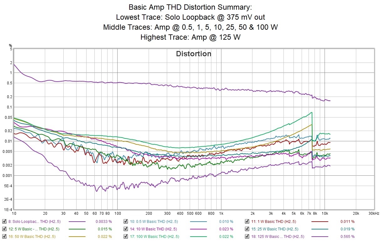

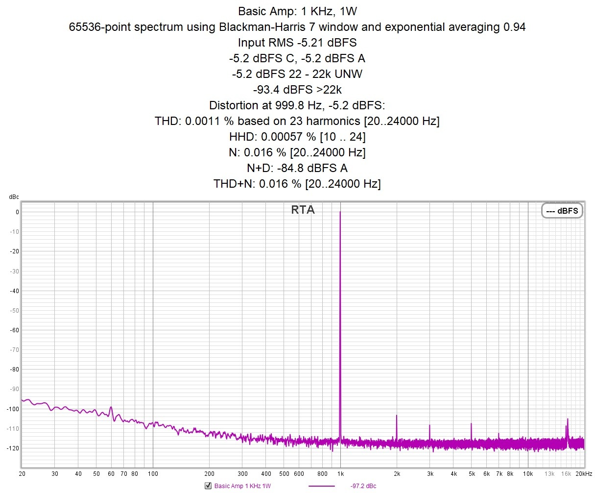

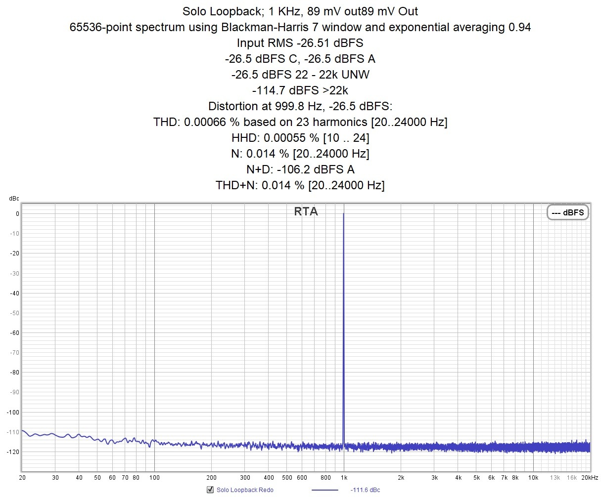

Here are a few measurements I made of the Shui Yuan TPA3255 amplifier. Three amp versions were available when I ordered the amp from AliExpress in September 2021: basic, middle and deluxe. This is the basic version with NE5532P op amps and standard (not Nichicon) capacitors. Currently only the basic and deluxe versions are available (LINK).
My measurement setup consists of an old Dell workstation laptop running on battery, a 3rd gen Focusrite Solo USB audio interface powered by the laptop and a set of 4 Ohm Arcol 50 W power resistors mounted on a heatsink. I also have a symmetrical voltage divider that is adjustable in 6 dB steps and connects between the amp’s output and the Solo’s input. The divider lets me test at different power levels without changing the Solo’s input gain.
I used a Mean Well LRS-350-36 power supply. This amp can support higher voltages and generate more power, but I plan on using a 36 V supply. According to the TI datasheet the TPA 3255 should be able to output 125W @ 1% THD into 4 ohms with 36V. All tests were both channels driven into 4 ohm loads.
I first measured both channels @ 1 KHz to determine the amp’s gain and inter-channel offset. The gain was 27.4 dB and the two channels differed only by 5 mV. The first attachment shows the Solo’s loopback performance with a 1 KHz input @ 89 mV output. The output value was chosen as it generates 1W when applied to the amp. The second attachment shows the amp’s 1W response. The last attachment is a summary of the amp’s THD at various power levels.

Thank you! This is excellent information and definitely adds to seeing what is happening with the amplifier.

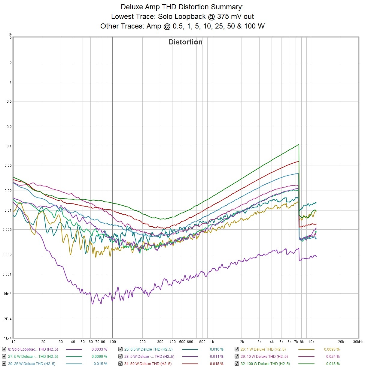

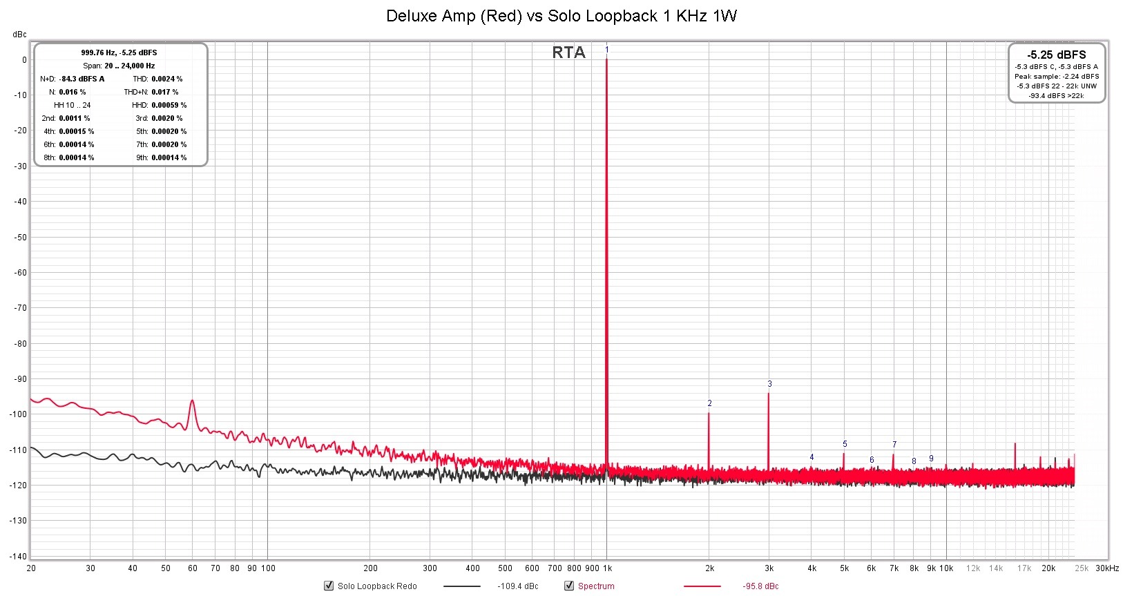

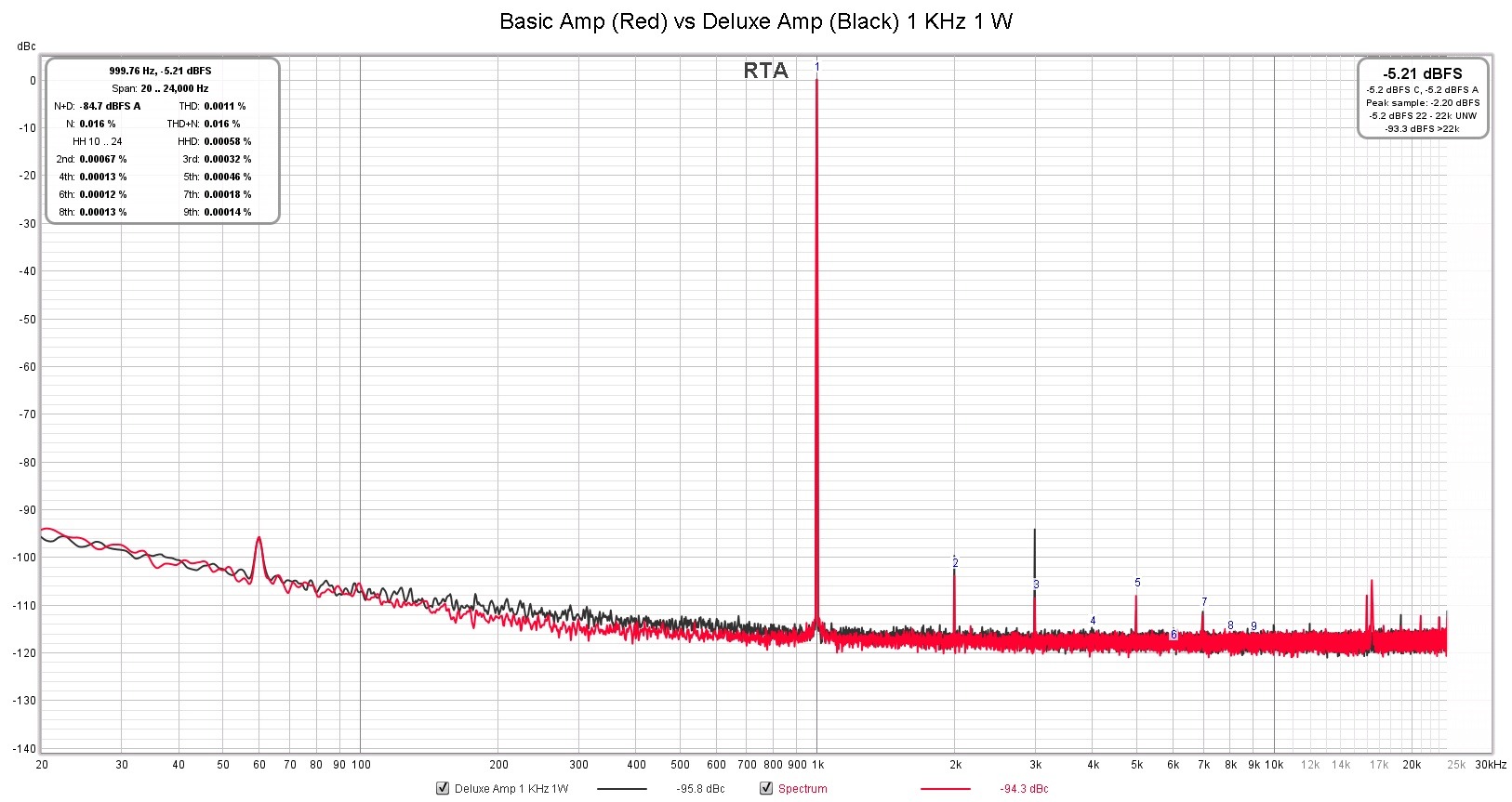

Here are a few more Shui Yuan amp measurements. These are for the “deluxe” version of the amp that’s available from AliExpress (LINK). Here are the amp differences as listed on the web page:
“Basic version: use NE5532P op amp+3200uF/63v capacitor
Deluxe version: use LME49720NA operational amplifier + nichicon FW 2200uF/63v fever audio electrolytic capacitor + WM capacitor”
I used the same measurement setup and power supply as in my previous post (#442). I first measured both channels @ 1 KHz to determine the amp’s gain and inter-channel offset. The gain was 27.5 dB and the two channels differed by 10 mV.
The first attachment shows the amp’s 1W response compared to the Solo’s loopback response (see my previous post for the Solo’s loopback response alone). The second attachment compares the 1W response for the basic and deluxe versions. The unexpected result is the deluxe version shows higher levels of 3rd harmonic distortion. The third attachment is a THD distortion summary at various power levels (I forgot to test at 125 W as I did for the basic version).
So what’s causing the higher 3rd order harmonic in the deluxe version? At first I doubted my results so I repeated both the basic and deluxe tests several different times. No change in results. Next I thought of the popular “fake Chinese op-amps” scenario. So I ordered some LME49720NA op-amps directly from Mouser and tried those. No change in results. Finally I thought that perhaps the PCB layout and/or components favored the characteristics of the NE5532P op-amps. So I removed the NE5532P op-amps from the basic amp and installed them in the deluxe version. No change in results. At that point I stopped my diagnosis.
The more important question is whether the amps sound different. To be fair, the deluxe version’s 3rd harmonic distortion is still more than 90 dB below the carrier. And some people report that amps with slightly more 3rd harmonic distortion sound more “detailed” and “open”. Unfortunately I haven’t had the time or motivation to perform a blind comparison of the two amps. Other projects have taken priority and my use case for these amps will be as a woofer amp for a three way. In that situation I really don’t think I personally would hear any difference. YMMV.

I've actually seen the opposite regarding third harmonics. The easy way to think of it is even harmonics are less harsh to the ear than odd harmonics, meaning 3d order harmonics actually is much more discordant than second. But, intermodulation distortion is more audible than THD+N. This is because it is not tied to harmonics at all and can shoot through the music which provides cover for harmonic distortion.
But, your numbers confirm what many have discussed regarding op-amps and swapping components, as far as is seen in FFT analyses, do not seem to significantly effect the frequency of the signal. The only other way to test this after seeing the electrical signal is to show it through using a calibrated microphone and showing that the speaker's reproduction is not changed from the change (which arguably is a useless endeavor because if you are not effecting the signal in the audible range with the amplifier through these changes, then any audibility of a change not seen in the signal is a bit dubious).

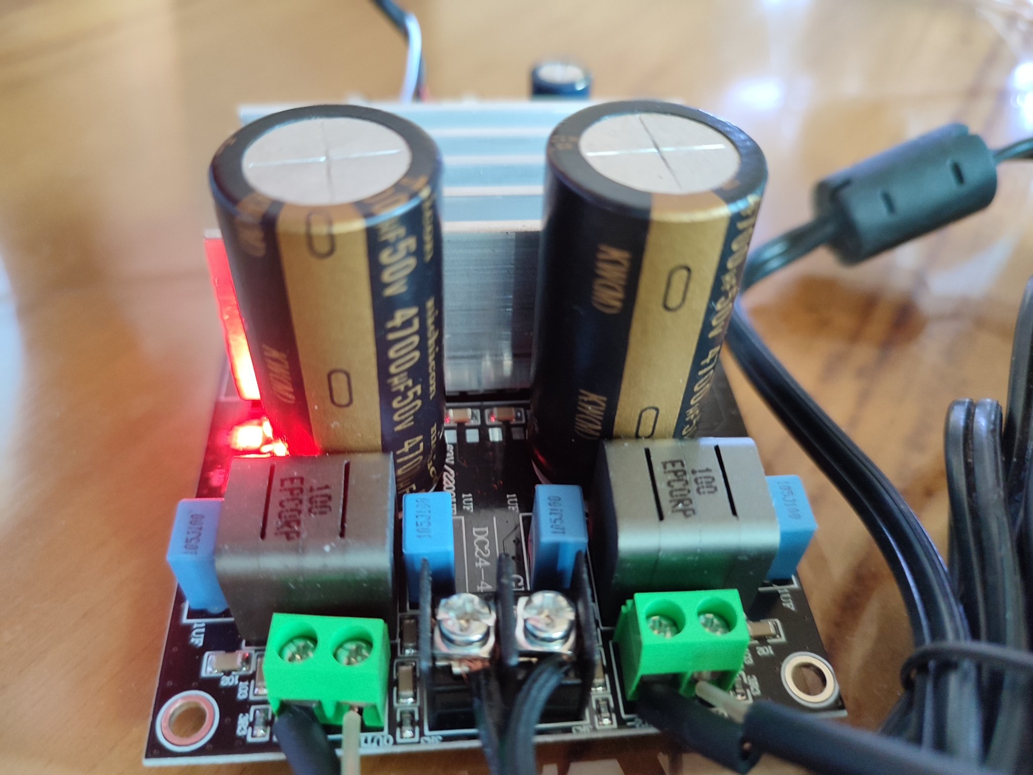

I try to change reservoir capacitor with Nichicon KW 4700uF 50v, the dimension fit with space available. I can't hear the difference. but when power supply switched off, the amplifier still playing music at least 5seconds.maybe need some time to warm up the capacitor

4700uf????? Why????
The output capacitors value is supposed to be 2200uf, for what reason you increased it so much???
You should be glad nothing damaged from such a huge increase
@bankroll1972: Why so aggressive? We're dealing with safe low voltage here. As long as the polarity of the caps was observed, there shouldn't be any damage whatsoever. I mean in PSUs, 200% capacity should never do any harm whenever basic rules of electrical engineering are kept.
I didn't mean to come across as aggressive, but I get nervous seeing stuff like that posted online because someone who wanders here from Google and doesn't know what they are doing might see a picture like that, and make an incorrect assumption about the safety of changing capacitance values, I know it's not like these devices have mains power anywhere but still I worry.
My apologies if I over -reacted.
