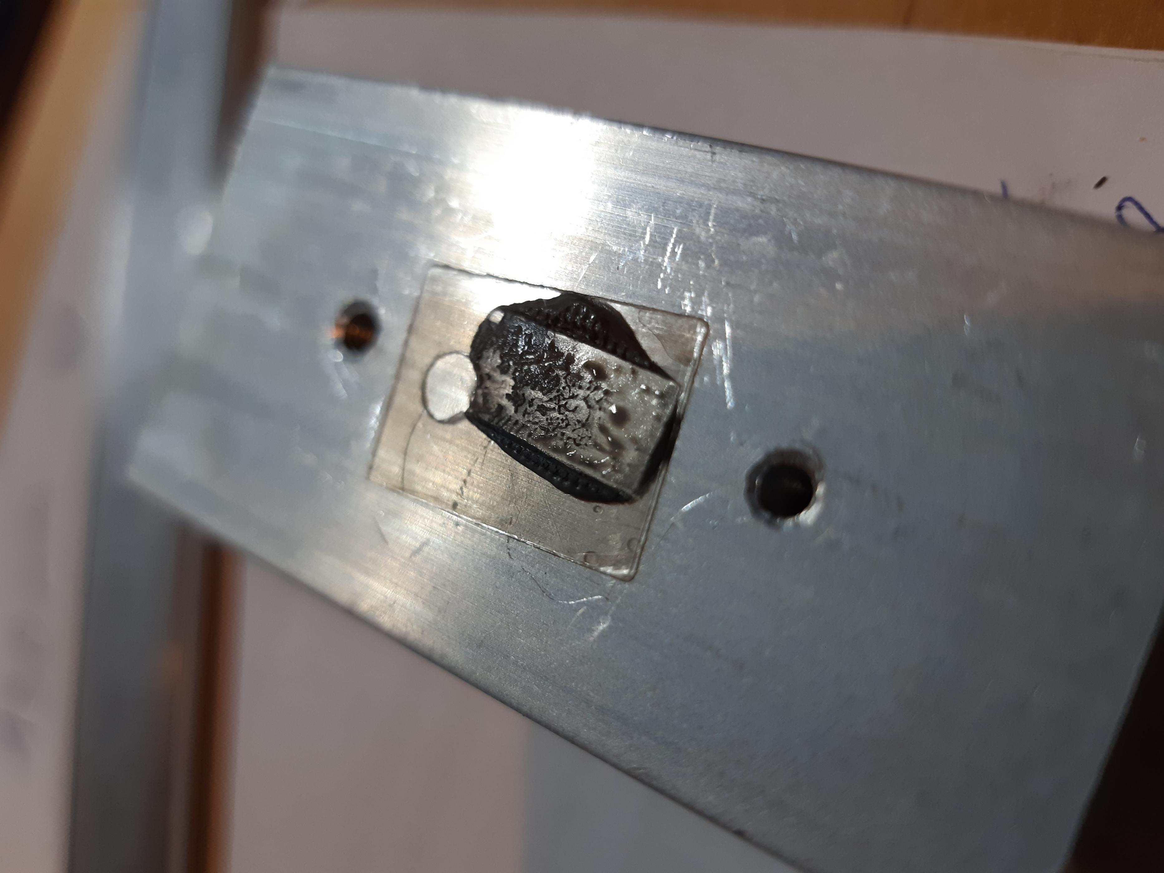

To get the boards mounted vertically sideways what I do is get an aluminum cut-off from some place making aluminum windows/doors then cut that to size with an angle-cutter /stainless steel disc which is only 1mm in thickness , then machine it with file and drill to the exact size and lenght I need , base 40 mm , vertical plane 75 mm and lenght 120 is what I do. Then mount the board with spacers to allow for the electrolytic caps which go between the board and the aluminium-angle .
But of course one could simply use two angles only . The advantage of my solution is sturdyness and easy mounting of the caps which can be glued onto the aluminium so be totally inmobilized with respect to the PCB but without touching that.
I'm sorry it's taken me so long to reply to this, but it sounds very elegant! Do you have a picture by any chance? 🙂
Not right now and to make pictures I will have to build two more as I have sold them and they are mounted inside speaker-boxes as well . Give me a week or two and I will see what I can do
