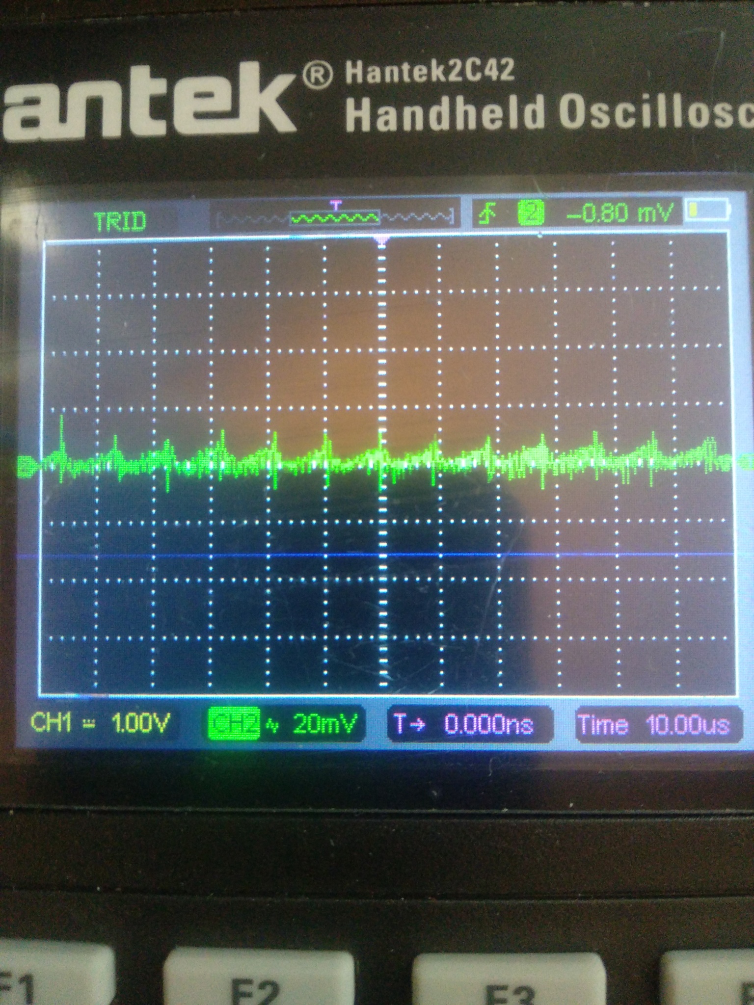

Did somebody solved idle noise? I have 3 modules, all are the same, more noisy than an AV receiver. Noise can be heard from the mid-range and tweeter 1m away, regardless if there is input connected or completely disconnected. I tried LM4562NA, but it did not have any effect. PSU Meanwell RSP-320-48, mostly set to 37-38V, but voltage also does not matter.
shortcircuit the input pins . These modules are quite silent so if inputs shorted the noise might come from the PSU

Ferrits in the signal path cannot help. It is noisy even without signal cables at all.
I have just tried shortcircuiting the input pins, no difference. I tried moving PSU 2m away, no change.

I looked for a solution and if you also think about using modules for active speakers (and even more active bookshelf speakers) then decreasing midrange and tweeter sensitivity is probably necessary i.e. L-Pad is the way (DSP + ClassD ~ Hypex Alternative?)Did somebody solved idle noise?
I tried modules initially with old Aiwa speakers and was happy. Problem is with sensitive drivers (I have here RS52AN), it is too noisy.
XORCZ , your speakers are of normal sensitivity , mine are 3dB more sensitive and I have no hiss in them , only silence , unless I stick my ear into the tweeter that is !!! , and using the ShuiYuan with LM4562 for the time being , so check on the PSU . moving it away does´t help if you have high frequency ripple on the rail. Check with an oscilloscope if that might be the case. Class D amps switch to rails and if the rail is modulated with a high frequency ripple that can get through to the speakers because succesive switching impulses are then referred to a fluctuating rail voltage .
Check the output of your amp as well , using an oscilloscope. Besides you said you have the problem with three boards so that is an indication the problem is elsewhere too.

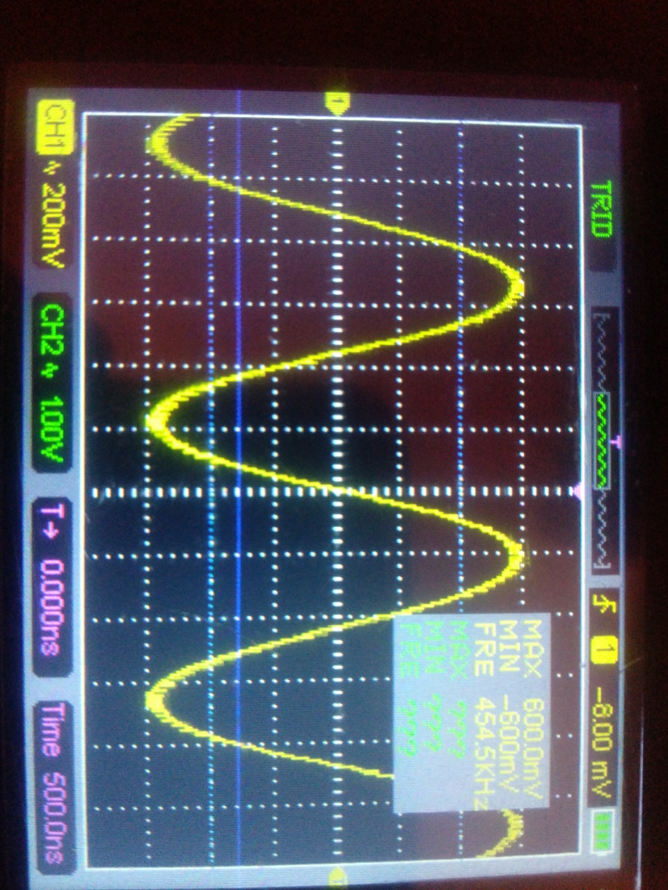

MalleMike thanks, what you say is logic. I tried again, I can hear the hiss more from the tweeter (AMT2-4) than midrange. I connected the osciloscope to PSU output and pressed AUTO several times. I guess it is ok, because it is in mV range?

Looks allright to me , yes . What about the output of the ShuiYuan ? Set the scope to as high as possible sensitivity but without passing the screen-limits and the time-base for 5 KHz.
Is the hiss aconstant one , does it have any "quality" to it , sound similar to something else ? Fluctuate at all ? You have very good tweeters there which likely go way up into ultrasonics
Another point : Class D amps react to the speakers impedance . Try to connect a 4 ohm resistor in series with the tweeters see what happens The impedance of "normal" tweeters rises with frequency , the one of yours does not !! If so you might want to compensate in the filters of your speakers , or adapt the output filters of the ShuiYuan to match your speakers

My intention was to do all filtering in the CamillaDSP. Normally I have these speakers connected to Pioneer VSX-924 and there is no noise. Just in case I touch the tweeter with my ear directly. Vs Shui Yuan I hear noise at 1m.
The only filter on the tweeter is 33uF protection cap. I do not have skills to modify modules. I put modules in the box, soldered connectors, modified PSU to noiseless 12cm fan (can recommend ARCTIC P12 Silent 120mm, starts always and no noise at all).
Measurement at idle, no input, the same with and without speaker connected. I do not think there is something wrong, I am just too close to speakers.
