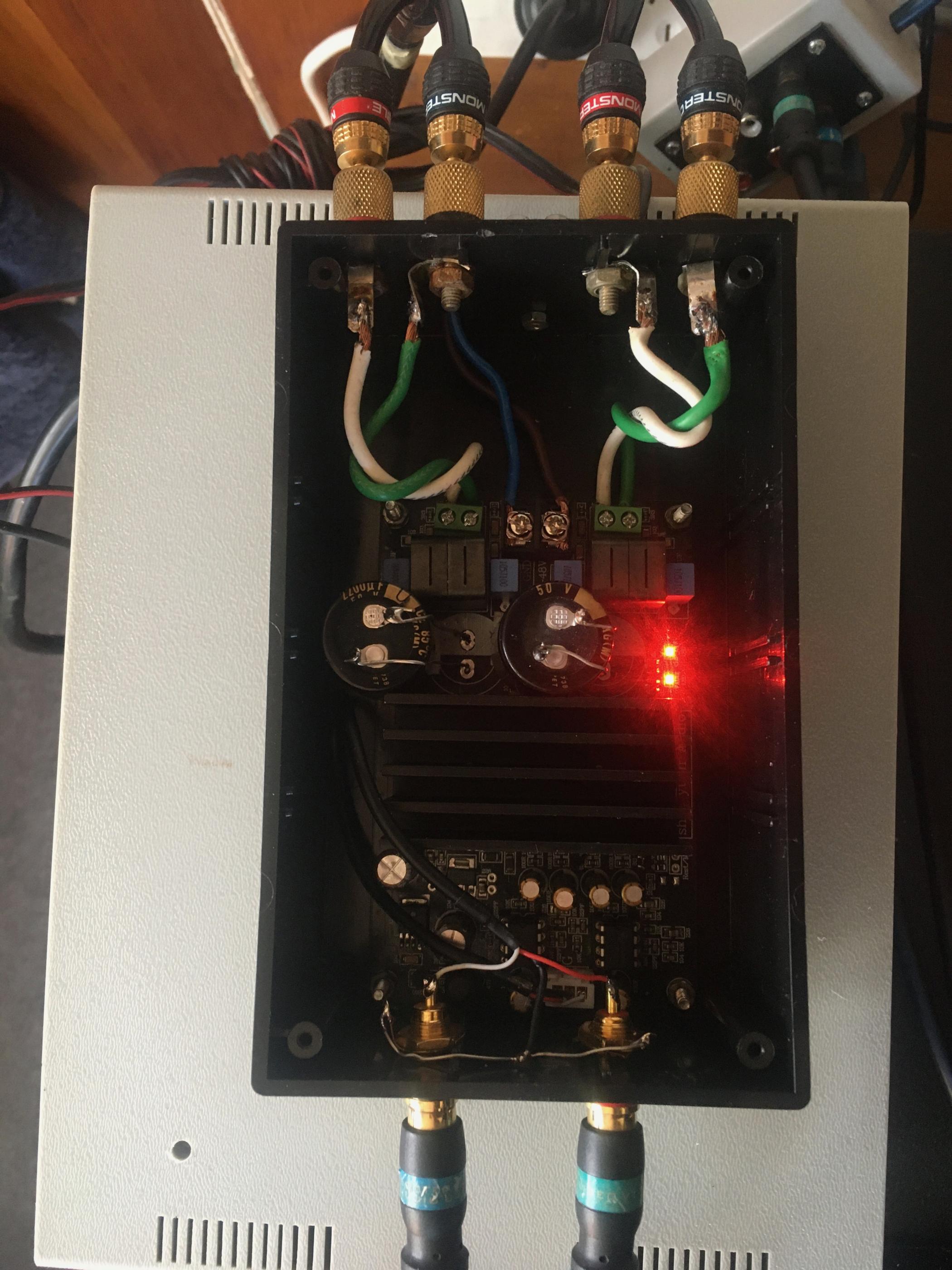

Concerning the board itself instead of removing the existing capacitors I have raised the board and added two elecrolytics of 3300uf , two of 4,7uf and two ceramics of 0,1uf., with the two big ones lying flat against the board and held inmobile with a bit of silicone .Overall sound and bass improved a lot . Using the original NE as the other op amps have not yet arrived.
Of course this implies a larger ( higher ) casing which in my case is not a problem.
So you put them in parallel with the existing ones by soldering them under the board? Good idea.
thats the idea , by raising the board with the addons below it I have no constraints regarding size and lenght , and the cap-leads to the board give me the space where to add the small ones as close to the board as possible , for spacers I use 4 screws 3mm each with three nuts ..............

I have ordered my board - standard. I will fit some super through caps as I have a pair spare.

I believe I found possible evidence of cheating on the Shui Yuan boards which I just received.
They are equipped with two "Nichicon 2200uf at 63v"capacitors . Their size is 18mm diameter by 30mm height. so:
I have searched Google and any Nichicon capacitor I can find with 2200uf/63v/18mm diameter is 35mm in height so it appears that Nichicon does not make those with only 30mm no matter what series . The search included Nichicon´s own website for good measure ! I will ask Nichicon if they make or made any caps with the above measurements but only 300mm height.
So my assumption : if Nichicon does not make them then Shui Yuan cannot put them on anything they make .
Since the boards sound fine and the price is very low and if you want to use them above 35 volts my recommendation would be to change all electrolytic caps on them for peace of mind and use the ones you take out for other lesser purposes . I will change them anyways . It will set you back by about 10 euros per board for capacitors , plus whatever you decide to spend on op-amps which I will replace with LM4562 as well , see what happens............

I have mine running on the bare minimum voltage of just over 26VDC. Its making more than enough output for my little Rega speakers that Im currently running.
Wow. It sounds epic. A tiny bit slurred at the top end. But I replaced the "Nichicons" with some nice (real) Nichicon Super Through caps that unfortunately needed a bit of tweaking to fit onto the PCB.
Im just running the standard op-amps and they sound very nice. I could upgrade to some OPAXXX's at a later stage, but quite liking the sound ATM. Very open and airy, while still being detailed. Its sounding very good with my new Topping E30 DAC.
Its the old cliche - I am actually hearing some stuff in recordings that I havent heard through any of my other (far more expensive - dammit!) amplifiers......Listening to London Grammar's "If You Wait" album and its very revealing.
It really is epic! I'm quite pleasantly surprised, even though I've followed these threads for a while now. I note your mod to fit the caps and may resort to fitting mine upside down too. I planned to dremel small openings in the last heatsink fin to accommodate the bigger diameter but trying to work out if I can slightly enlarge the through hole without breaking any vias etc. Looks like two sets of holes close together in my board, and yours too?
