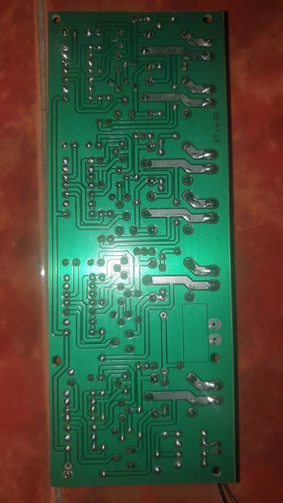

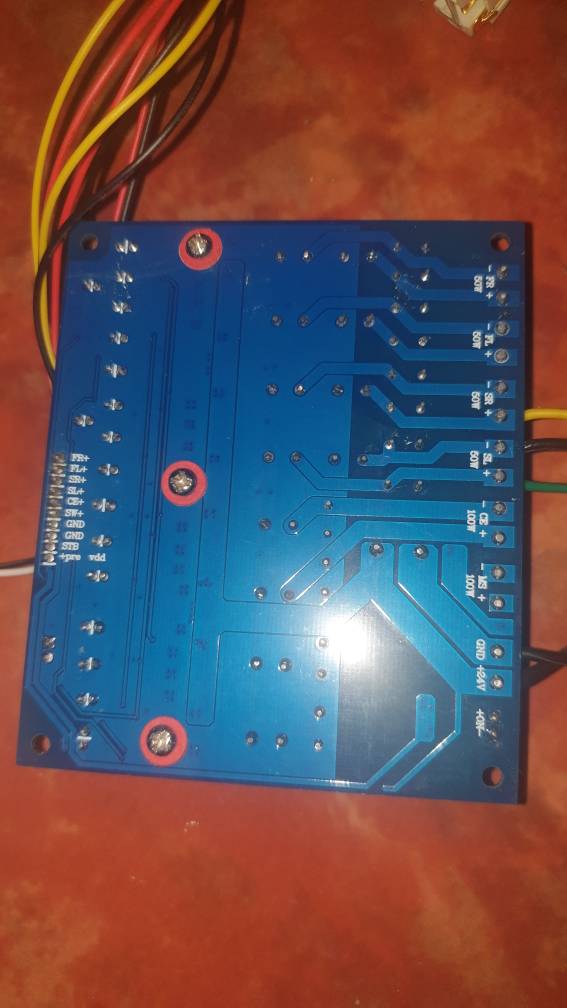

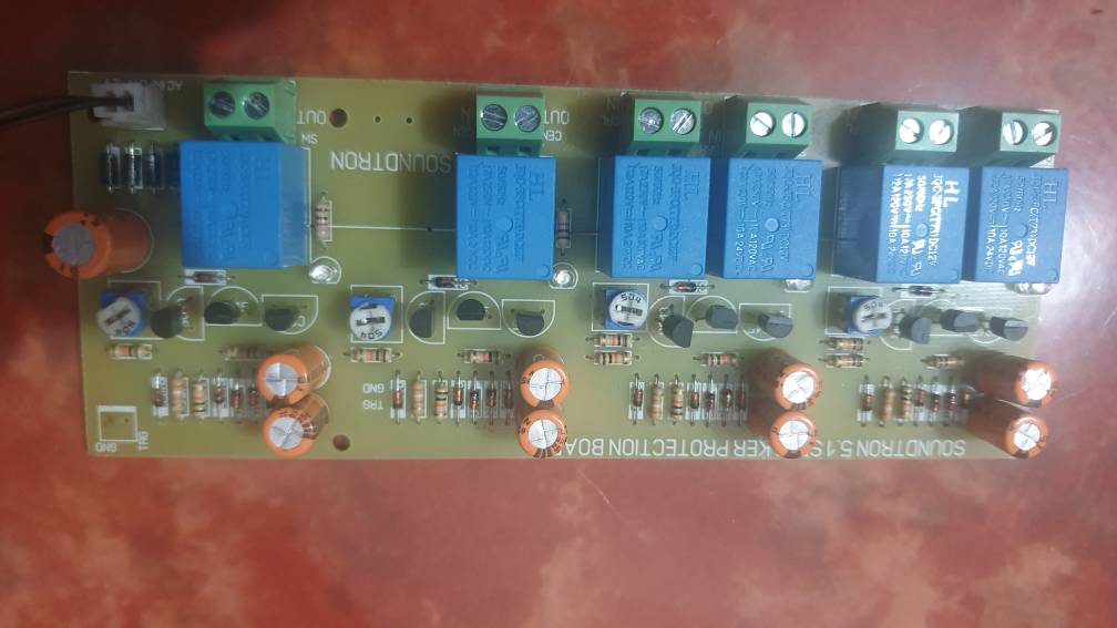

Hello,
This is my first post in DIY audio.
I have ordered TPA3255 and waiting for delivery from China.
I have a speaker protection boards and I am not sure how I can connect it to the AMP.
Input and output is marked properly in the speaker protection board but ground is not marked. Right now I am testing the speaker protection board with a 5.1 TPA3116 board which crates a big pop sound when I switch on the amp.

TPA3255 and TPA3116 have their own speaker protection features.
Adding another module will only add more complexity. Not to mention your audio signal passing though a relay

I am using this 6 channel amp and speaker protuction board as a stopgap measure till I review my TPA3255 amp. The speaker protuction board was faulty so I replaced it. I can hear a very loud pop when I switch on the TPA3116 amp and that is why I am using the speaker protection board. In my case I am using each chanel for 1 driver and crossover is done using Dayton DSP 408. Speaker protection is a must for this amp as my tweetes are connected directly to the amp.
Would you suggest using a slow start module instead of speaker protection to avoid the pop sound. I am using MEANWELL LSR 350-24 smps.

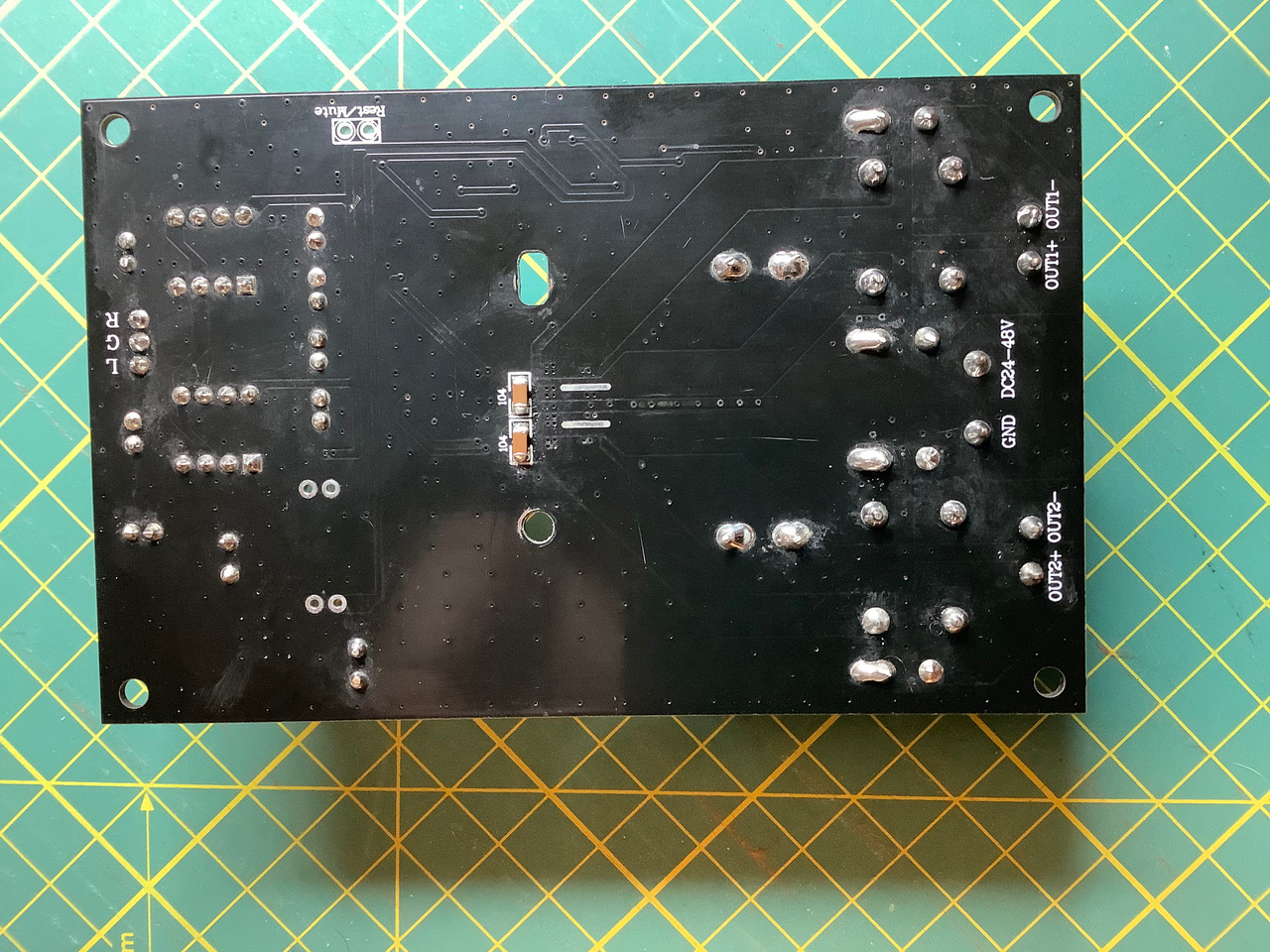

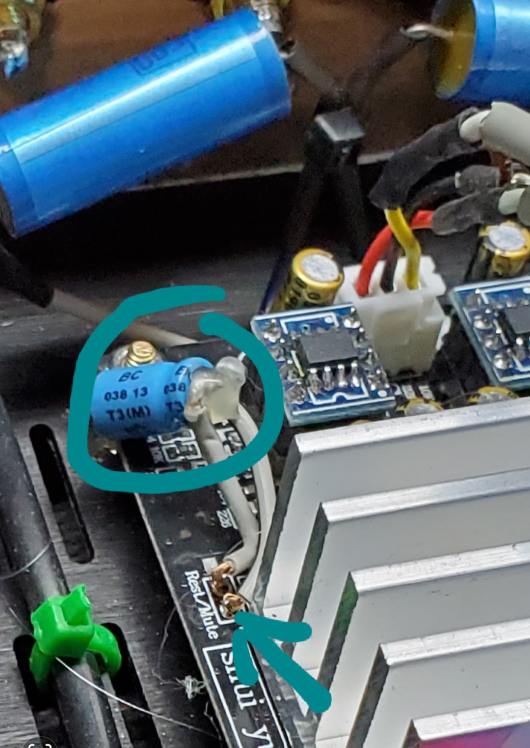

Does someone have the schematics of the used single ended audio input to balanced TPA3255 input? Is it possible to increase the gain of that circuit to increase the input voltage to the amplifier IC? I measured the amplitude of the NE5532's outputs and could see ~3V maximum in amplitude. If I did the math correctly I need 2.91V RMS input to the TPA3255 to get 150W output at 8 ohms (21.5dB Vout/Vin). This results in an amplitude of 4.12V. So my input signal is too low to come near the 150W rated output power.

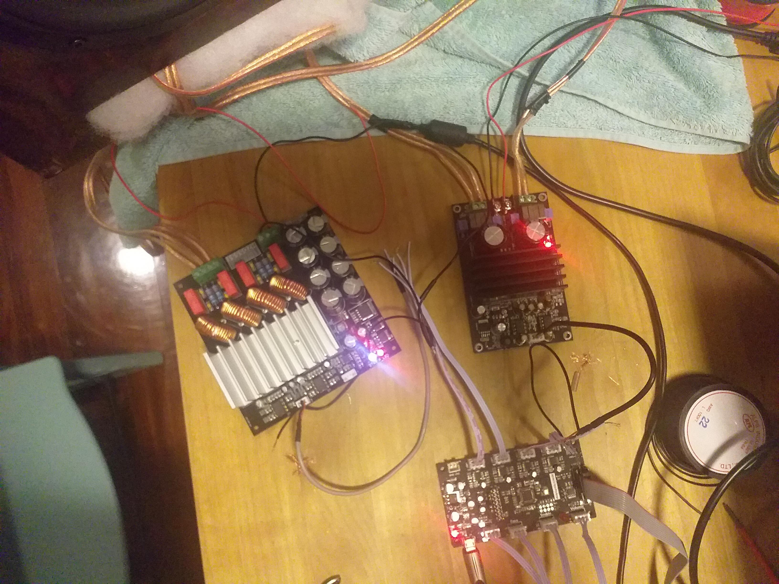

Here is a picture of both:
Btw. how much capacitance is it safely worth adding to the filter caps of the Shui Yuan, 2x 5600 uF ?

Hi Photobugs ( and others..)
The class D chips from T.I. have a complete set of protections for the amp and the speakers built into the very chip.
So if you have any popping sounds when switching on or off the first thing you have to do is make sure where that is comimg from.
Ground the inputs of the amp and see if there is pops or not. If not then your pops are fed to the amps by something that comes before them .
Normally these class D amps have a pop protection built in so if the board is well designed there should not be any pops .

Here the Shui Yuan board is sold with two opamp options including the classic NE5532P and LME49720NA which I don't know what changes it brings to the sound.

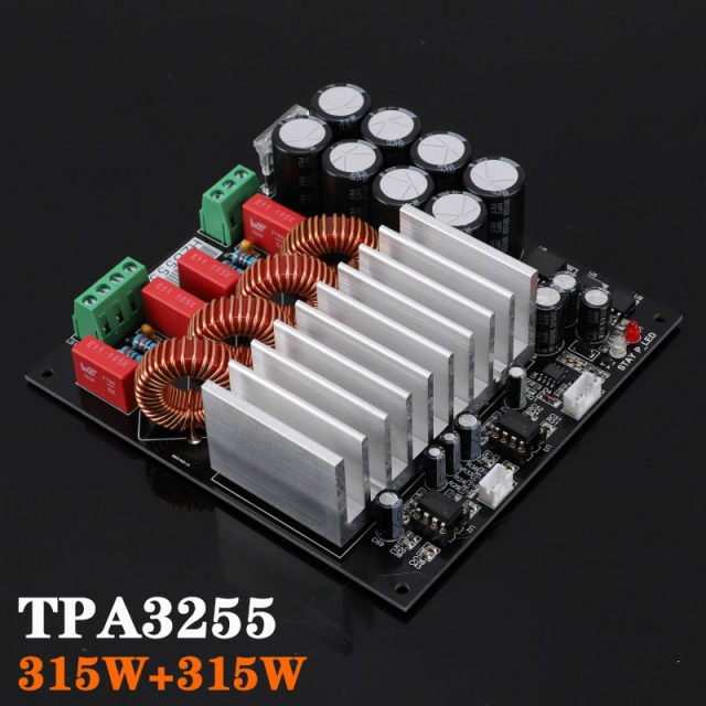

Just got my new TPA3255 by HanZao.
This module is pretty unknown so I wanted to test it )
Out of the Box the module comes with the below components :
- 8000uf Rubycon YXF serie Low ESR / 50V
- Buffer caps, Rubycon YXF serie as well
- FIlm caps (MKP) Wurth
- SE Input (using Micro JST connector 2.0)
- DIP 8 OP Amps 5532 (updated with OPA1656)
Need to make a listening test before comparing vs others...
But sounds good at the moment. No Pop sound ON / OFF.
The module is really well protected : Yesterday I was tired and I mounted the power supply in the wrong way and the same for the OP amps... The module has automatically put itself in protection mode.
The Micro JST 2.0 connector is not practical for the SE input but I connected it with a JST 2.54 which is more conventional.
