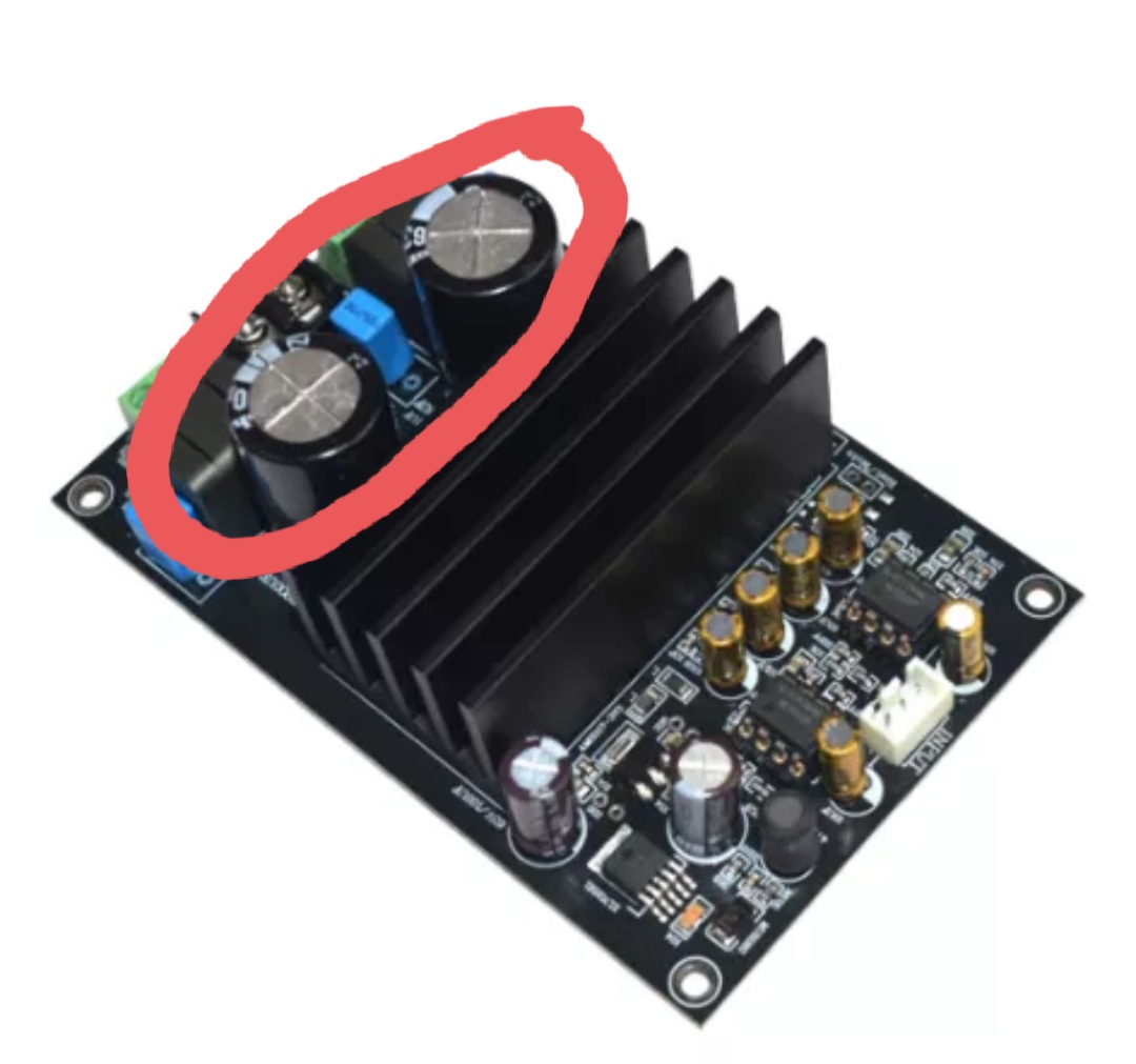

Where did you buy the OPA1692 ? Because I heard a notable difference between the NE5532 and the 1692, with the Hanzao module it is the most obvious. I bought mine @ mouser (they are genuine).
Changing the 2 capacitors brings great improvement.
Then you will hear more improvement of the 1692
Which ones?
Which ones?
The two big ones, the current tanks. In my case I put 50vdc 4700uf, because I use a 36vdc SMPS, this is powerful enough for my speakers which have good efficiency and listening level. I had to change to Nichicon, but I got 50vdc CDEs, they are larger than the available space. So you have to pay attention to the maximum diameter of available space.
The fake NE5532Ps (with funny colored metal legs) I threw in the trash. On average quality speakers (those in my workshop), I did not hear any difference with the OPAs that I have.
On the other hand on my main speakers which are extremely detailed, the 3225 fake has a soundstage which lacks depth, the dynamics are somewhat truncated and the level of detail is lower.
But I recommend changing the 2 large condos first if you can.
