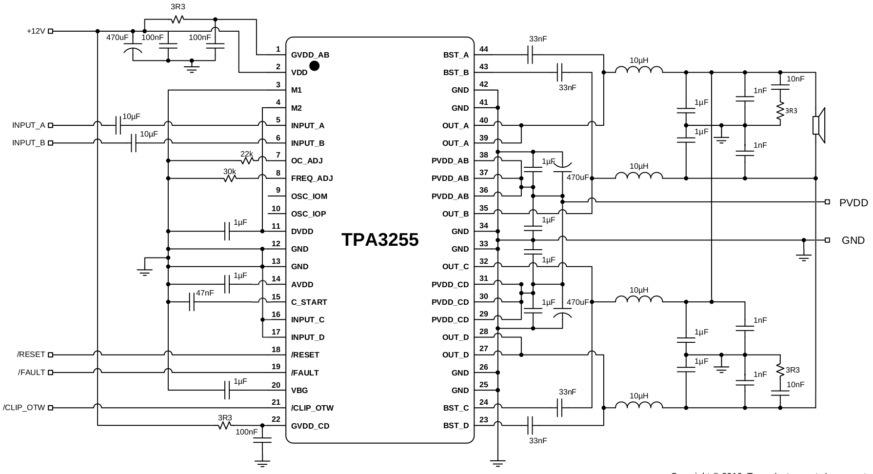

Taking modding of the Shui Yuan aka Joepie China board to a new level. I needed a PBTL TPA3255 board to replace my blown STA517B amp. Unfortunately I only found this stereo BTL board. Alternatives were prohibitingly more expensive. I already had decided on the schematic:
so I only needed the board's schematic. As I did not find it I hand drew it:

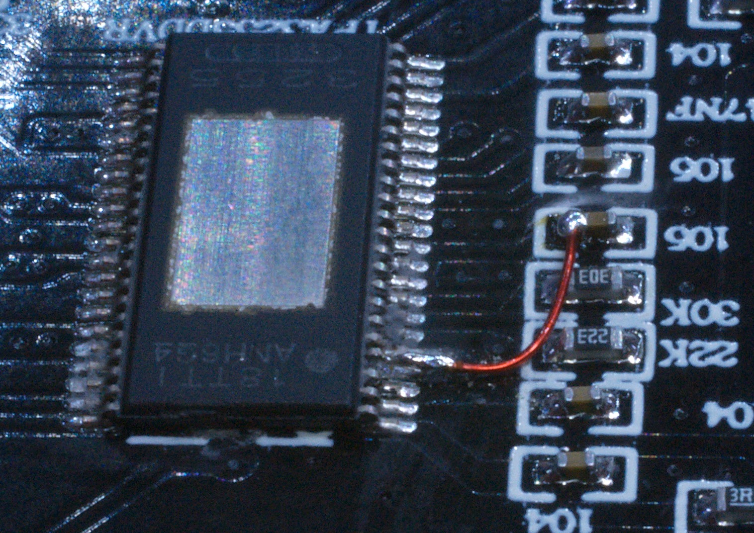

Because this amp is used in a special configuration and driven from the balanced output of my subwoofer filter amp I could remove both ICs at the input. I also placed the TPA into PBTL mode by lifting pin #4 (M2) and attaching it to +3 V (DVDD):
This was a horrible mod... The wire is only 0.2 mm thick but I got it done at the first attempt. Put some tape over it to prevent it shorting out to the heatsink.

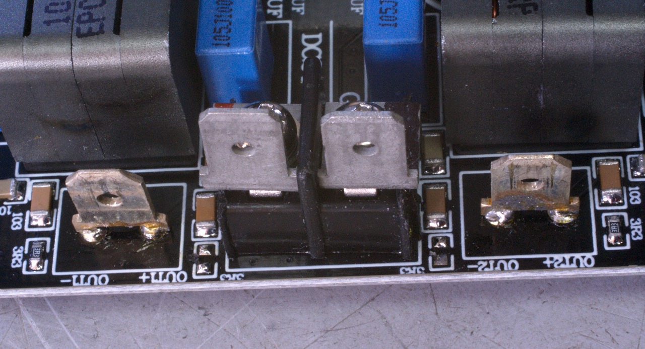

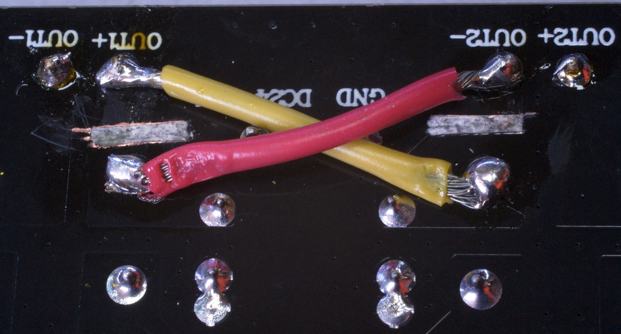

The outputs must be paralleled. The "official" way is to do that at the chip's outputs but as the leads are way too tiny to do that reliably so I opted to do that after the inductors:
The terminal blocks were replaced by AMP 1/4" spades because the speaker already used them:

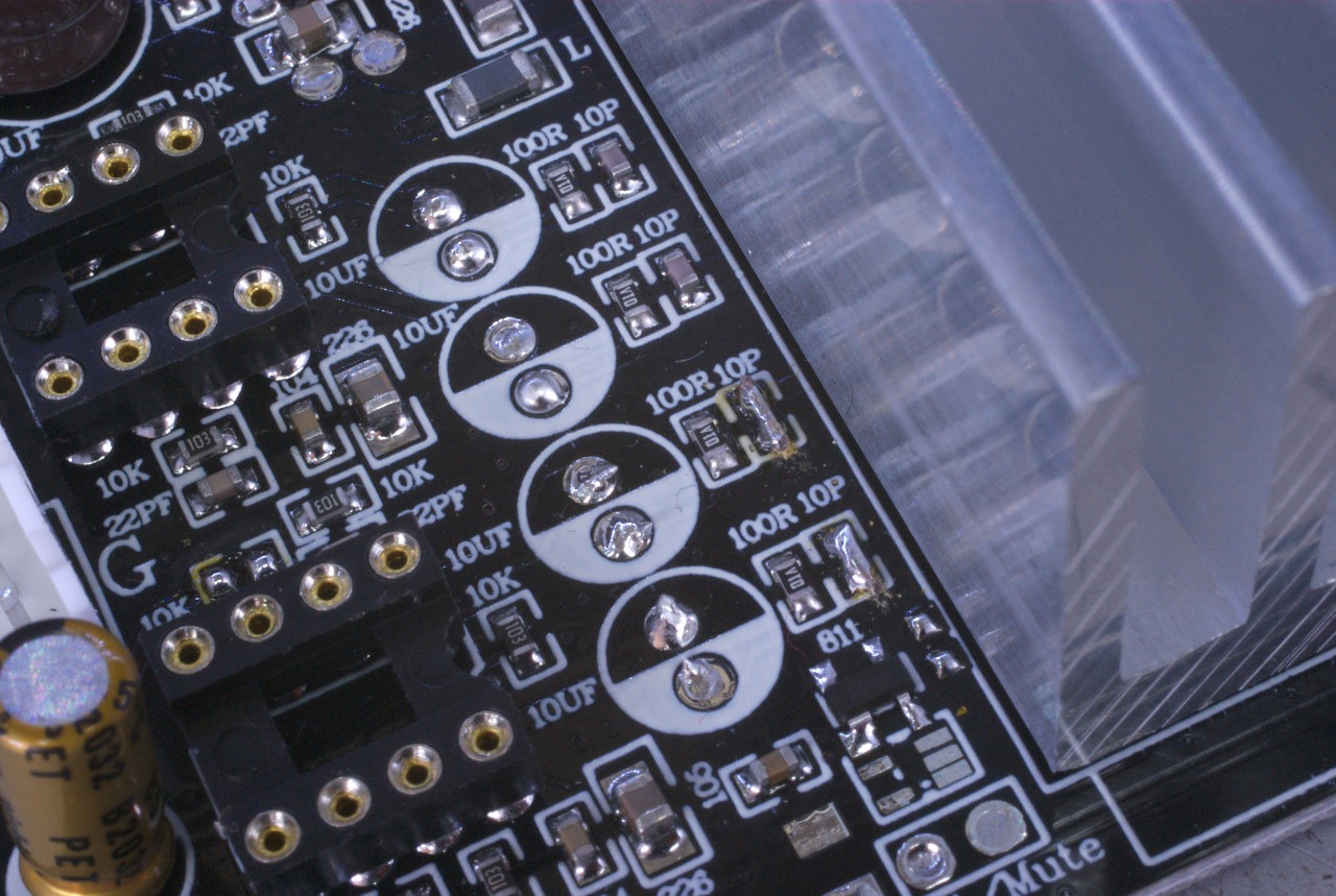

So, except for a handheld oscilloscope reading, I've seen practically no measurements. Is there a reason people do not measure? In any case, I have a version similar to the Shui Yuan but they have cheap ceramic caps under the TPA3255 that broke off on 3 of the 4 boards. Good riddance. I'll just replace them all. These boards call for 1uF called for (105 instead of the smaller values seen on the Shui Yuan). So, until I get those ordered and in, I won't be able to test those.
I also have 4x3E audio ones as well. I also bought a Rigol MSO, so in the next couple weeks or month (depending on work and time outside in the garage building my boxes) I should have some test data to actually show the FFTs over the frequency. Still a noob, just a noob with equipment to tell what I am seeing/hearing.
I'm using 1 cheap and 1 3E in each speaker, in a 3-way configuration. Two channels will be driven by the 3E, 1 channel driven by the cheaper amp module. I'm also replacing the heatsink with a 3"x2"x1" block of aluminum that will be attached to an aluminum plate, with an aluminum heatsink measuring 2.5" fin depth 10.08"x5". By my calculations, that should be able to keep the TPA3255 well under the 125C Tjunc temp (possibly as low as 60C, but there are losses because of the heat soak to the aluminum block mass, etc.).
Everyone here is primarily focused on the components forgetting that heat effects drastically the performance of components. You can meet spec, which arguably these heatsinks do, or you can do something that will allow you to be well under spec. Even heat on caps can drastically change their performance in the audible frequencies, which is why some datasheets include the information on heat relative to frequency.

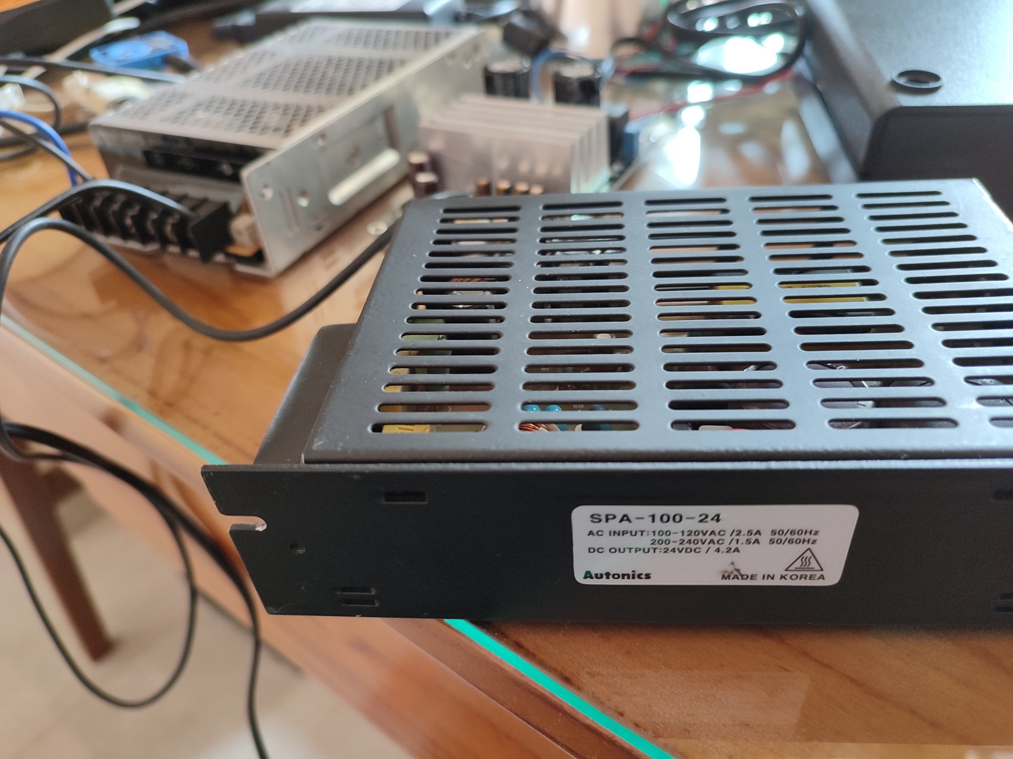

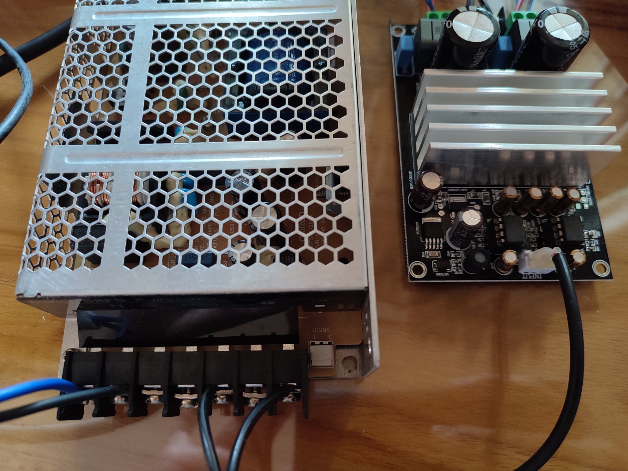

I just received Shui Yuan TPA3255. It's cost around $29 including the shipping cost and tax to Indonesia
I tried to power up the amplifier with SMPS power supply : Omron S8FS-C10024 (24v 4.5A) and after 1 hour then I try to switch with Autonics SPA-100-24(24v 4.2A).
I'm not sure why the fault LED and clip LED always light on. Is it normal?
With Omron, I set the voltage from 22.5 up to 28.5v and I can hear the difference when the voltage changed. Higher voltage will give wider soundstage. then I try to switch the power supply with Autonics, and I can hear the difference with Omron. The lower sound, the bass is little bit punchy with Autonics.. maybe the Autonics output has less noise? I don't have any tools to measure the ripple so I'm not sure why Autonics sound better.
After listening 2-3 hour, I can say this 'raw' unmodified version sounds better than some Chinese TPA3116 board I ever heard. I also have myRefC amp (class AB) with boutique components, FH9 (class AB) , FX8 amp (class A) and this TPA3255 amp sound so good in my ear.

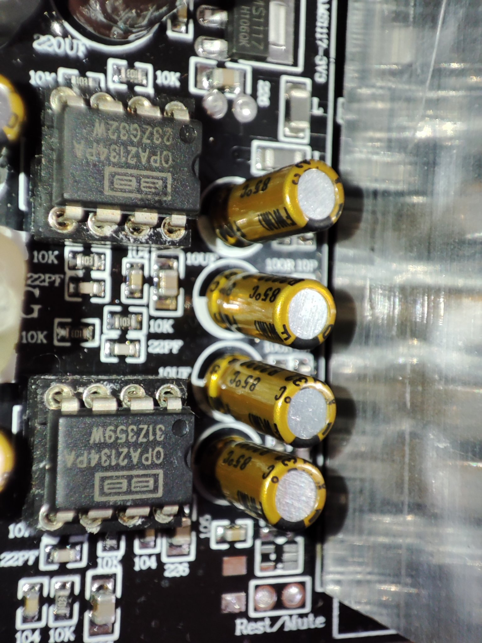

I have OPA2134 to test. after rolling the op amp, this amplifier sound more pleasant, more 'musical' to my ears
