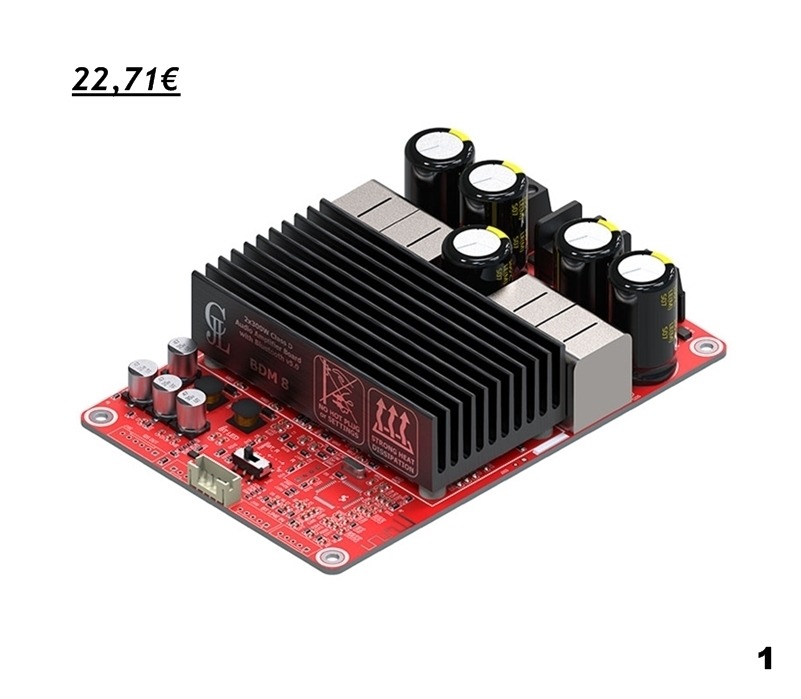

after much reading, thinking it over, deceiding, discarding the decision, reading again, etc. I'm about to join your game. First is to get an appropriate gaming device. I was into the classical design which is seen at the beginning of this thread, but the newer version seems to have some real improvements, so I am about to order two of these > 2023 improved TPA3255 . Or should I stay with the classical layout like this one > TPA3255 classic ?

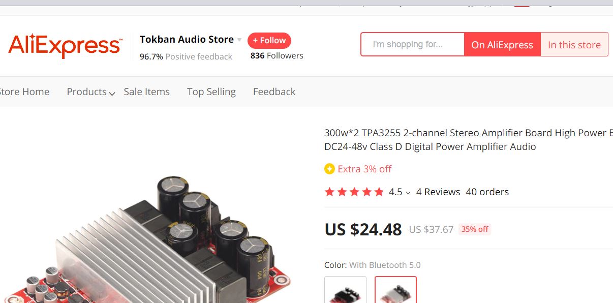

Have a look at this in BT5 version 24.5$ with 0.002%THD+N

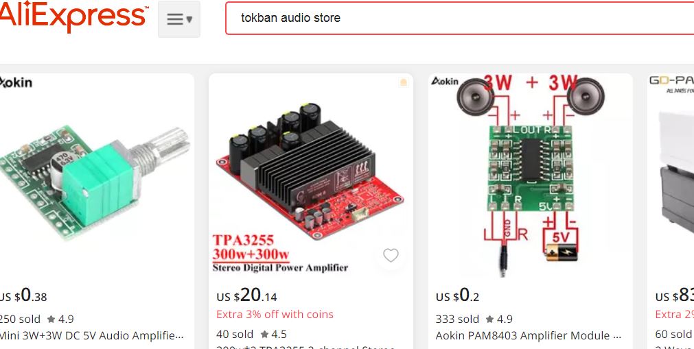

On tokban audio store page 2 you have it.

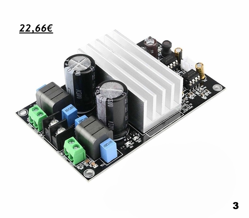

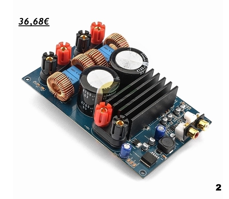

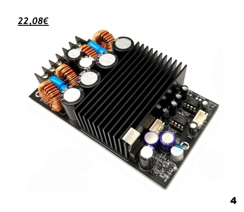

Ok, I took a closer look at these four now. The only one which is advertised with the 2023 model of the chip is #4. As far as I remember, I've read about this improved version of the TPA3255 in this thread, so it should be real and not just chinese marketing. For this reason #4 is still my favorite. Number 2 I find a little to expensive. Something that should change my mind?
H
HAYK
On TI site, I don't see any improved 3255 version, it must be that particular board that has new version. These boards come with two flavors, with PFFB or without. The reference I gave is probably PFFB to have so low THD.

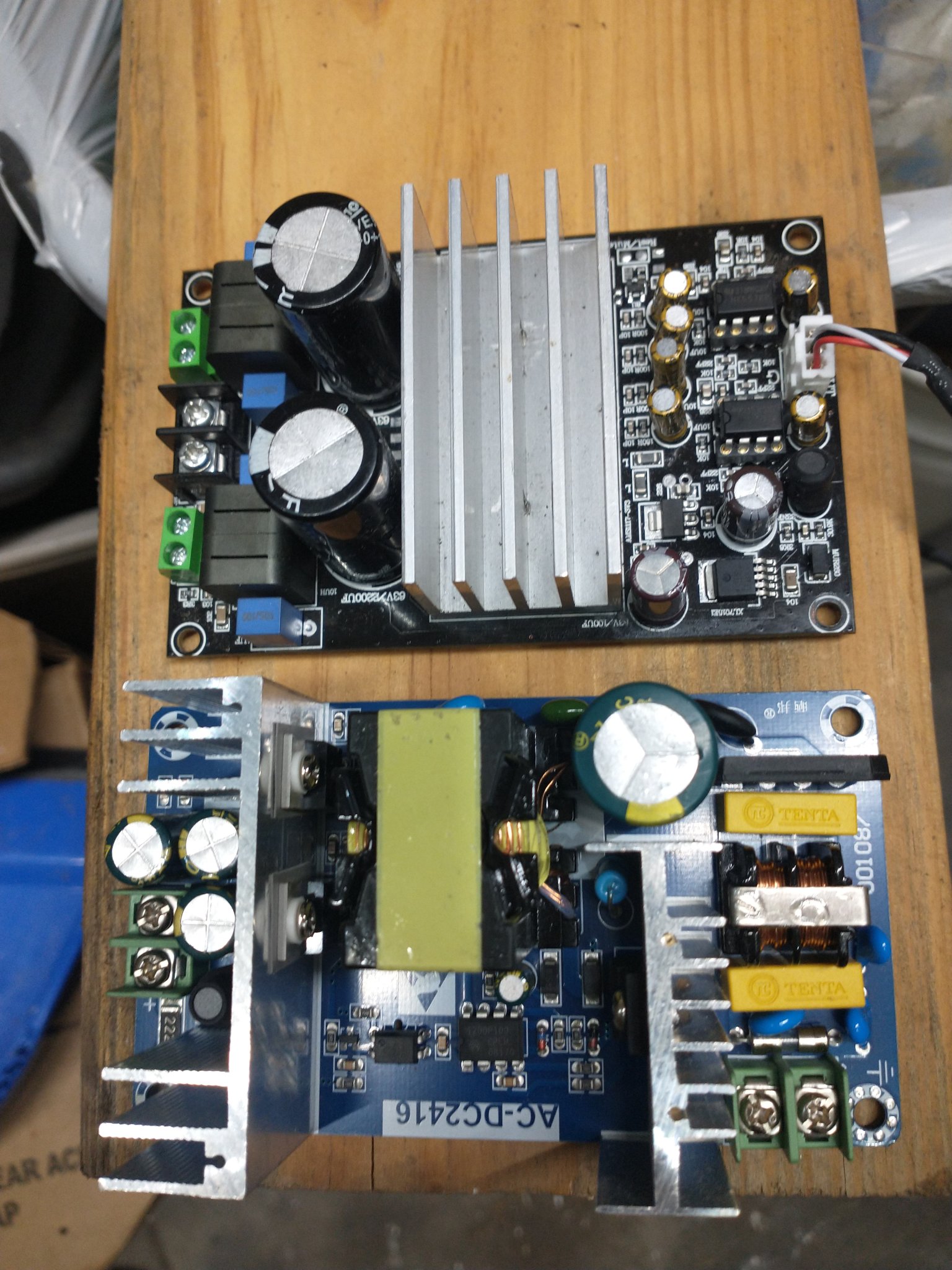

Depends on the power level you want and the sub you are driving. For the price, you can drive around 100w from one channel into 8 ohms and leave the other channel for a spare. Not loud enough? Add another sub to channel two for another 6db. Or go with a dual voice coil sub, use one channel per coil for another 3db.

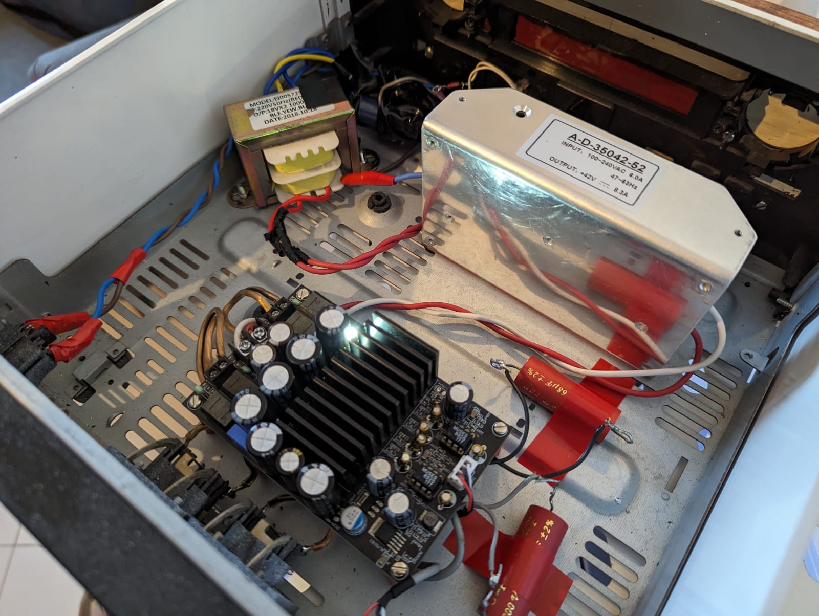

If you use 4 ohm coils instead of 8 ohm, you use lower power supply voltage and more current. My go to rig is these two boards (pic attached). Shui yuan amp board with the gold coupling caps and an alizon 36V5A AC/DC SMPS. Works like a champ and no crazy fans or anything extra required. Deal with volume/tone/mute etcetera in the separate preamp/head unit.
