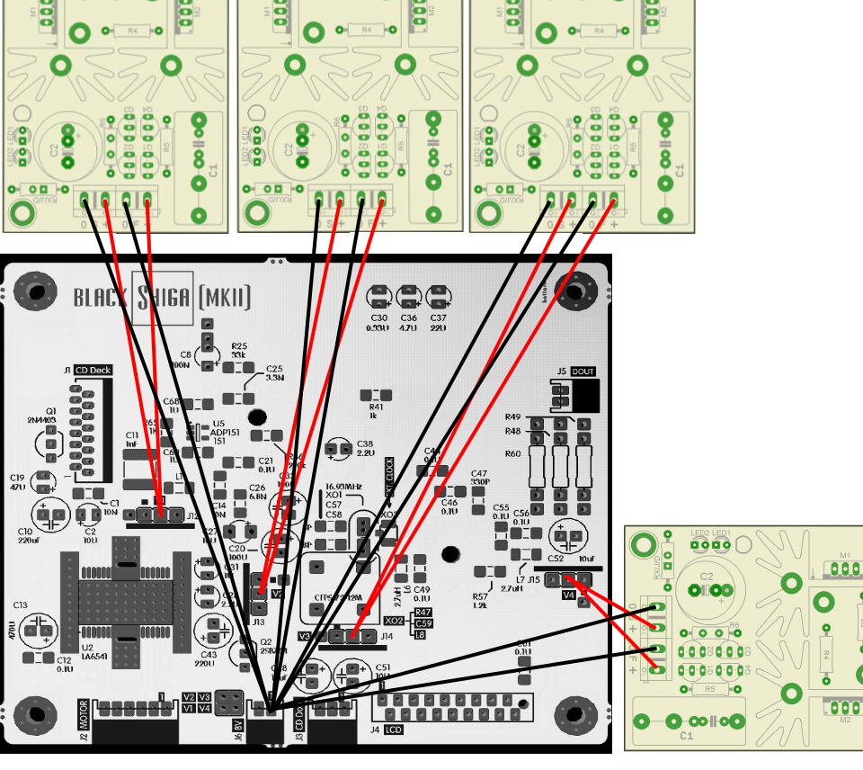

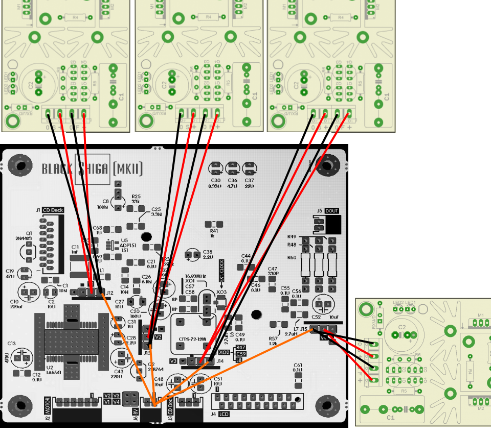

Tibi,
I have a question on how it should be done correct connecting of 4 Salas Reflektor-D to shiga's V1-V2-V3-V4 . As you said regulators gnd have to be tied to J6 gnd . There's two schemes in attach can you just take a look and say witch is better. I think it will be very tricky to connect 8 wires to small gnd pad of J6 ,the way to connect is to solder some wires (marked orange color) from V1-V2-V3-V4 gnd pads to J6 gnd pad under side of board.
Thank you
Thank you
Tibi,
Thank you
Hi Nicolae,
Left picture is the right one.
Do not forget to remove inductors L2 and L4.
Tibi

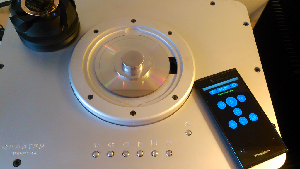

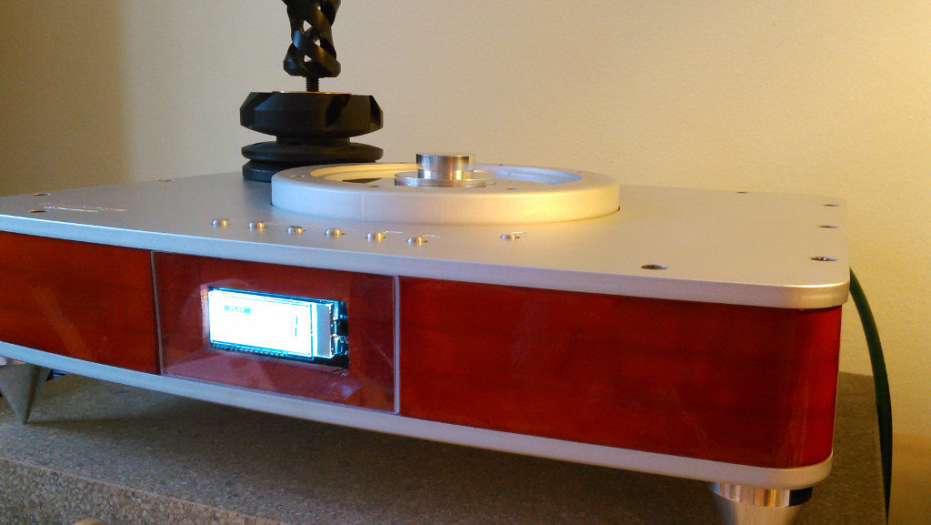

Dou you remember this http://www.diyaudio.com/forums/digi...ii-black-builders-thread-134.html#post4561375 ?
Quantum is here ! 🙂
Tibi
Quantum is here ! 🙂
Tibi
