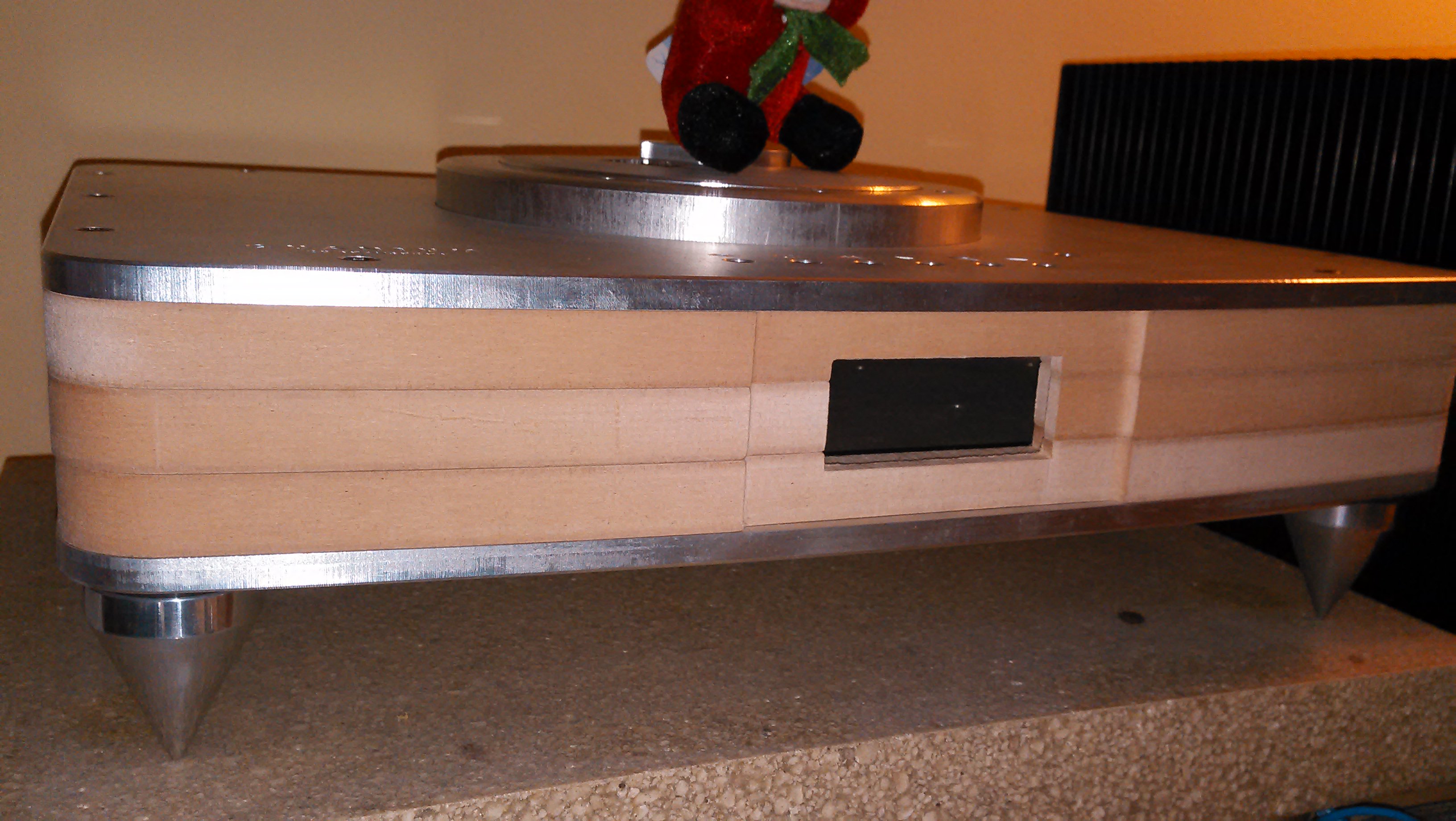

Quantum is a CD transport with anti-resonant enclosure - over 10Kg - aluminium and wood. Inside is a Shiga MKII high-grade Level2 or Level3.
First 20 units will be custom made - unicates - with special engraving.
We just finished second prototype enclosure and we are ready for the third and last one.
In Jan 2016 first unit will be ready and I'll post many pictures and some measurements.

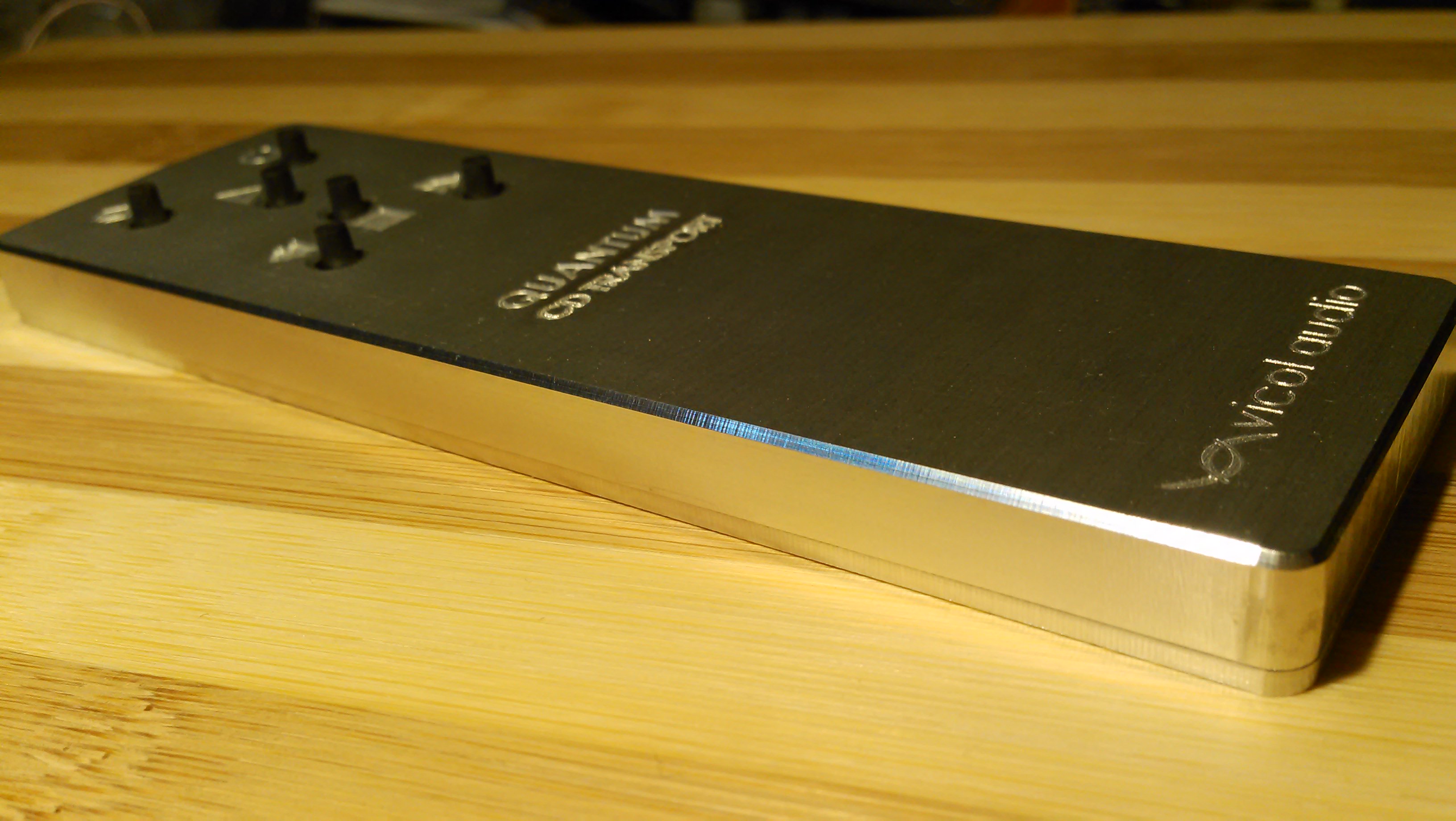

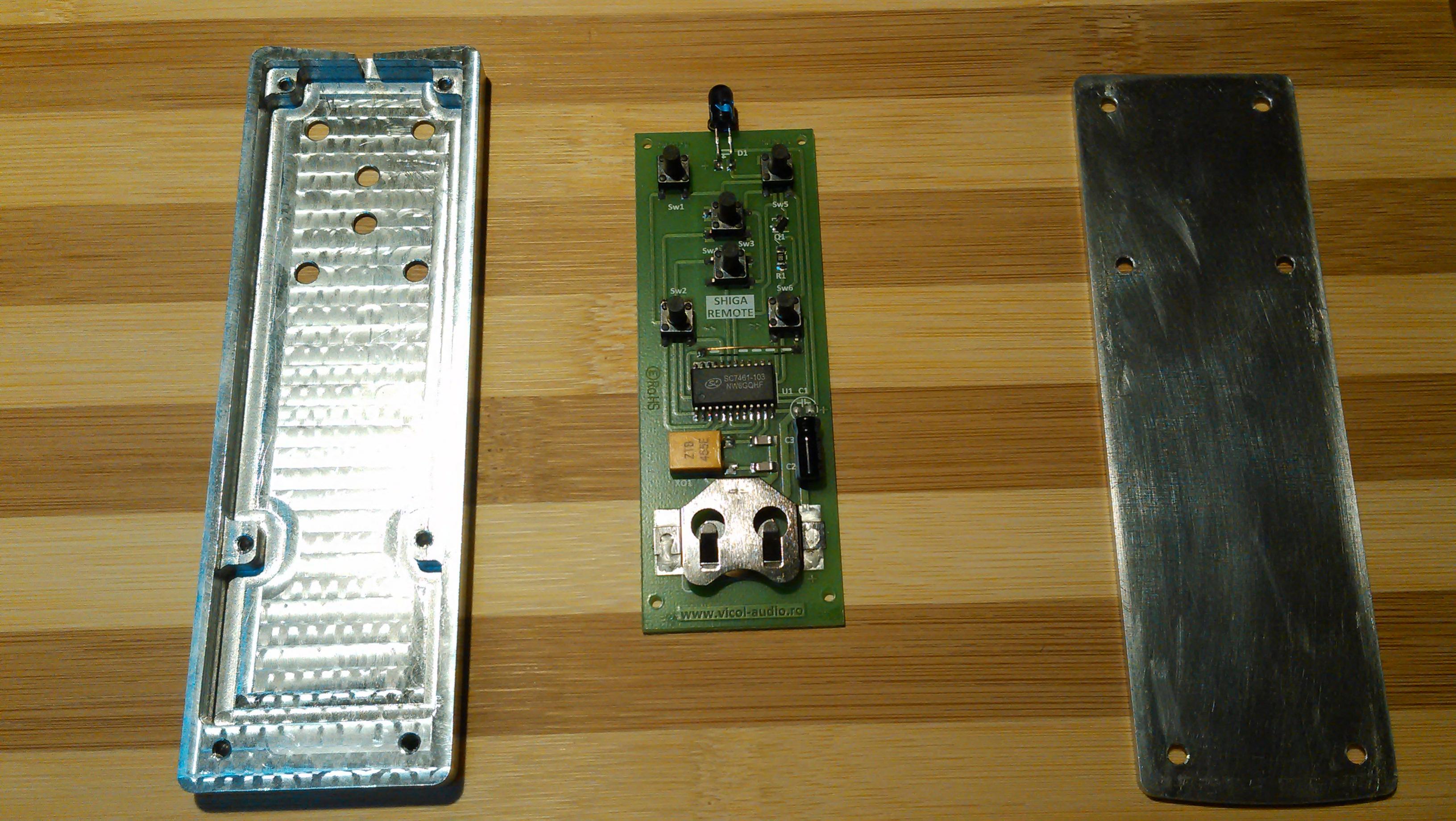

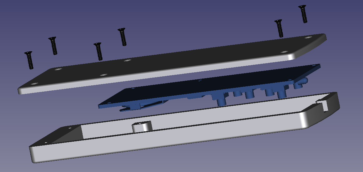

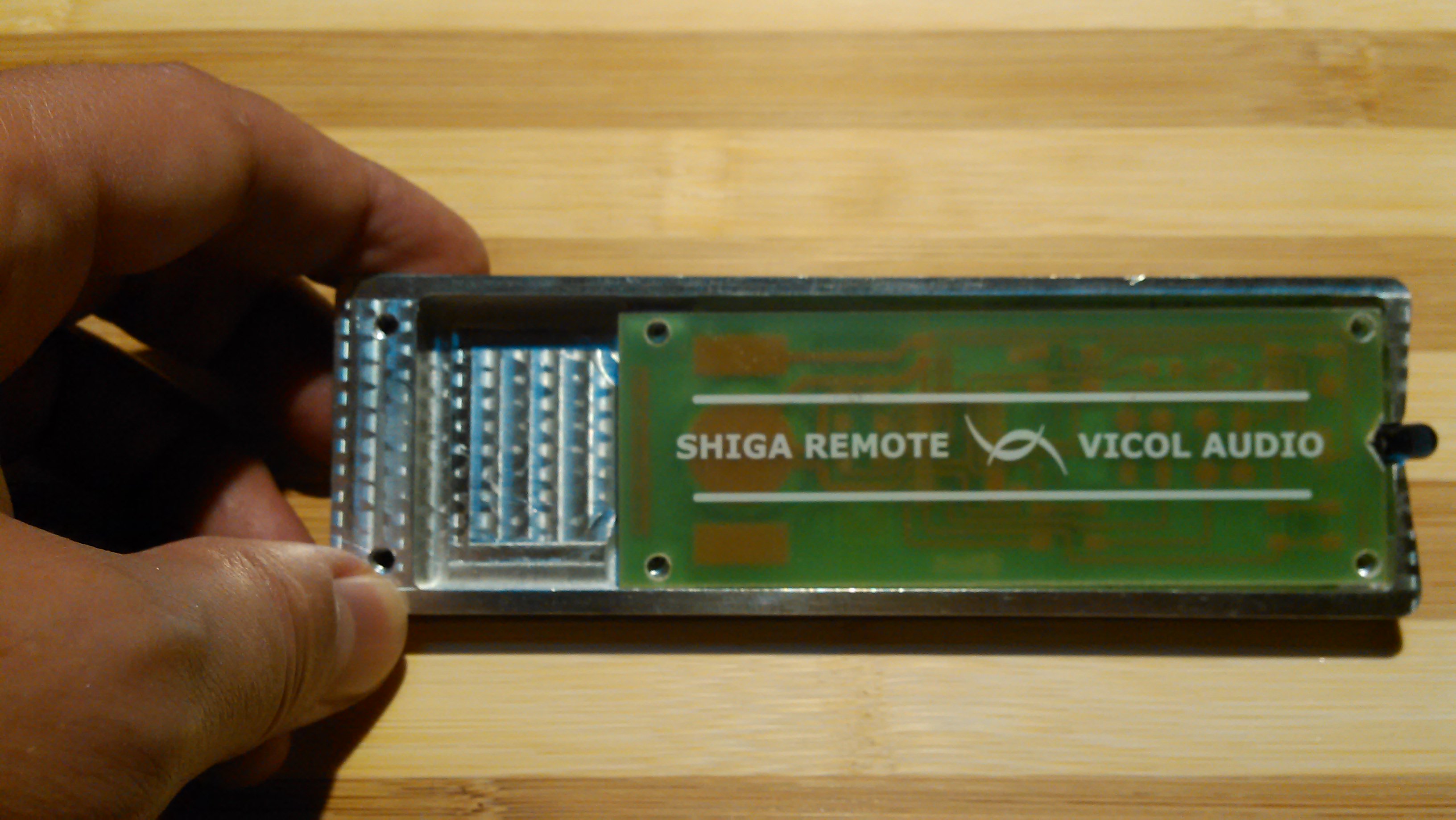

Some files you may need to make your own remote enclosure.
Extract zip file and open source files with FreeCad.
You can 3d print or cnc the enclosure.
Tibi
Tibi
Zip file exceed forum limit. Had to split in two rar files. Delete .zip extension and extract files from rar archive.
Tibi

Thanks Tibi,
I think there are people who also need a metal case for the remote control for Shiga. As I am living in Hong Kong and easily find factory for the metal CNC up to BS standard.
I think it is around 20 US dollars per one not including import tax and shipment.
If there are 20 people needs, then I can organize a group buy for it
Thanks Tibi,
+1 for me.
I have gave information to manufacturer for quotation. Minimum quantity is 10. They will get back to me shall be next week.
Including myself, now there are 5 people interested
