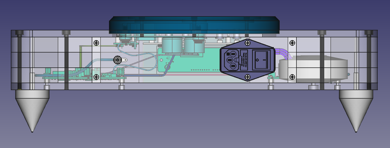

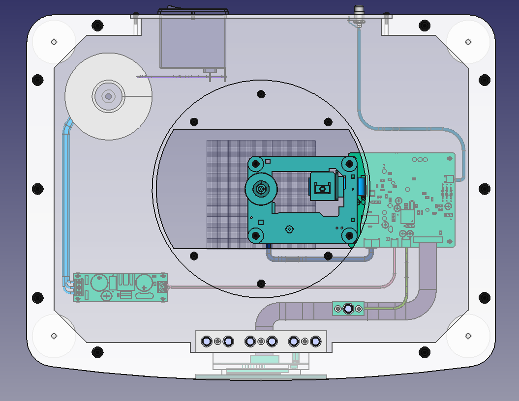

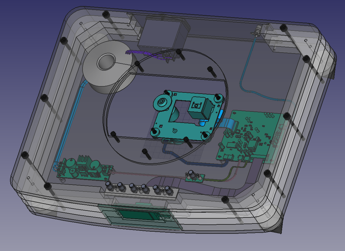

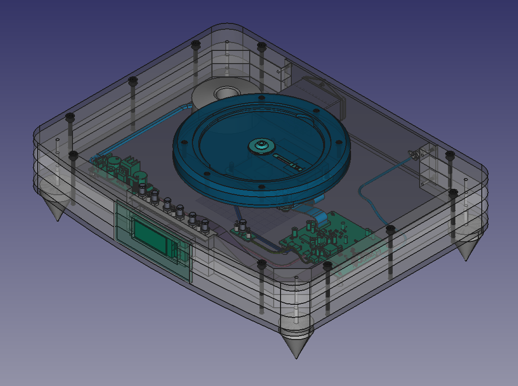

Learning from first prototype. We have now drawings for the second one.
tibi
tibi
Here is a preview rendering of the transport
All materials have been ordered or are here already.
It is still a work in progress so maybe some details will change.

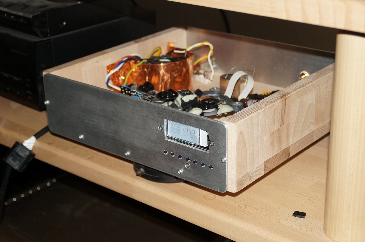

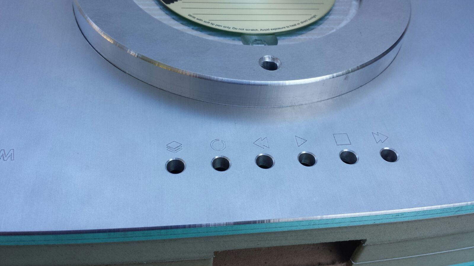

We are working on the third prototype.
Enclosure has been shown to be a tough challenge. The good news is that we have added few more improvements. Quantum is ready to become an unique CD transport, in terms of performance and design.
In January we'll have some pictures to show and some measurements as well. ;-)
Tibi
