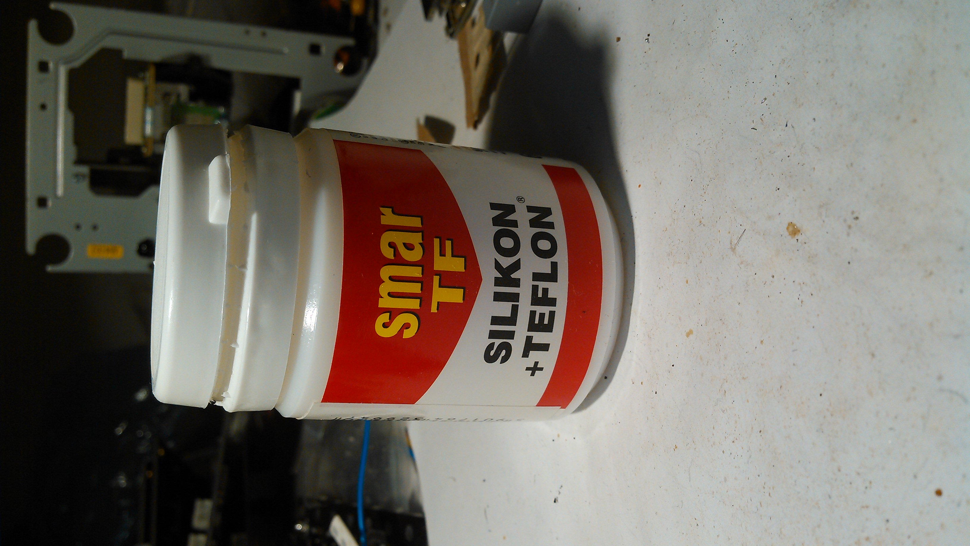

SMAR-TF-60 AG TERMOPASTY - Lubrifiant | TME - Componente electronice

Could you recommend something for cleaning lens?
I use a lightly moistened cotton bud in isopropyl alcohol to gently wipe the cd lens.

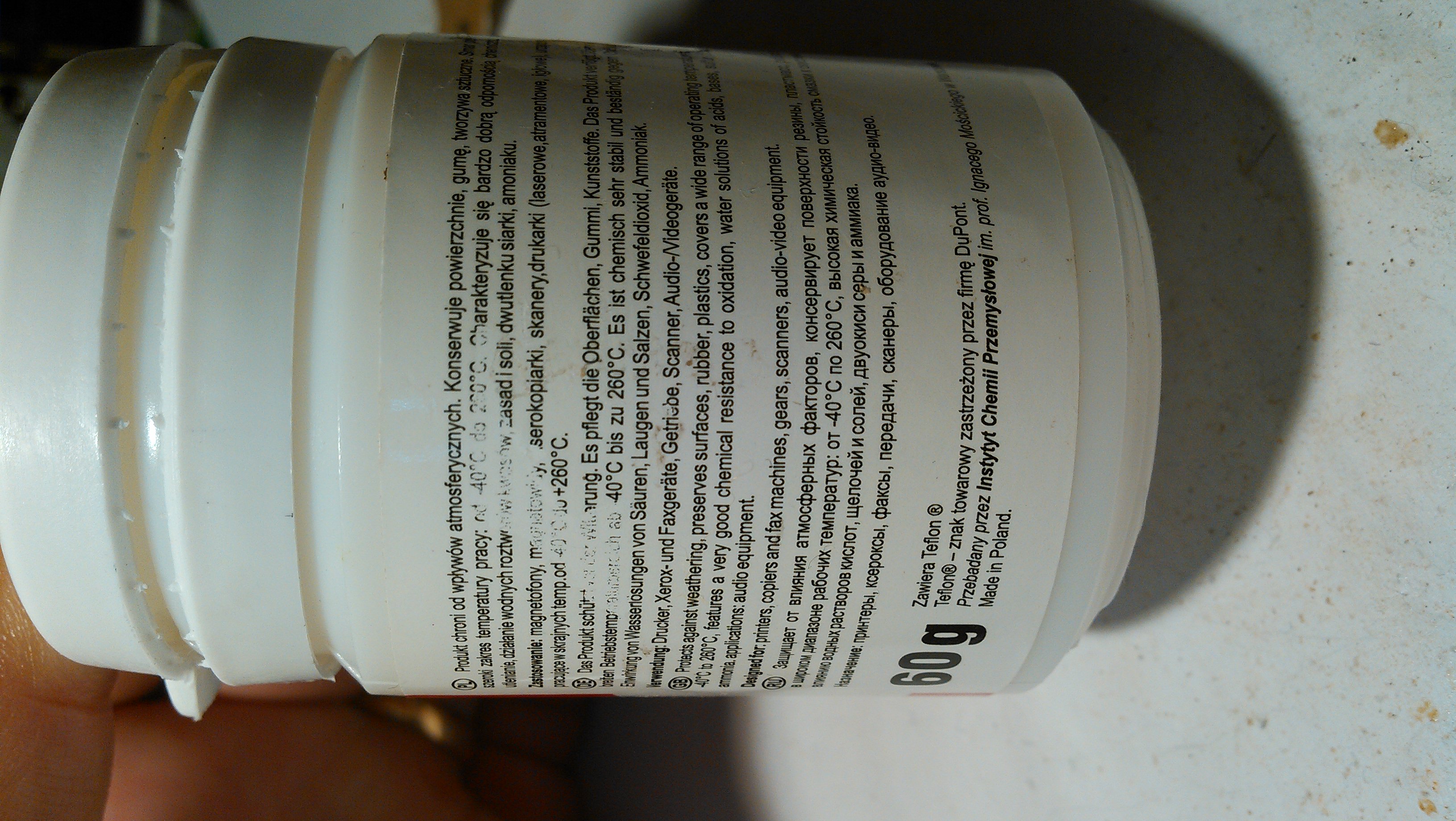

Lubricant for CD mechanism.
See datasheet http://www.tme.eu/ro/Document/0d52fde3c39516adcdec44b7c5784528/Smar TF ANG TDS.pdf
tibi
tibi
All plastic gears and shaft side. Don't use too much, just soft cover all gears and moving parts.
Take care to protect and cover optical unit before this operation.
Tibi
Tibi
Tibi ,so You use that Stuff just for making the Transport quiet ?
Regards DT
Yes. Do you expected something else from a lubricant ? 🙂
