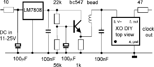

Hi Tibi ,in that one Post You say "Also decoupling the XO with a 1nF silver-mica directly at XO pins brings even more resolution."
How to do that,just put 1nf between the 2 Pins of XO ?
Regards DT
Regards DT
Regards DT
Yes, decouple XO directly with 1nF silver-mica. Use very short leads.
Tibi
Take care which pin are you decoupling.
Silver-mica cap must be in same position as the 100nF cap (near to XO) in below Tentlabs picture.
tibi
