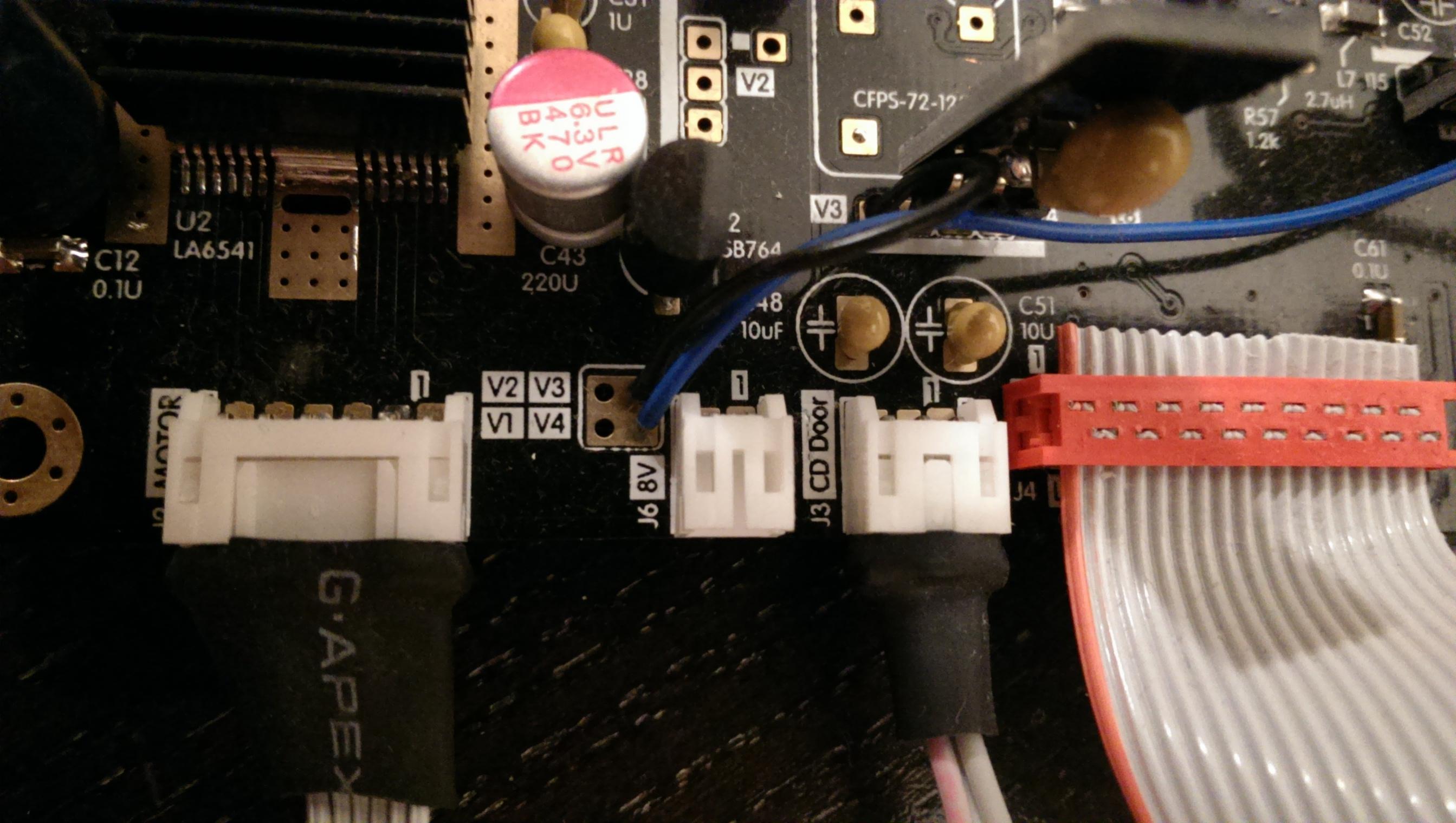

Tibi I have the following problem:
Turn on power, the laser an toc reading starts after 30 seconds. Before the laser not turns.
V1-V4 = 5V.
I have no explanation. Is there a contact problem?
Raimund
Post here some high resolution pictures to see what you have done.

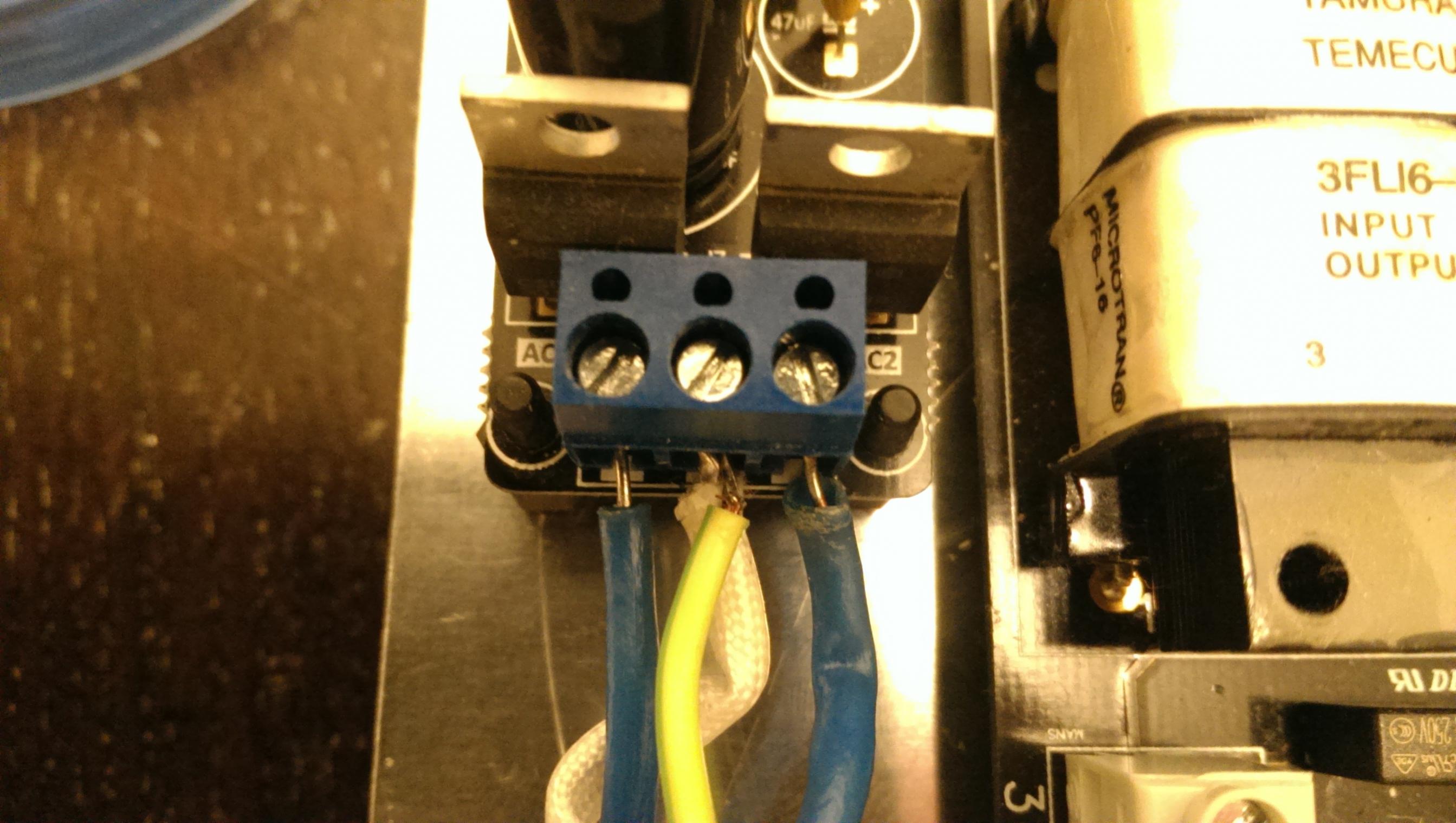

The AC1 and AC2 and the yellow green Cable are connected correct as ahown on the photo?
Thanks for your quick reply
Hi Tibi,
As there is different colour code with euro, I am not sure is it a correct connection before turning on.
Can you show me the correct connection of this part? It will be a great help
Sorry ... seems my message was not posted ... :~
In your image wiring is correct. Anyhow you are solely responsible for any damage ...

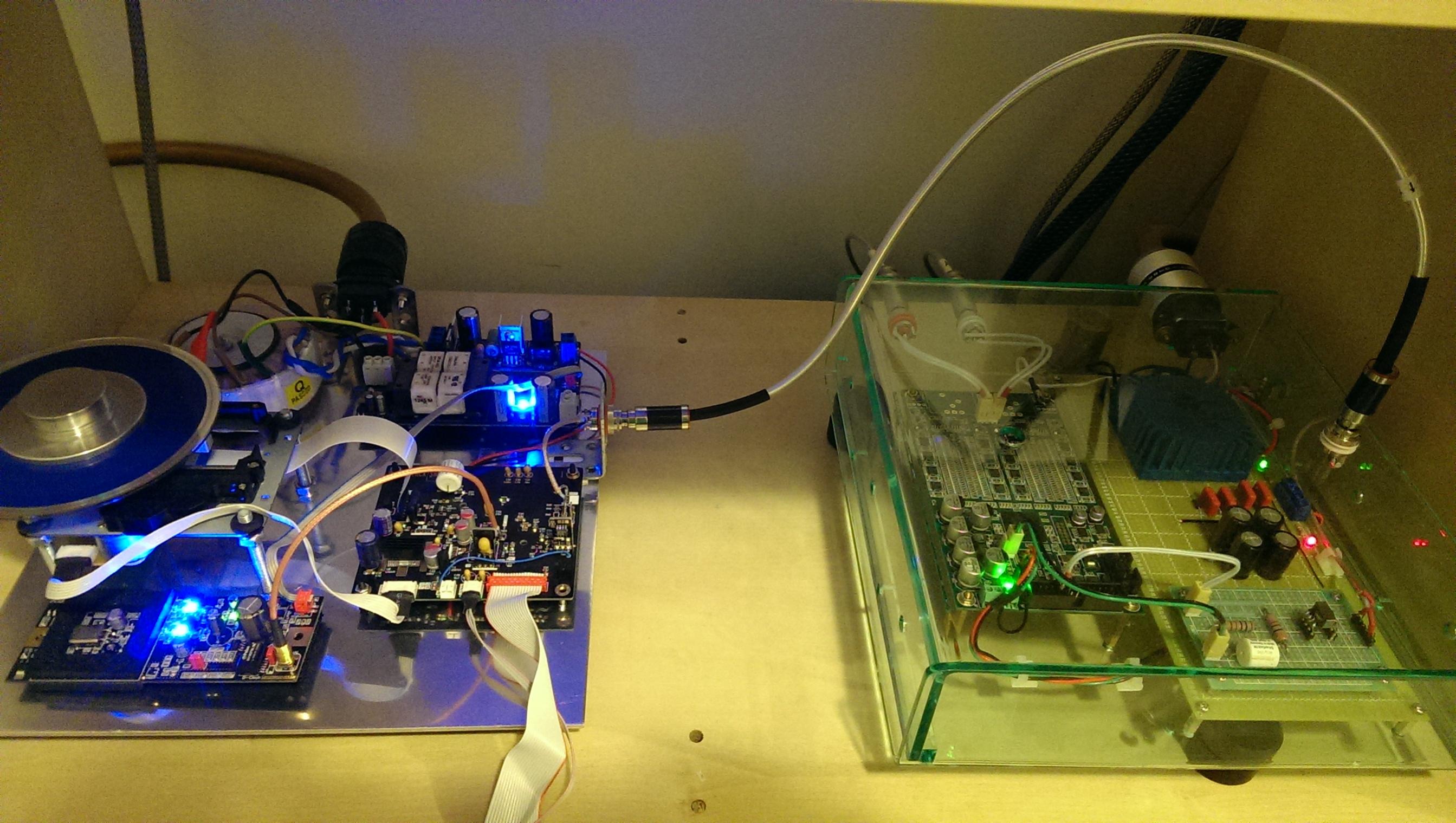

Thanks Tibi, finally I combined Shiga and Neutron Star clock fixed on one board. And that is the 1st to listne it with Nordost Odin SPDIF cord (DIY). The body is full and details.
Current system now is
1 Shiga Transport with external clock.
2 Soekris Dam1021 R2R DAC
3 5687/80 tube amp (0.7w output)
4. Coral Beta 8 fullrange speaker
Sound very good, very enjoy
