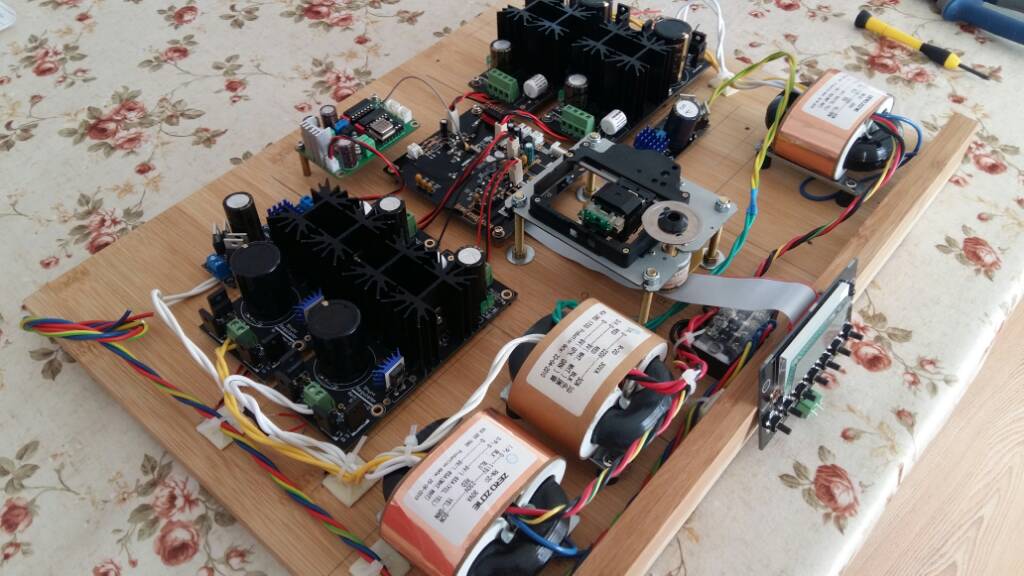

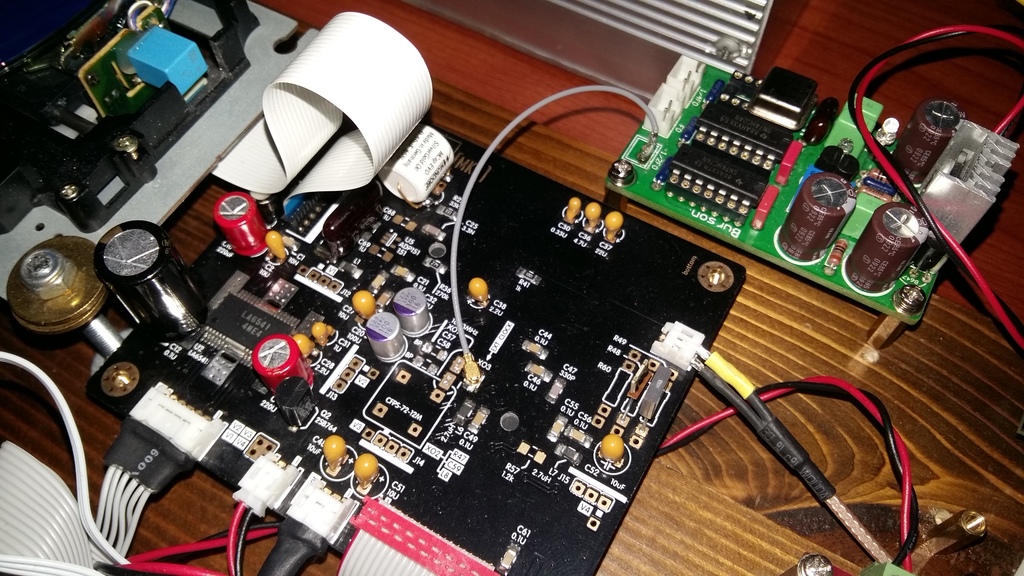

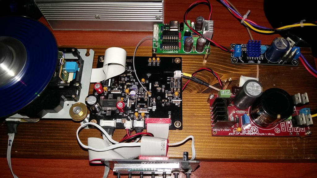

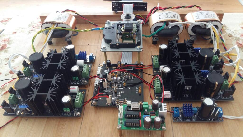

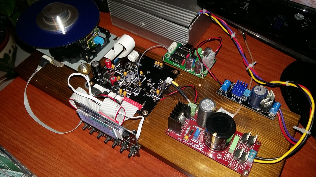

Hi taccodude,
I have done mod with external clock: Burson clock with tentlabs crystal preregulated by Ales ''mravlca'' TPS7A4700 low noise LDO regulator.
The result is a more natural and clean sound.
And yes, those red caps are Black Gate NX 220/6.3 and big cap is a Black Gate Standart 470/16 .
Have tried there sanyo os-con SP (sound harsh and lifeless), sanyo os-con SEPC (clean sound but lifeless) , rubycon ZL (same as SEPC with overemphasis on highs),all of them suffer of missing some bass extension.
Black Gates ,after burning in period, give a juicy ,full of life sound.
Cheers

Hi taccodude,
İ didn't try Tent XO direct on pcb because my is 33MHz one, but have to say upgrade from citizen crystal to Burson Clock give a clear improvement, after i get on swap forum Tent crystal and swap the Burson 's and this gave me ewen more clear, fast and natural sound.
To the Burson Clock , have changed crystal's decoupling cap to mica silver and add ferride bead before crystal. Preregulation for clock is another field for improvement, tried there 78XX, lm317 and finally tps4700 .
This means that standalone clock with his own ps will give improvement over onboard crystal .
Cheers
