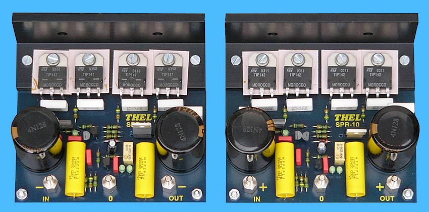

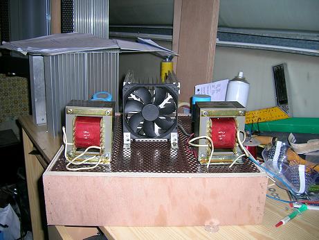

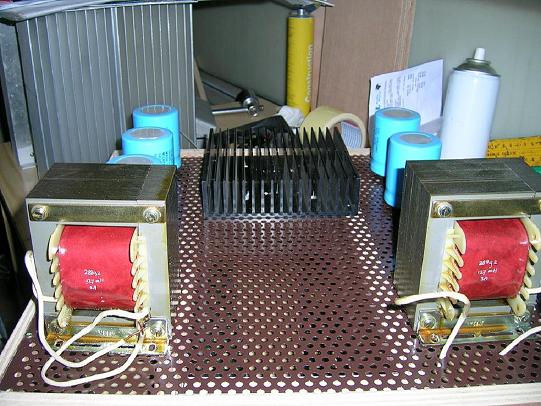

Do you mean my amp?About the heat that's covered.The amp is working at a voltage of 14,5 DC.We'll see how hot the sinks can get.
What about these ones?Tyimo said:Hi Meanman1964!
You will not need so big heatshinks. You will see.....
Greets:
Tyimo
What is your plate's material? Alu?
You should try with the first big heatsink, but without fun. I think it will be enough.
Tyimo
Tyimo
Hi Tyimo,
I have a question for you.The output cap (10000µF) can it be changed by 6800µF or 8200µF?
Yes. 4700 is the minimum.
2x4.7000 would be a very clever solution. May be the sound would be a bit"faster".

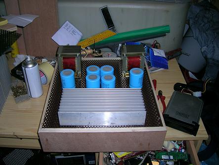

I prefer the big sink,it looks nicer more body.That's my opinion.
Yes, but you will not need the electric fan. (sorry, in my last post I wrote "fun" 🙂 )

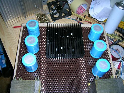

I don't have my toroid yet,I mean the 2x12VAC;I do have one of 1x14VAC without load.I also was thinking to make a regulated supply with modules of Thel Audio.By this way I could use my 2x30VAC toroids.Do I need only 1 toroid?
What do you mean???
You can use one toroid with dual secondary 12V for "kvazi" dualmono" PSU, but toroid with only one 12V secondary is also enough.
Important: You need 150-200VA
