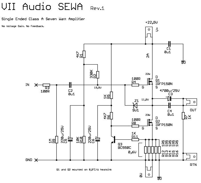

Mad_K said:It reads 0,5'C/W.
OK, that's the problem. My eyes are old!
What rating are your HS?
Dunno, it was scavenged from Planet10's basement.
What is your rail voltage? You need 0,25'C/W (@100W) for 2 channels if assembled as per that schematic.
About 21V with SS power filter or 22V direct to the caps.
Sounds to me like thermal runaway. To test this, try to use just one 1,5ohm resistor (R12, leave R13-16 Not Mounted)
You should now get a stable 0,4A bias. If still unstable, it might also be that the current sink is unstable, try adding a 100-1000pF cap across Q3 Base and Collector.
It's fine and dandy long as she's cool. I gave that CCS a real workout on the breadboard before assembling it (had it sinking about 8 amps for 20 minutes with the MOSFET submerged in a water bath 'cause I didn't have the heatsink yet)
Thanks for pointing out my error. As a glassfet dude, I don't normally concern myself with heat 😉
Cheers!

Hello! Mads_K
I post the Rev. 1 schematic of SEWA.
I hope it is the latest version, but I am not sure.
I just did not have the time to search all pages ...
It is one sweet project 😎
It is as close to Nelson Pass early philosophy we can get.
Keep it simple AND good, boys.

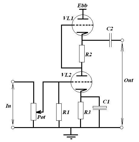

Tyimo said:
Thanks for the nice words!🙂
Here is the schematic.
I think it is as simple as possible!
I forgot some parameters:
Case weight: 15Kg
Temp: only around 40C. (!)
Greets:
Tyimo
P.S.: No CCS, No resistor! Choke Load is RULEZ!!

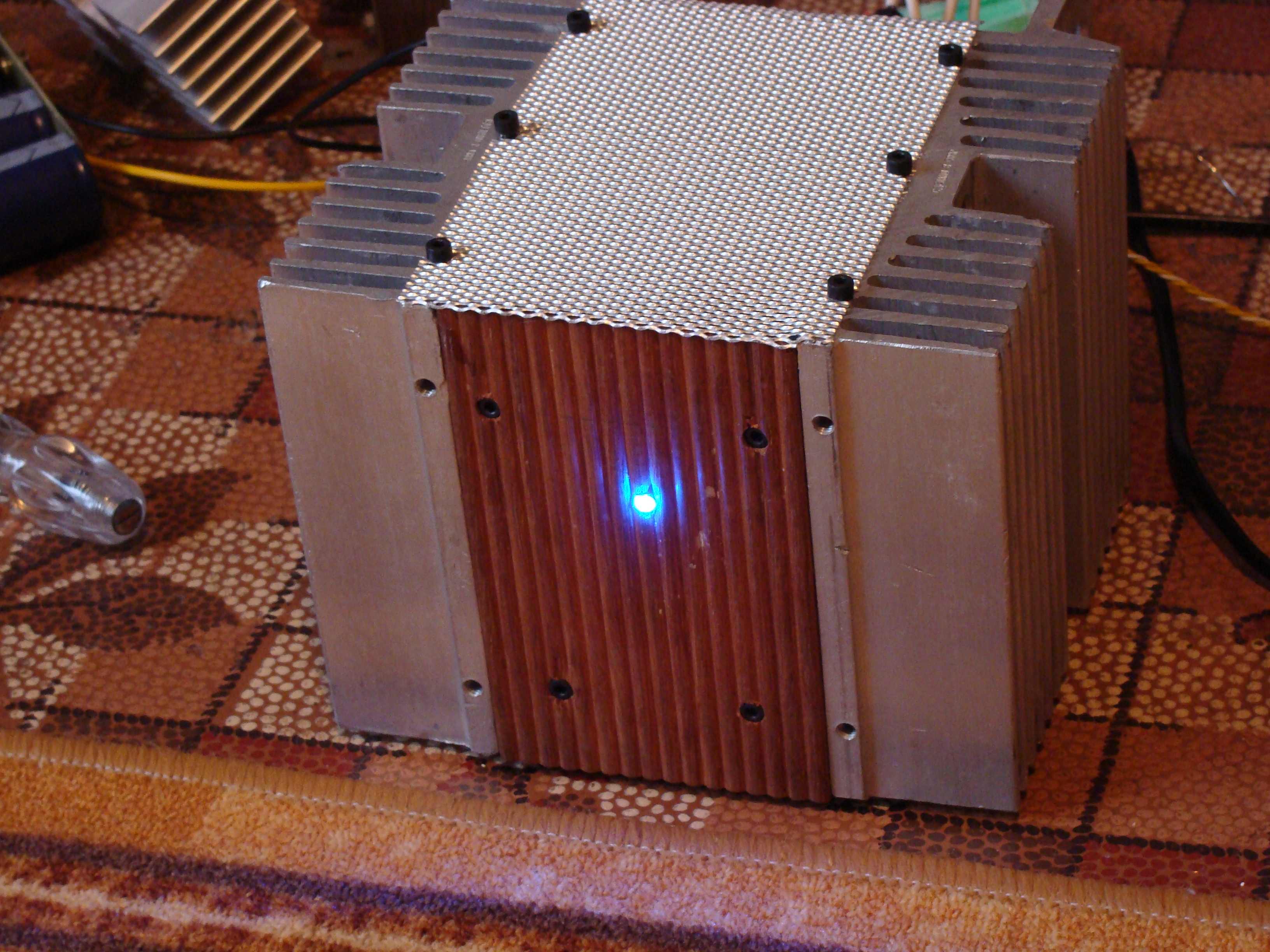

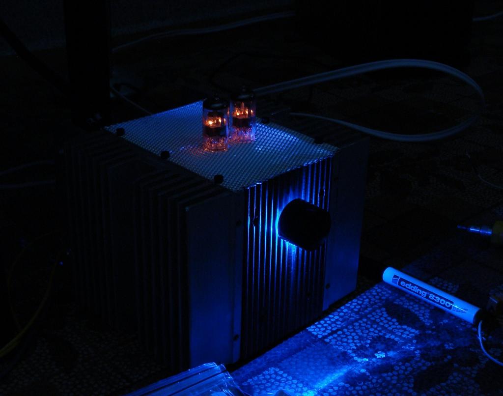

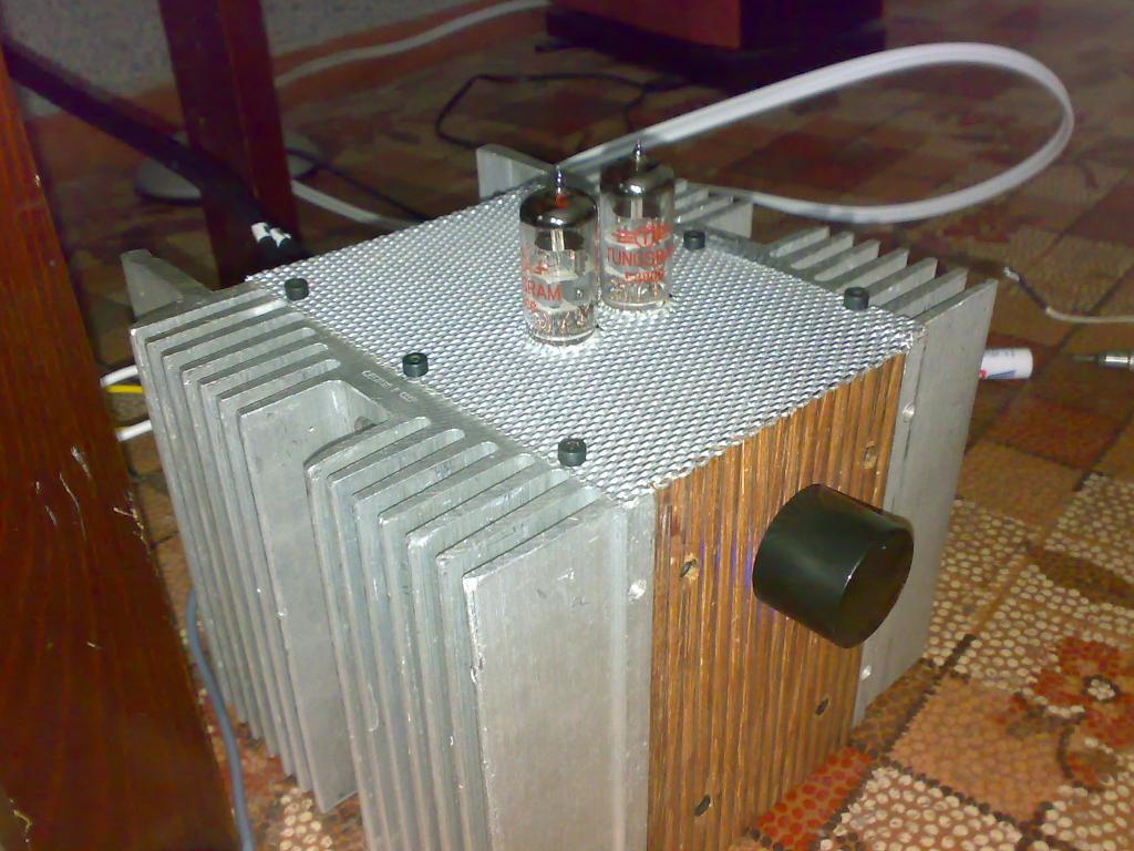

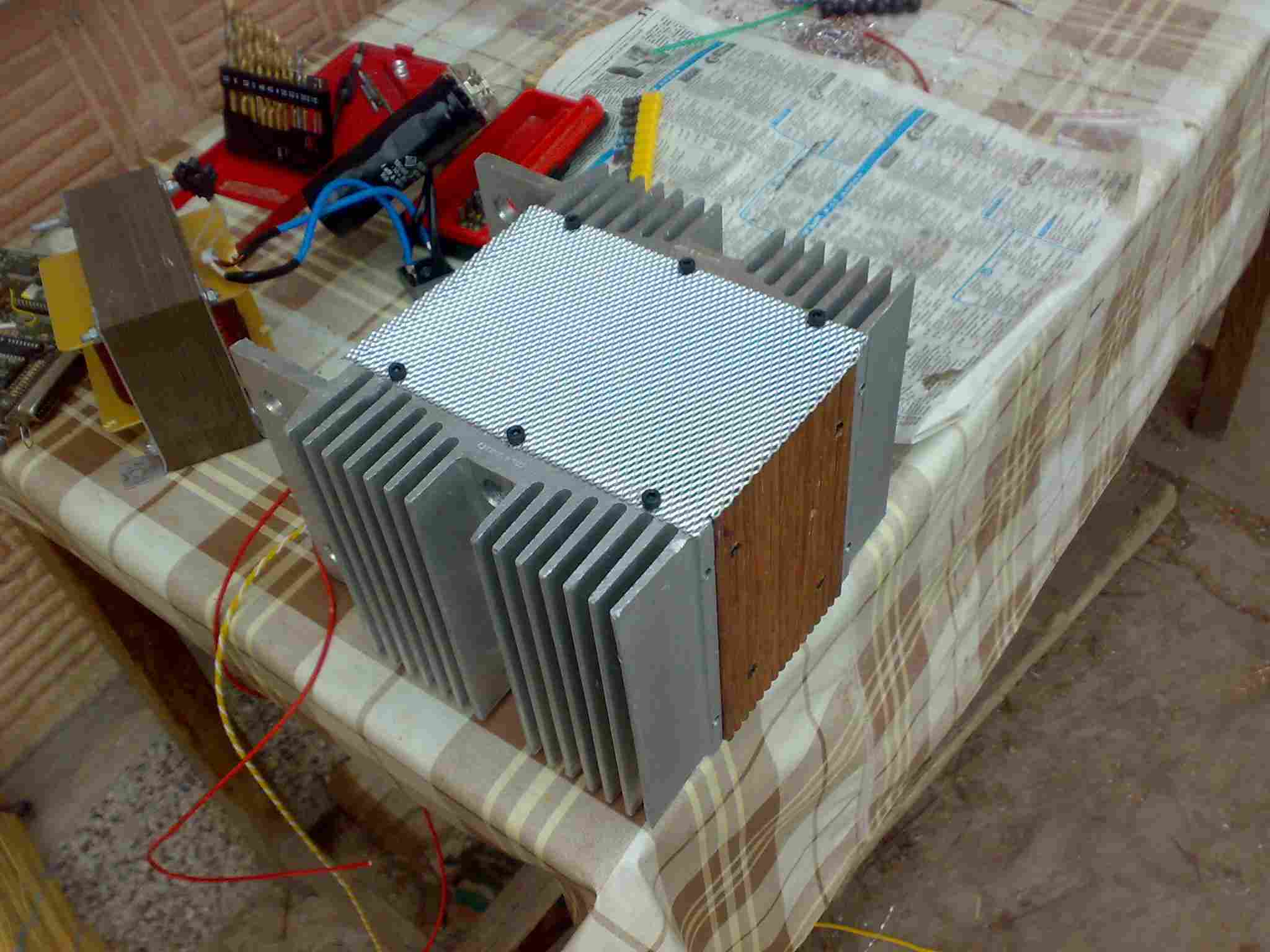

[img=http://s2.postimage.org/oqzY9.jpg]
[img=http://s2.postimage.org/oqYUA.jpg]
[img=http://s4.postimage.org/KAZ8S.jpg]
[img=http://s4.postimage.org/KB5Di.jpg]
My amp works on 32V supply, 2.5 amps bias, temperature of the heatsinks is about 62 degrees C. ( Power is in a separate box)
The preamp is BOZ
Next week I will made rear panel with speaker and signal connectors, i hope🙂
The preamp is BOZ
