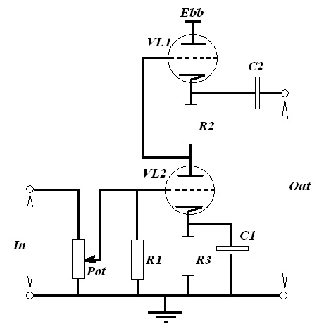

I want to know a solid state front end with a sound character as close as possible to that one of this tube SRPP topology.My SEWA become to a little hybrid amp with big sound😀
The tube preamp is E88CC SRPP, made by this schematics
