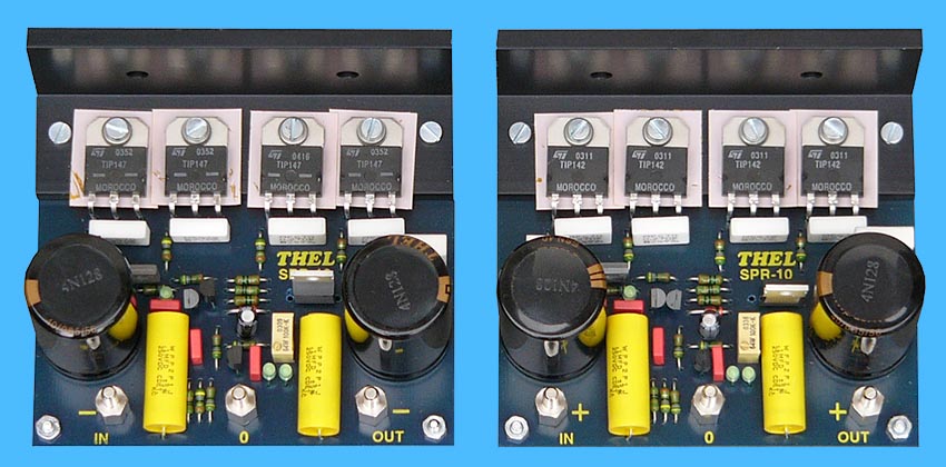

Hi Tyimo,
Thel Audio is telling the same that's why that their regulated supplys don't work so tight voltagefall or is it rimple of 40mV/Amp
If you can read German see here www.thel.de.A tight regulated supply don't sound well.A convencial supply sounds the best.The reason is that regulated supplys don't like big supply caps because they are to tight.Thel Audio's supply is made special for audio-amps.

I love your Darlington PCB design and layout, can you post the schematic and pcb for it? Thanks.
First that isn't an amplifier it's a regulated PSU and second I don't have a schematic and pcb because I bought itnorazmi said:
