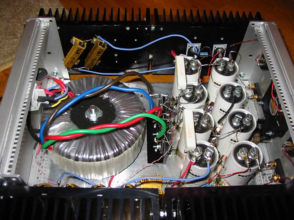

I buildt the prototype in my power amplifier cradle (a retired XSOZ), and it contained almost all of the parts already mounted. No doubt about it, this project is all about chassis, power supply and heatsinking. My prototype runs on 24V, so it's more like a 3W amp. I used a 6,8 ohm 50W resistor for the 10R/100W drawn to get 2A bias and a little more power. My Klipsch RB75's (97dB/1W) are quite happy with this power output in my 22m3 room.

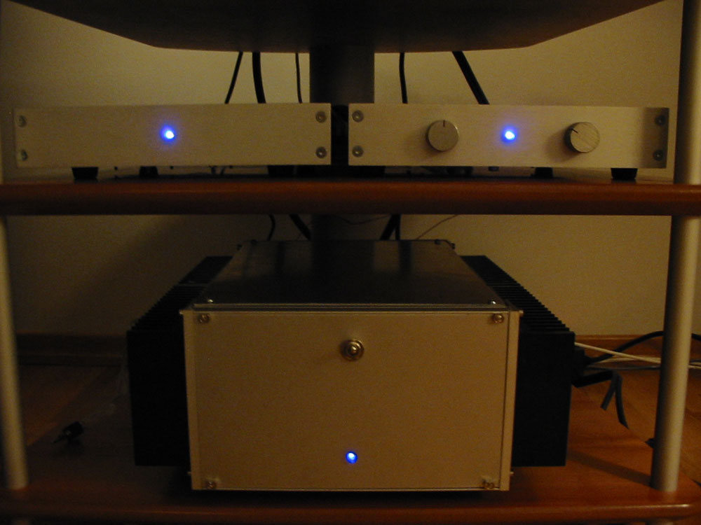

Here it is, playing sweet music, together with my RIAA pre and preamp.

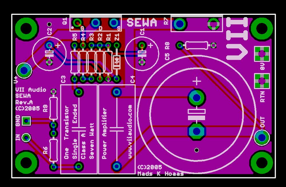

I've made a pcb layout, and will submit it for production over the weekend toghether with a MM-pre and preamp of the same (but common source) topology; essentially a Pacific and a BOZ).
Here's a screen dump of the pcb layout in case anyone is curious:
They are called Atlantic (MM Phono, two stage JFET passive eq, like Pearl, only much simpler) and Moschatus (Pre, one IRF510 in common source mode, like BOZ). I will link up the schematics in the projects section on my webpage as soon as they're ready :cool:
