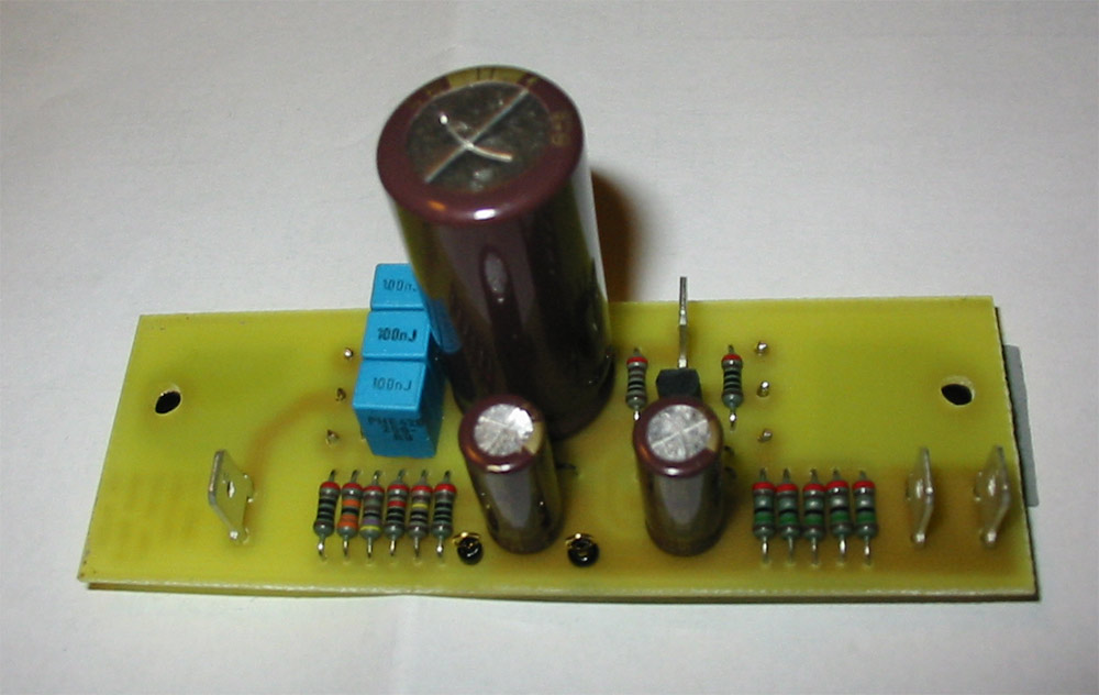

Here's how a assembled PCB looks like ;)
The power posts are 6,3mm FASTON PCB Blade as specified in the BOM. The small ones I use for input signal are often referred to as "testpoints" or "test lug". There are several types, but I use JT-1 from K&H. www.elfa.se/en product # 48-415-73. Now I have included them in the BOM ;)

Mad_K said:
And "djk" wants it at 470K, so you'll meet at the middle ;)
I couldn't register any negative effects from raising it from 100K though.. Anyway, the point with 250K Zin is to make life easier on the preamp that is going to be driving it, and it makes for a nice pcb layout (with good components). :)
There can be cases when you need a high input impedance.
Depends on what comes before power amp.
Personally I would feel bad using more than 22 kOhm input.
And my sources, CDplayer, Preamp, can easily drive downto 5 kOhm loads.
Today Normally used input impedance for power amps is:
10.000 - 22.000 Ohm
The rule is:
If you can,
keep input impedance as low as possible.

Of course everyone is free to choose whatever inputimpedance that suits them ;) If you go to a polyester input cap (elfa # 65-525-09 ) 2u2/50V you can lower R2 to 22K and still use my PCB layout. I have no problems with noise pickup, the amp is DEAD SILENT. I can't see how loading the source more helps anything. What I know is that a polypropylen cap sounds better than a polyester :smash:
