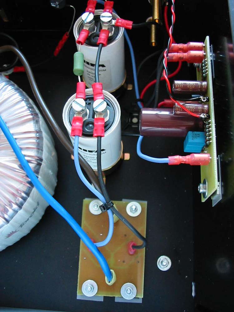

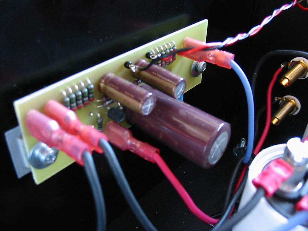

Now I got rewarded for making a easy serviceable layout, replaced the R in the psu, unhooked the pcb and replaced the source resistors on the current source (5x1R5 0,6W in paralell = 0R3 3W) 15min later, I was up and running again 😀 Other channel with psu:

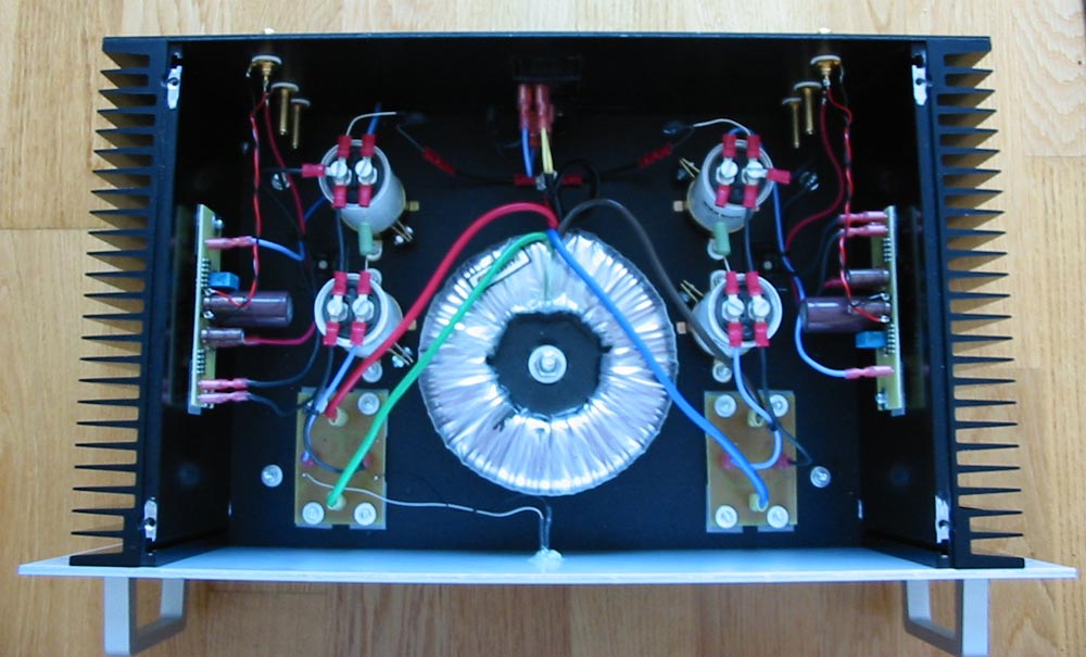

Mad_K said:The whole picture 😎
beautiful work, Mad_K 🙂
Inside Mad_K SEWA amp
I am think of buying me a Nikon Coolpix digital camera.
how did you take those photos?
what lighting did you use?
what is your camera?

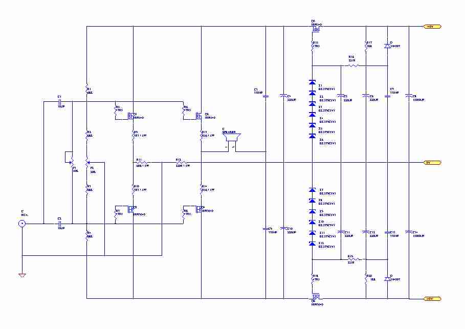

I have a very nice 20" monitor, and I cannot see any details in your schematic.
Can you re-draw it so it looks good on a monitor?
djk said:I have a very nice 20" monitor, and I cannot see any details in your schematic.
Maybe you are not looking at correct place.
I think it is a perfectly alright schematic.
It is in Post #40 Schematic PDF
the onwards posts show pcb and layout and power supply
SEWA Schematic PDF download

Thanks, lineup 😉
I took the photos with my ancient canon powershot A10 1,3Mpx crappy old thing. There are cellphones with better cameras these days. No special lighting, just daylight. If I could afford it I would buy a canon EOS350D and a tripod.🙂

No problem. That trafo will probably get you around 30VDC rails, so I would change R1 to 5K6 to get the DC operating point in the sweet spot (About 15,25V a on the Source of Q1) Also, you need to use 35V caps 😉

It will have more outputpower in 8 ohms, but will be current limited with a 4 ohm speaker with the same bias current. With 2A bias, you will be limited to 8W with a 4 ohm speaker. You can build it, then crank up the bias later if your heatsinks are up to it 😉 I wouldn't go much above 3A though (R12-16=1 ohm) as the dissipation from the mosfet will be hard to handle (45W each). 😉

The bass is very good, considering that it is a single ended, no feedback design. 42V and 3A is dangerously close to the limitations of the fet's
Unless you've got HUGE heatsinks or watercooling I would consider a LC (+LC) or a regulated supply to get the rails somewhere around 30V with 3A bias. I don't think you will gain much with IC regs in this circuit. If you go the inductor CCS route you're on your own 😉
