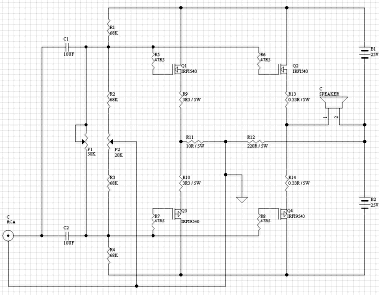

one stage amp
Sorry for the late replay. I have been tryingen to make a better sch. of my amp. But my screen cap is not verry god.
So here is a link for down load of the sch.:
http://rapidshare.de/files/14371438/Cap128.jpg.html (550Kb)
If anyone is welling to helpe my, please poste the pic. So it can seen on this forum.
The amp is one stange whit voltages gain, low output imp. and no feedback. It has a real nice sound, much like a single ended tube amp.
I hope you can use it.
Regards
Frank

Here is your MOSFET amplifier.
In attachment.
I had to do some image work 😎
Maybe you can use schematic, if you start a new topic about your amplifier.
This topic is about Mad_K amplifier SEWA.
Frank40 said:
I have been trying to make a better schematic of my amp.
If anyone is welling to help my, please post the pic.
So it can be seen on this forum.
The amp is one stage with voltages gain, low output imp.
No feedback.
In attachment.

Sorry Mad_k for bargeing in to you topic, It seems that I can not delete my postes in here.
To Lineup, thanks for you helpe whit the pic.
Frank
