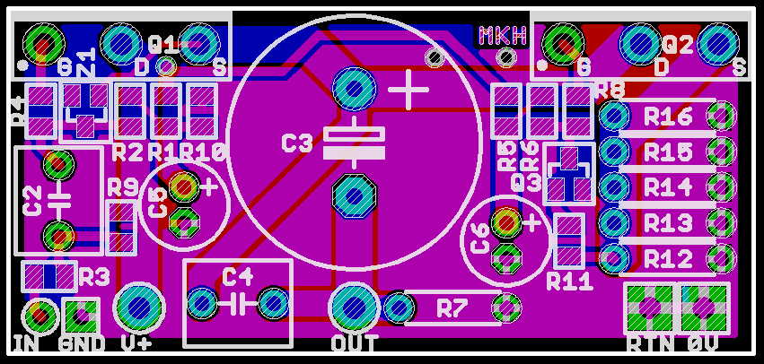

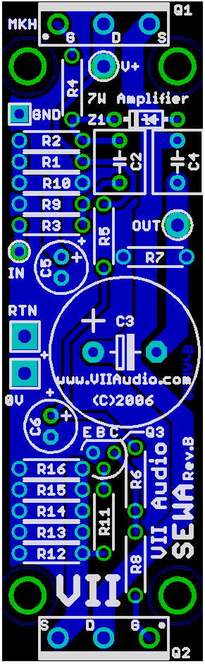

Professional SEWA PCBs?
Jason ( jleaman) wants to have professionaly made SEWAr1 PCBs. I have made a pcb layout for prototype production, and I will run this if there is some interest. I've managed to make a nice single sided board, plated through holes, soldermask and silkscreen. Board Size is only 25x80mm. The cost will be 10$ per board. I will only make 8 boards on this proto-run, and then build/test it. Jason wants a pair, so for now there will be only 2 pairs available. If there is continued interest I will have some more boards made.
Post here or email me directly if you are interested.

Update
As it turns out, my PCB supplier will not deliver single sided boards with plated through holes, only double sided. I am in the process of redesigning the layout for a 2-layer board, gold plated, green soldermask on both sides and white silkscreen on top. I want to take advantage of this, and use some SMD parts (0805 and SOT-23). This will be a better performing board, a little smaller 25x53mm, but some are reluctant to do SMD soldering. I can now get the price down to 7USD per board. How do you feel about this?
From this proto-batch there will be 5 pcb pairs available. jleaman and Jack C. have expressed interest, and if they are up to some easy SMD soldering, I have 3 pairs available.
I would like to have a pair too, I am very curious about the sound of Single Ended Solid State 🙂

Would it be possible to order the smd parts too?
It's a bit difficult to buy them in small quantities over here.
squadra said:Would it be possible to order the smd parts too?
I can manage a partial kit with all the SMT parts and the HMT resistors on this batch. Attached is the BOM
Cost of these components for a pair of pcbs will be an additional 7USD.
