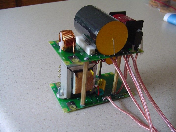

What a fascinating project; I will need to fab my own boards as I missed out on the board offering by a mere three days!! I am driving an all Klipsch system, so I do have very efficient speakers. From the positive comments, I need to try this, as it seems a simple and adequate first amp to build. THANKS for sharing this!!
PS - if there are any more board builds, please advise. On the other hand, I work in the PCB industry, so if anyone needs boards, I can probably provide.

Mad:
Alll for a home theater setup:
Academy center
Forte L & R, and surrounds
KG2 rear surrounds
I also have a set of Cornwalls but do not care for what I consider a "hot" midrange, these will be sold in the near future.
All speakers have my custom crossover networks installed, and have a very hhigh quality sound. I am using an H/K receiver at present, but am wanting to build seperate amps. Pic of my crossovers attached.
