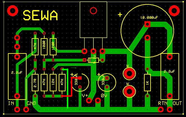

There is an error in the gate bias circuit. The 47K that connects to the 330U cap should be connected to 0V where you have connected it to the cap. The 330u cap should be connected at the junction between the 12K and the 47K. Other than that, it looks fine. I would have designed it much denser though 😉 I recommend to have holes for standoffs/pcb mounting in the front corners also.
Since this design is what I've called OTA, I'm posting my design files for you in the OTA thread Tyimo. This pcb will fint in the same holes you drilled in your heatsinks for SEWAr1 😉

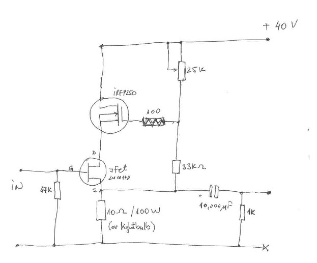

This is a rough idea about SEWA with a Jfet. I think that this circuit will not work as is, Jfet is not biased properly...
I kindly ask more knowledgeable guys to have a look at this and suggest neccessary corrections. The main idea is to merge good sides of both ZEN V8 and Sewa, which would resuld in an amp with zero voltage gain, 5-10 w power, and excellent sound...

If you could find a JFET that can take as much heat as a MOSFET, you can simply pop it in the SEWA circuit with a minor adjustment of the bias voltage divider to account for the different VGS. However, since such a device is not yet avaliable, you'd have to get smart and utilize some tricks like cascode operation to get the dissipation down. Sounds like a fun project 😉 Read up un Nelson's cascode article; it shows cascoding of a follower. Compare this to the ZV9 and you can start connecting the dots. 😉

As far as I understand, why LU1014D is for the kind of like a triode at its small signal and low Vds level. Therefore, the signal voltage swing might have to be kept low inside the narrow triode area, unless the kind like a triode is given up.
Regards
Regards
Then, it seems that it doesn't make much sense build a follower with LU1014D, since the most benefit is extracted in the common source mode?

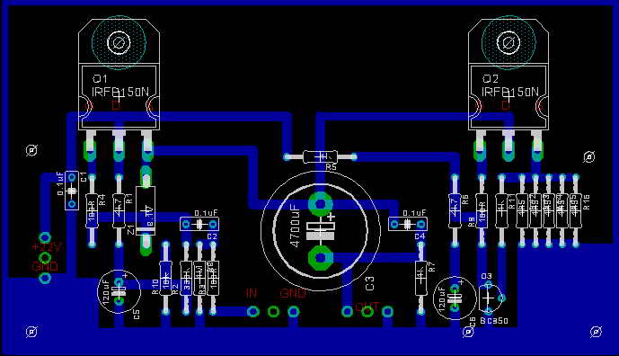

Can you check my pcb layout for Sewa R2
I will send to your email
Buy PCB from other country i Will cost Whole Amps 😡
Beause shipping cost is very expensive 😡
I Only Build for my self with hand drawing pcb ........
Can you pm your email, because i can send picture to you using this forum email.

Is this corrent layout mad_K ?
I can not use your layout, because i can not put heatsink
