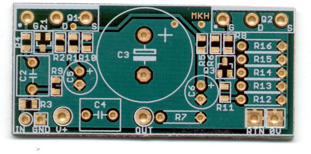

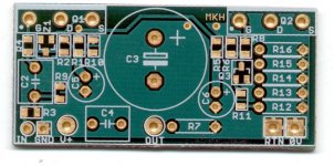

Looks OK at first glance, except for the 0V connection (PSU return ground) should be on the opposite side of the boards near the source resistor array 😉 edit: Remove the ground loop that runs around the board edges too..
Because all of the return current (2A) to the PSU runs through the 0V pad. You don't want to have this current running through your signal ground and mixing with the speaker return etc. In short, you will get higher distortion and noise. 😉

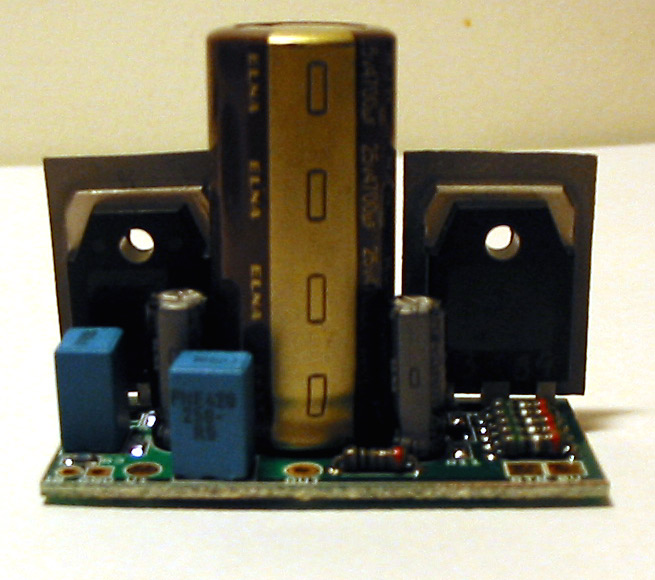

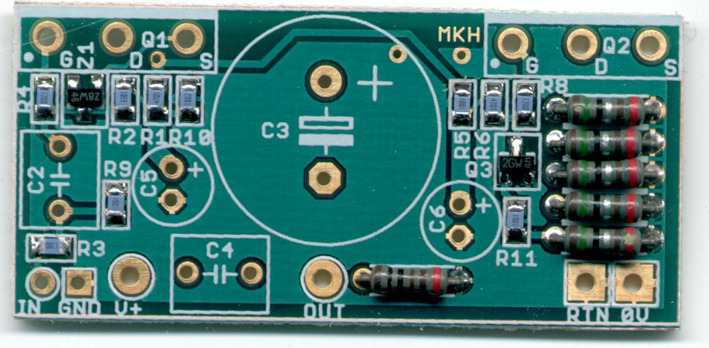

Mad_K said:Assembly completed. I think I'll take a break now and test them tomorrow 😉
WOAH! looks nice.. I love smd stuff. I should post a pic of what i just completed 🙂
When are we able to buy them from you ? When i purchase mine would you mind including the smd resistors and the smd transistors for a few extra $$
