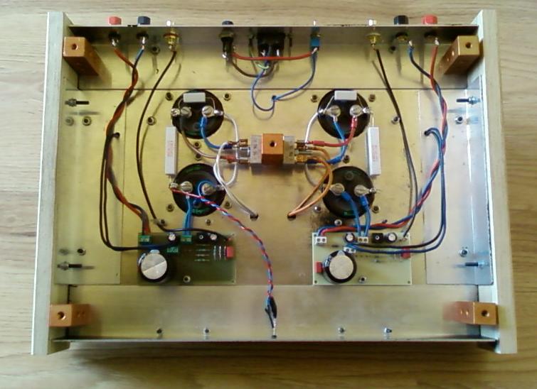

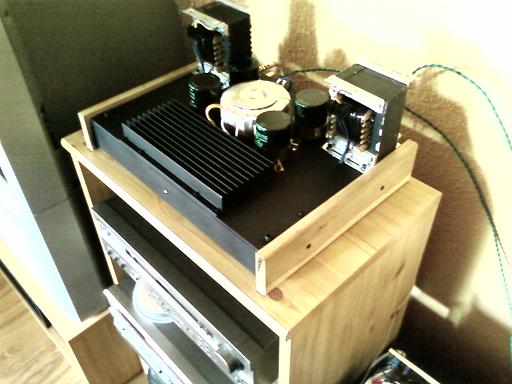

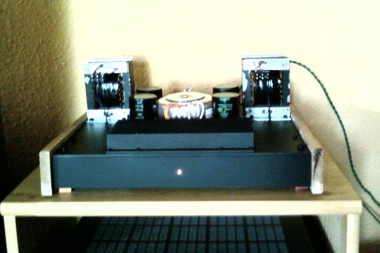

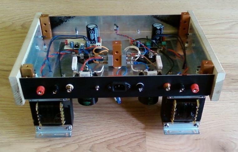

Choke Loaded SEWA
HI!
I would like to report you about my finished new amp: The Choke Loaded SEWA.
Yes, it is finished and ready and it has incredible good sound!!!😀
I built the amp with recycled parts from my junk box and garage to keep the cost low. So don't look at the design quality of the case and the parts....
The amp was working perfect from the first power on. No "hisss", no "brummm", no oscillation.
It is absolutly and totaly deadly quiet on idle!!!!!! I have never ever heard such a low noise DIY amp.
It is working on 14.5Vdc and 2.2A bias.
The sound: It is beautifull. The power and dynamic are astonishing! The sound has full body. Even more deatail then the "stock" SEWA! Very stong and real controled bass, silky mid and high.... etc. Should I continue?😀
Here are the parameters:
PSU:
-200VA-2x12Vac!
-CRC 50.000uF/channel
Circuit:
-127mH, 0.54Rdc airgaped EI choke
-IRFP240
-standard resistors
-Wima nonpolar caps
-10.000uF Stone ELKO on the output.
I would like to thanks all the help for
Mads and Lineup and Fuling and Circlotron! I learnt a lot from them!🙂
Greets:
Tyimo

Looks good!
Looks good Tyimo! Congratulations. Do you have a schematic?
I really like your tubeamp-like design. It is really appropriate with these ultra simple good sounding follower circuits.

He Tyimo looks great man,can I have a schematic of this amp?
Where can I get those chokes in Europe or did you make them yourself?
