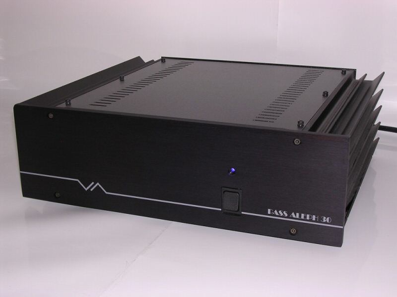

BTW, I found a used Aleph 30 the other day (very rare here in Norway). I'm looking forward to getting my hands on a original 😀
