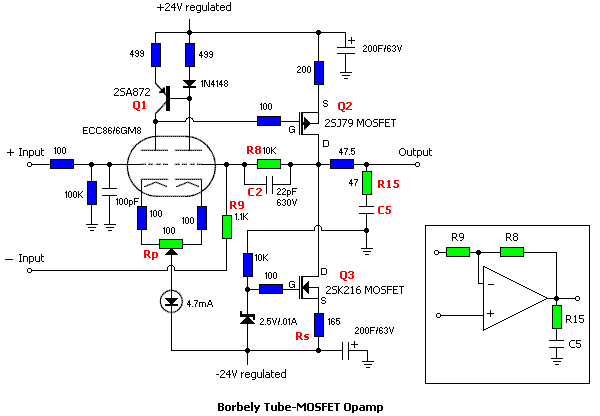

Yes, Borbely
Transistor, CCS, Constant Current Source feed into ECC86 / 6GM8
with 2SJ79 / 2SK216 MOSFET complementary output.
At +- 24 VDC supply.
Just the way I have imagined my eventual Tube Preamp!
A nice hybrid!
Surely a circuit for us solid state guys
as a suitable first tube project.
We might get hooked on tubes and get a taste for it, if trying such an intro. 😎
ECC86 / 6GM8 is a special tube for low, 12-50 volt circuits.
It is not as easy to find as 6DJ8 / E88CC / 6922,
but still in several parts of world should not be impossible to find.
I have seen them for sale here in Europe.
How about 2SJ79 / 2SK216 ?
Have you seen them somewhere?
I am sure there can be a similiar MOSFET pair as a good alternative.
A nice hybrid!
Hi!
I bought by RScomponents.
Here is another version of the Hybrid with irf fets.
You can also use ECC88 tubes with a bit higher voltage +-33Vdc
Tyimo
Tyimo
thanks Tyimo
I put of copy of that one in my schematics for possible future project.
E88CC / 6922 / 6DJ8 are to find everywhere at good prices.
What I could find out from Borbely Hybrid ( ECC86 + 2SJ79/2SJK216 )
and the 2SK216 datasheet,
this Borbely amplifier
is biased to something like 12-15 mA in the output MOSFET stage.
Of course easy to adjust output current capability by changing Rs ( 165 Ohm ) and/or the 2.5V zener.
Myself prefer to use 2 RED LED instead.
This would give ~3 Volt and be suitable for setting current in 2SK216.
See this good topic by Christer on Voltage References:
Some noise measurements for LEDs and zener diodes
😎 BookMark! 😎
