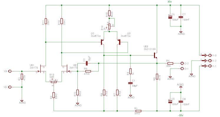

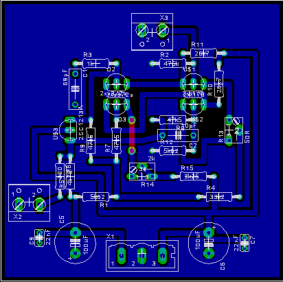

Tyimo said:Hi Mads!
Here is the Kaneda preamp.
I don't know why it is not working with my eagle....
Tyimo
unfortunately my freeware Eagle 4.16
cant open your files.
something about illegal copy
sorry, I wanted to see it

Sorry, looks like it's been created with a cracked version of eagle...🙁
(I have 4.15 Pro)

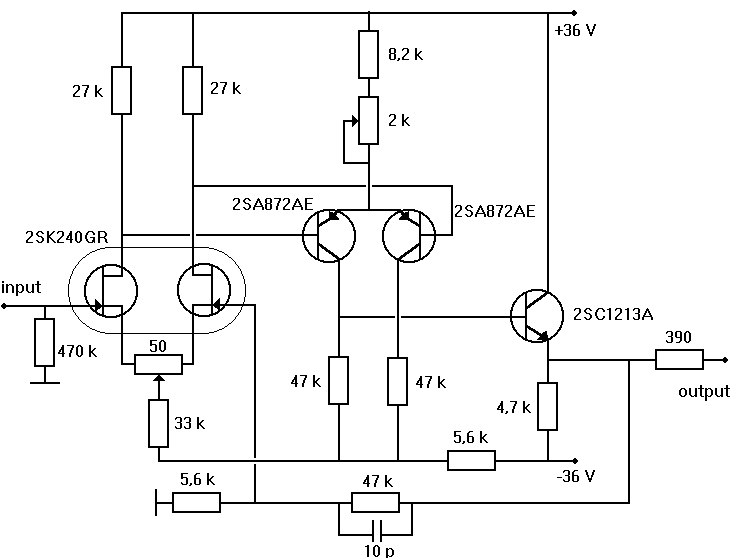

Here are some specs:
Line stage
Gain 18 dB
Noise < -120 dB
Distortion < 0.003%
DC-500 kHz frequency response
+30 dBu output overhead
Can drive 600 ohms load (without the 390 ohm resistor in the output)

Make a screenshot capture
when you have circuit ( .sch ) in your Eagle.
Then attachment this screenshot image for us.
I think this will work, any time!
I be most happy if you did ....
Tyimo said:This preamp has a big "cult" in Farnce.
Do you mean this?
http://www.bonavolta.ch/hobby/en/audio/kaneda_p.htm
Hi Lineup!
Yes, basicaly my problem was that I couldn't open the eagle file from that web page. There is already a screenshot image on the site, what I attached now.
Tyimo
Tyimo
Looks nice, but I think it has about 5 times too many transistors in the signal path

Nice little pre amplifier.
Or maybe we can call it a ' Hifi Discrete OP-amp '
using only 5 T
but with higher voltage supply than most IC op-amps.
+35 -35 Volt
