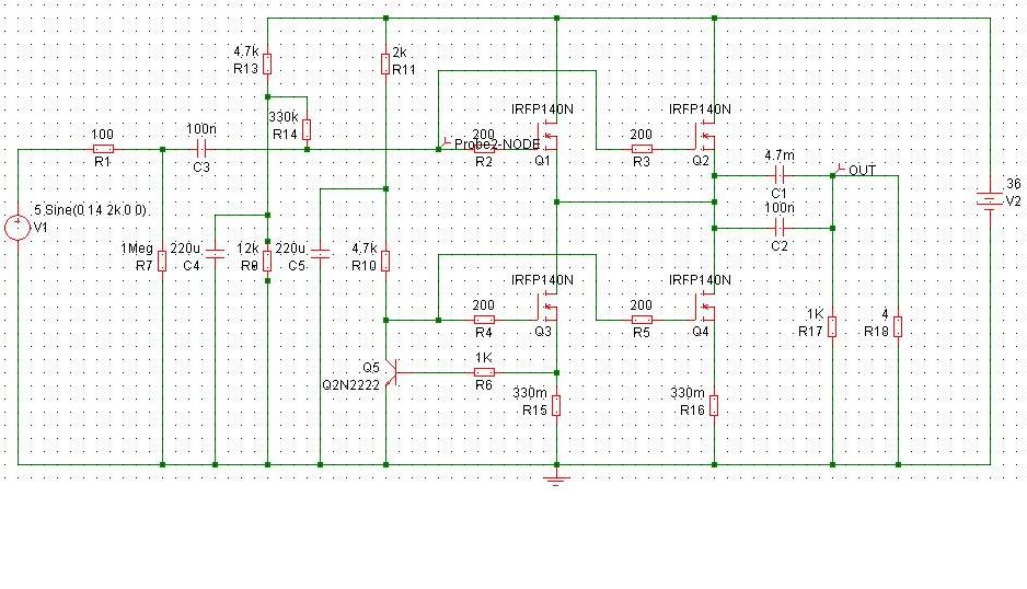

36v 4A
My first post.
Hi
give me your opinion.

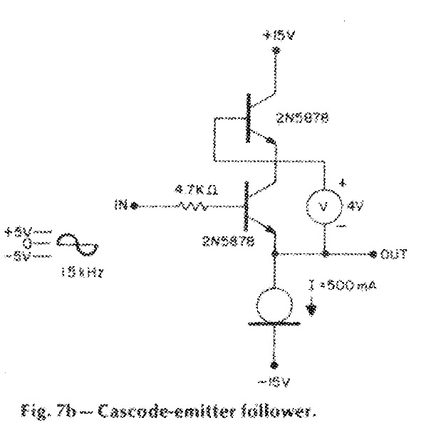

Tyimo said:
Hi Mads!
And one question from me: could you draw or show me a cascoded source follower circuit? Just to see how is it looks like. I have never seen any....
Maybe it would be a good starting point to build something with my power Jfets. 😀
Greets:
Tyimo
From Nelson's cascode article, Fig.7b 😉
