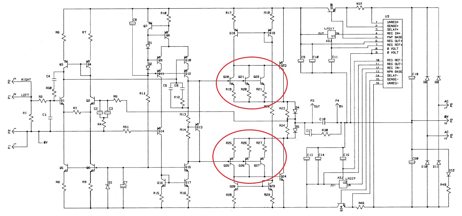

Hi folks,
I'm working on another amp and have some decisions to make around the second stage. I could go the MJE340/350 (stand alone or darlington/ compound / cascode) but I like the idea of faster & more linear devices. Finding one that will take a bit of heat is difficult, hence my question; Is it ok to parallel them. In this example it is T9-T12 and I'm thinking 2 each of 2SA1381 & 2SC3503.
Naturally I will match them so I feel it's ok, but have I missed something?

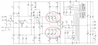

check out schematic Linn Klout, first PDF in post #52 under
tweaking classic Linn LK1 & LK2 / LK280
Thanks tiefbassuebertr!
I presume you are talking about this arrangement*. Yes this is what I was thinking as well, although in a different stage configuration. Thanks for the find.
* Source: LINN, Service Manual for LK2 Series of Power Amps. Copyright 2000 Linn Products Limited.
Curious design with the second stage in a 'half-fixed differential pair of Q9-Q10, doubling the drive through the mirror of Q16-Q17. Q10 is in the very centre of this configuration, compensated with C5 and C6-R12. Must run a fair amount of current to have the Q19-20-21--Q25-26-27 driven properly, which themselves sum their signal current into Q23-24. What is the ultimate reason for three in parallel io one single here?
Q23-24 might be singelton's, can be darlington's.
Power supply suggests only a moderate power amplifier (317-337).
Might be to share dissipation?
