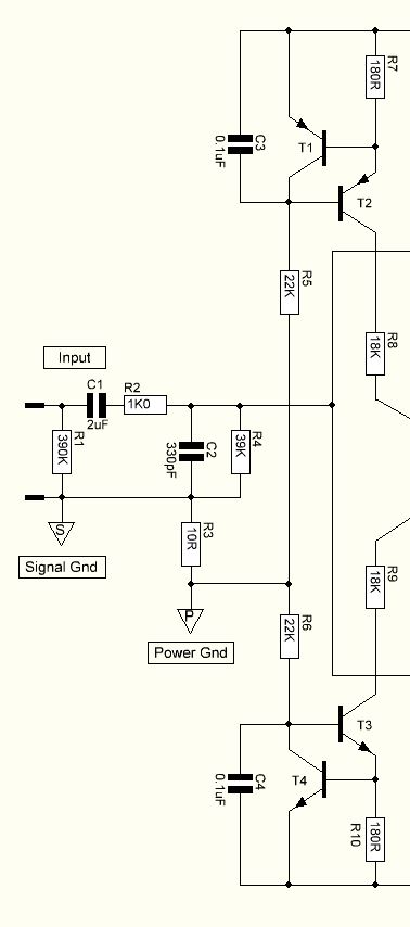

Hi Quasi,
why not use single 47k instead of double 22k (R5/R6)? Same idea for R28, R29, using single 100-120k. Less noise injection to the GND.
I would vote for triple darlington, and sinlgle VAS, maybe with Hawksford cascode.
Sajti
Hi Satji,
You have found an error in my drawing - thank you. It should look like this.
Yes I can run the single 47K. Either configuration should be easy to accommodate on the PCB as an option. Thanks for the suggestion.
Cheers
Q

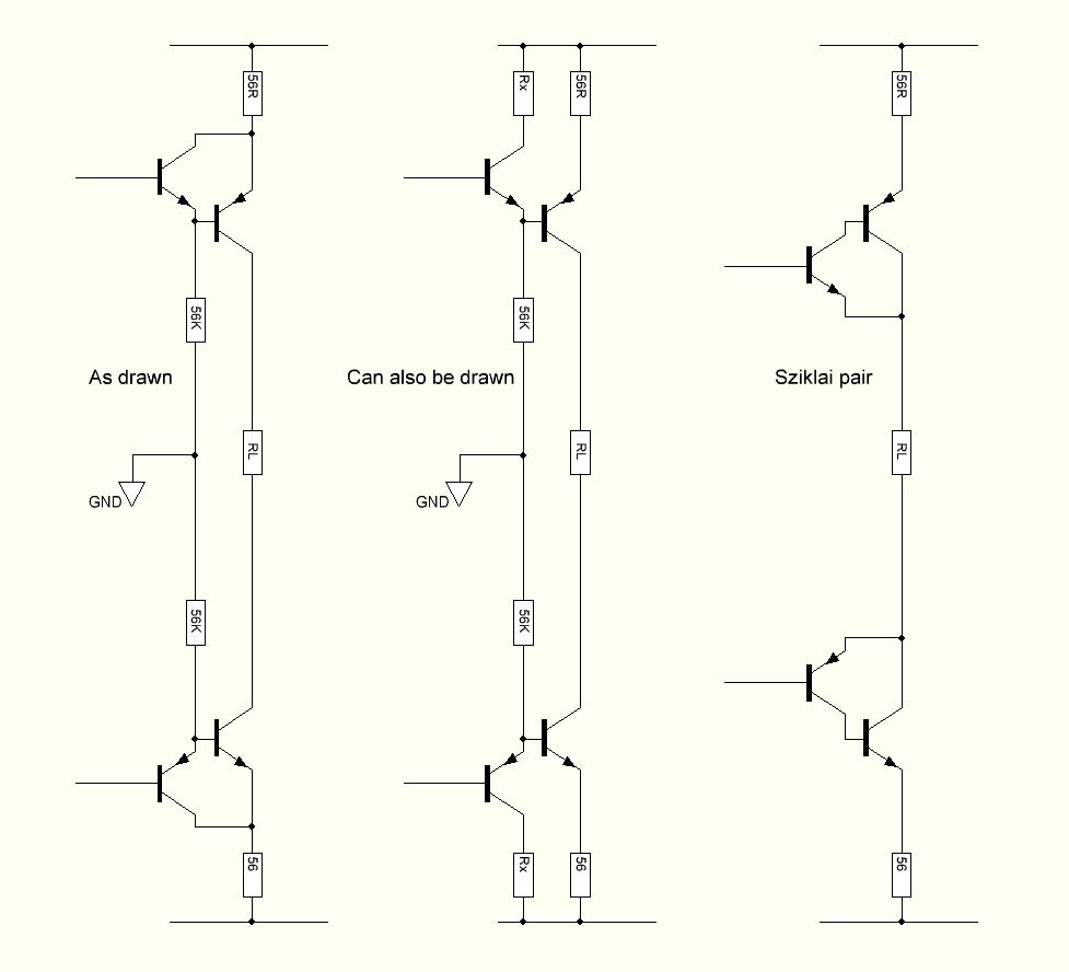

As Drawn is ok, it's a Sziklai proper.
Can also be drawn is not a Sziklai, it is not a compound anymore (no immidiate control).
Sziklai Pair are Sziklai pair, but I would recommend swapping them like As Drawn if you want amplification. It's more like an output stage on steroids.
Instead of grounding the two 56k resistors, you might consider connecting them to to opposite (better somewhat regulated) rails.
Thanks for the advice MarsBravo. I feel as though I might abandon the parallel idea and minimise the draw on the first stage.
Why is running the 56K resistors to rail better than going to ground? I thought ground would be less noisy than the rails (although I intend using regulated rails for the low current stuff.) I will also be using a separate signal ground via a 10 ohm resistor dedicated to input and feedback only.
Happy to hear another view.
Cheers
Q

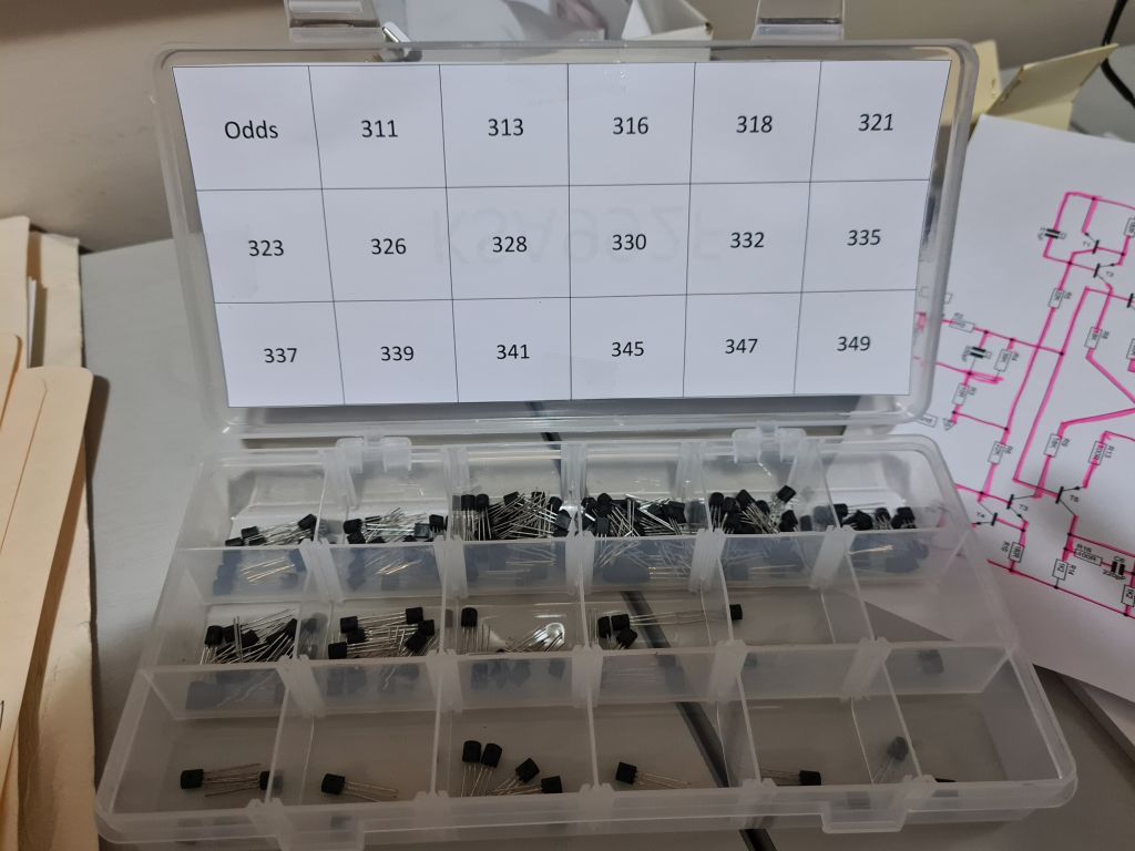

Anyway here's a pic of some KSA992F sorted by Hfe. Will do the same for the KSC1845F's.
Cheers.
Q

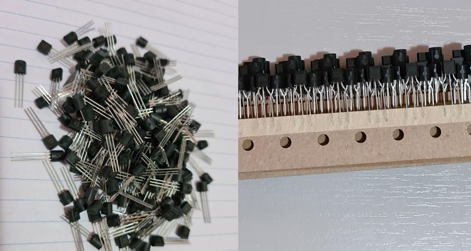

As an aside, my input transistors arrived today. 200 each of genuine Fairchild KSA992 and KSC1845. And they're "F's" so better than 300 gain.
Gotta say I much prefer the loose one's over the taped ones.
Cheers
Q

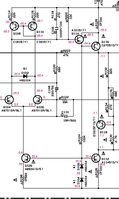

Hi MarsBravo,
I could probably get away with not using the compound (double) second stage and just run a conventional VAS. I thought I would try the double and minimise the load on the first stage as much as possible.
I first saw this in the schematic* of my old Yamaha Rx-777 receiver and became interested in it. The Yamaha version is after a single ended LTP, but I thought I would try it on the twin.
* Source: Yamaha RX-777 Service manual, Doc 100749, Yamaha Corporation.
Cheers
Q
