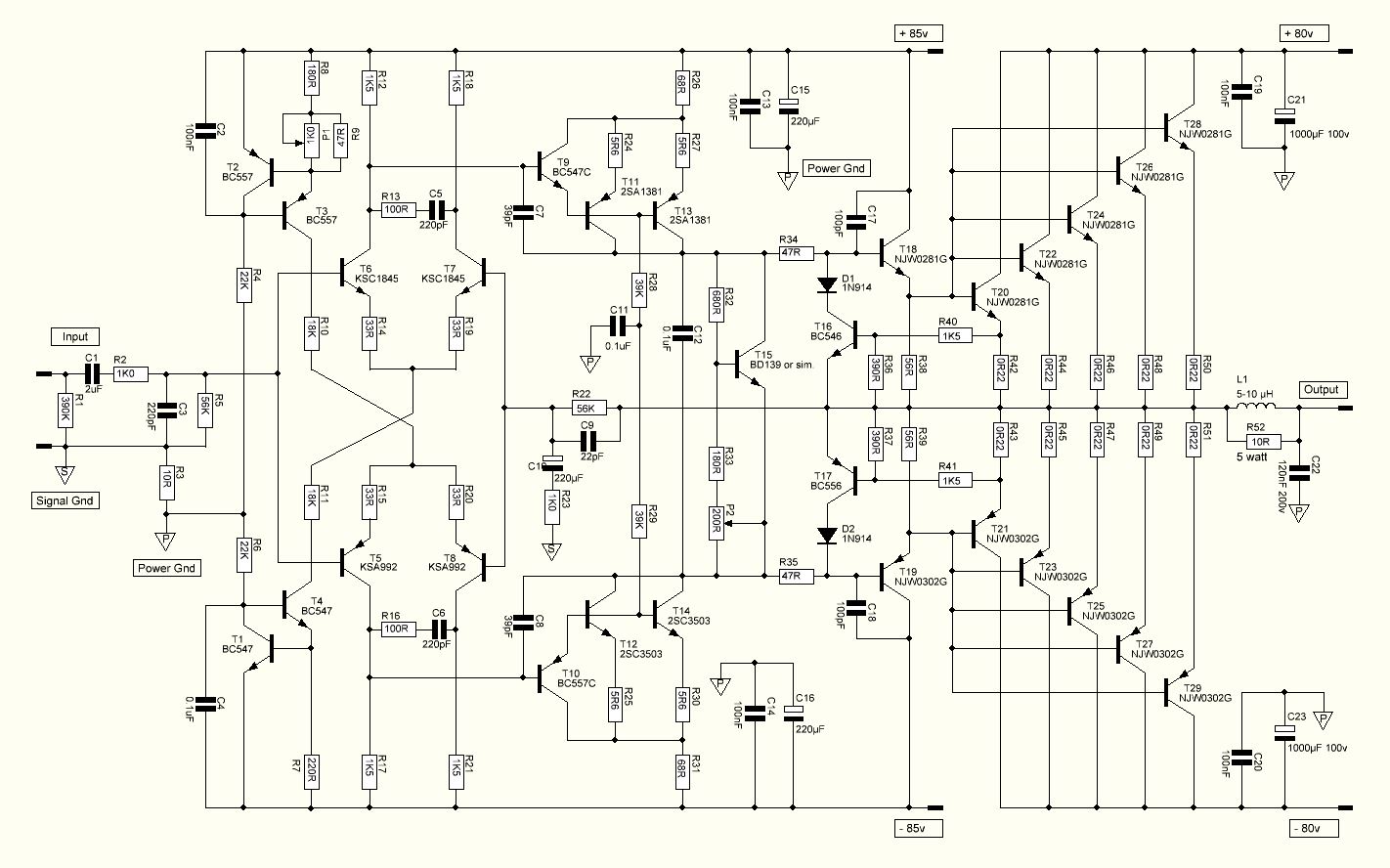

Second Stage. Paralleling transistors ok?
This is the schematic so far.

Anyway I feel I will abandon the parallel VAS idea. I was originally thinking about quality high gain TO-126's in parallel, but with the advice given here and after speaking with one of my guru amp friends (g'day Hugh) I decided to re-look at it.

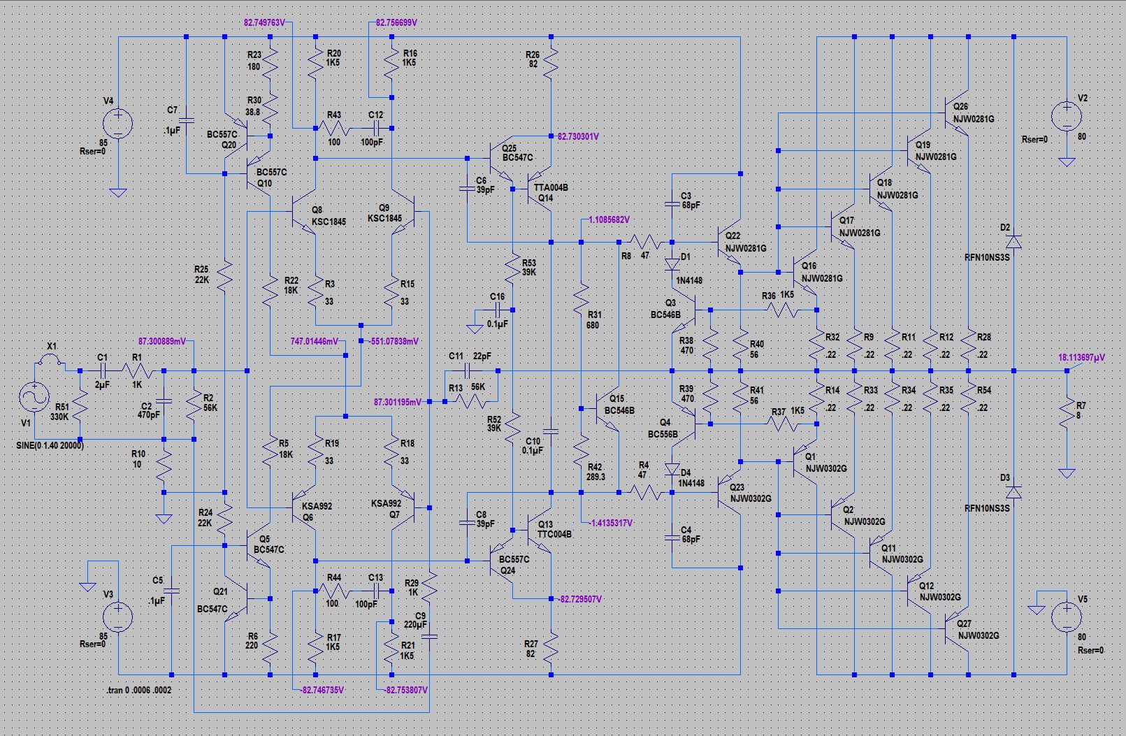

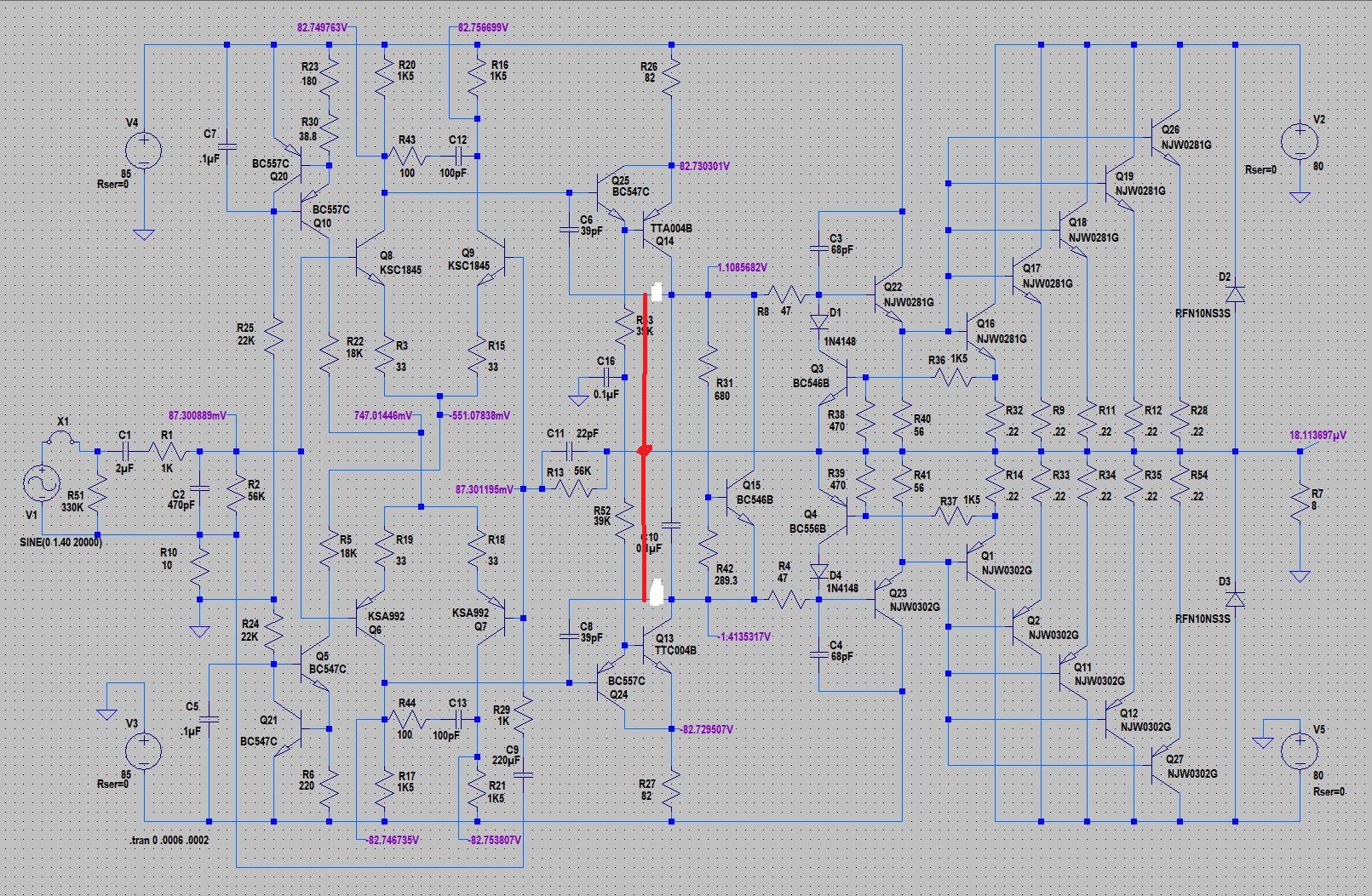

According to the SIM the standard VAS in this design (single or parallel) would demand a base current of around 100uA on the LTP. With the compound stage using a BC547/MJE350 & BC557/MJE340 this drops to only 4.5uA. This current does not vary much during high signal (less than 1uA) so all good in terms of linear regions. My guess is the MJE340/350 aren't super linear but the current through these doesn't change a great deal either - the hard work is done by the high gain output stage.
So the upshot is, I'm going to reverse my decision about the MJE340/350. I've been running them in all my other amps. Matched pairs of these combined with their power handling capability makes them pretty hard to beat.

As you're planning to use a higher voltage for the frontend, why not use a cascode? This shifts most of the work onto the upper transistor in the cascode, which can be a small signal device. I've used the MJE340/350 well in this arrangement
Hi jaycee, Simmed the cascode with a 3.3v zener so about 2 volts across the small transistor. This lowered the load on the LTP to about 55uA - pretty good, but not near the 4.5uA with the compound second stage arrangement. But for some reason I cant explain right now, the output waveform symmetry at clipping is better to just 0.02v difference vs about 0.15v!! I know it's just a SIM but wow! (not that we should care).

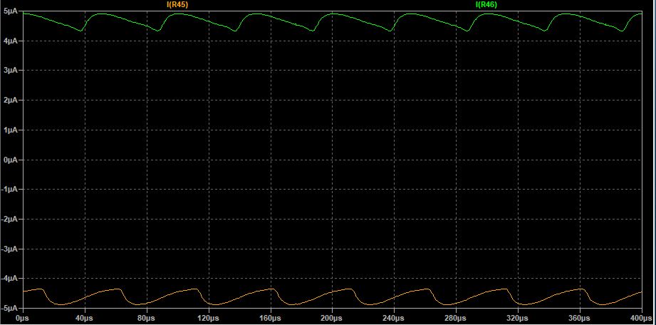

So inspired by the Krell schematic posted by Hpavictor I tried 6 x KSA992 / KSC1845 in parallel as top and bottom VAS devices, and while it simmed ok it was not as good as the compound stage. The loading on the first stage was at a minimum 40uA peaking to around 150uA at 20khz*. It was also quite asymmetrical with the lower side drawing half that - around 80uA peak.
Now most Krell ccts are more complex than mine so I'm not suggesting it's a bad idea, but just not that good in my schematic.
The compound stage shows very symmetrical loading on the LTP with only about 4.7uA loading (static). This rises to about 5uA peak at 20Khz but the loading symmetry is retained.
So as a result of what I found, I spent time simming some of the popular designs that load both sides of a single LTP or one side of a double LTP. The results were surprising. Some had a difference of 2 to 3 times ie: 40uA v 120uA with one design being much worse.
So does it make any difference? Who knows not me**. I would have thought though that loading on LTP tails should be the same.
Anyway this is the current drawn from the LTP's in my design at 20Khz and near full output.
Cheers

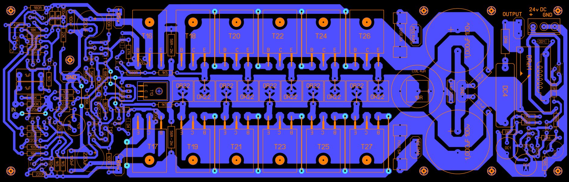

Hello, Quasi.
I like this amplifier.
At what stage of completion is it ?.
I have a question:
The relay is I think normally closed in operation and opens in case of DC detection. It's correct ?.
1000 µF capacitors. 1,000 µf ????.

Hi Jacky
The project is in progress although very slow, too slow to commit to a thread. I may start a thread when I'm about half way and post some catch-up information.
The relay in the DC protection circuit closes a few seconds after powering up and opens (releases) if a DC voltage is detected.

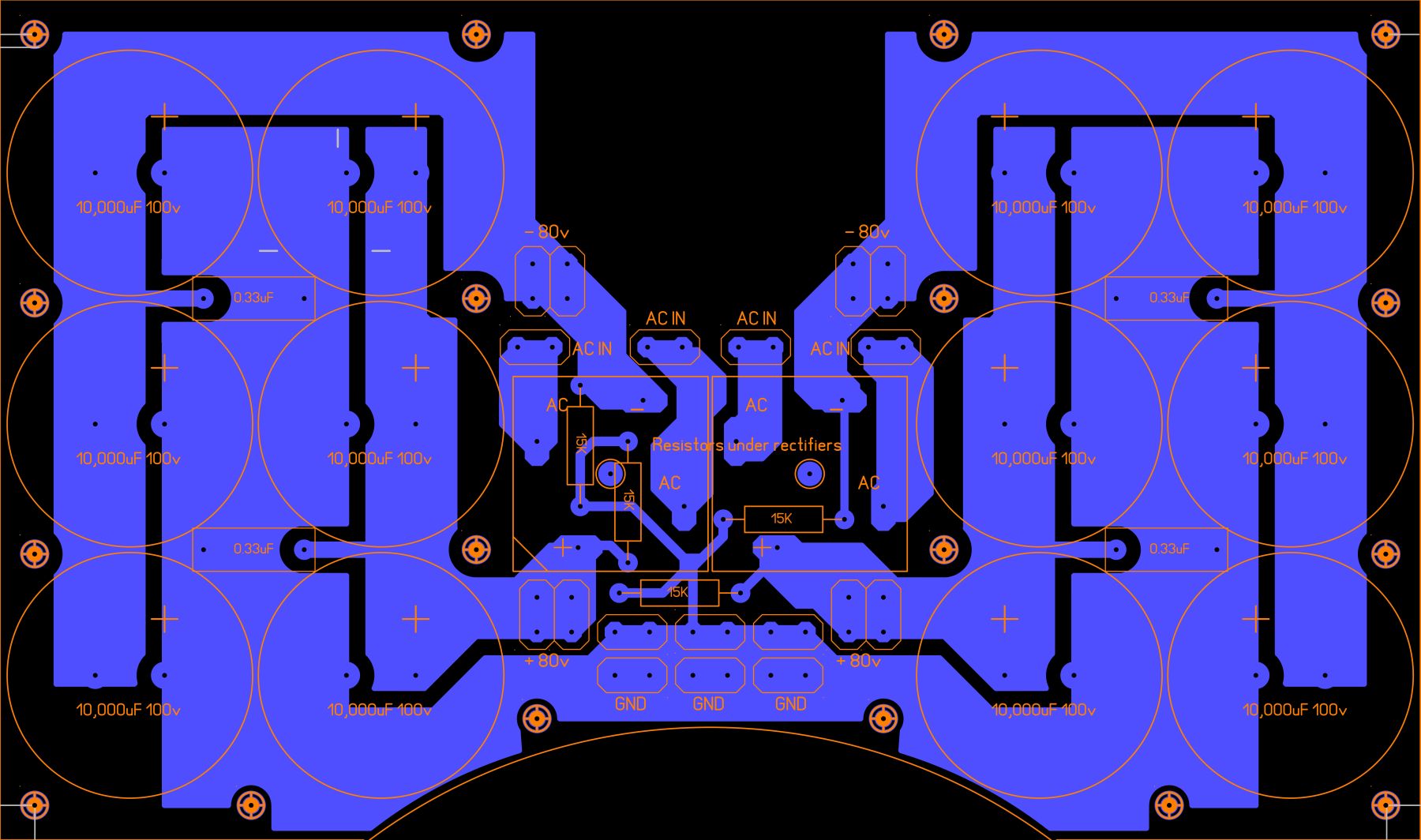

The 1,000uF capacitors on the amp PCB are bypass capacitors designed to make up for supply lead and fuse variations during higher power delivery. They could anything from about 330uF up but I chose 1,000uF. The 2 amplifiers will be driven by a complete semi-dual power supply that uses one 800VA transformer, 2 x 25amp rectifiers and 30,000uF filtering per rail. So we have one AC source to 2 DC power supplies. This almost achieves a dual mono power amplifier but not quite.
You can get an idea of the power supply from the picture. It is intended to sit close to the toroid transformer (what the curve is for).
Thank you for the interest in my project.
