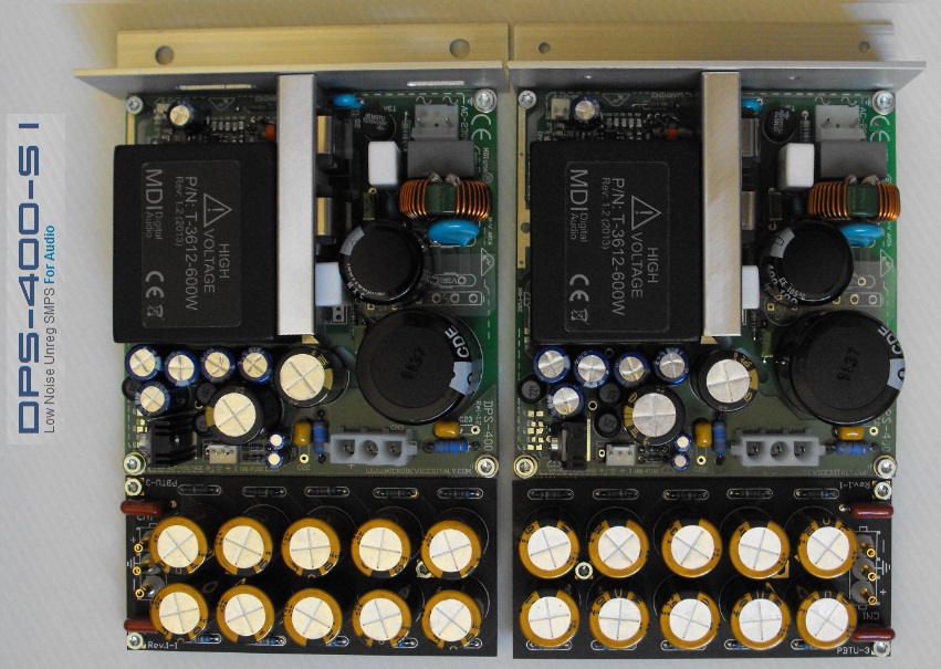

SDA-400 Professional multi-way
I made a small mistake in the previous pic. this is DPS-400-S1.
above is the same, except the PBTU-2 for + / -12 regulated low noise, for some amp models. we call DPS-400-S1/B compatible for ICEPower amps.
We wait a special high voltage caps for version "S2", I think 2-3 days and I can put the photo.

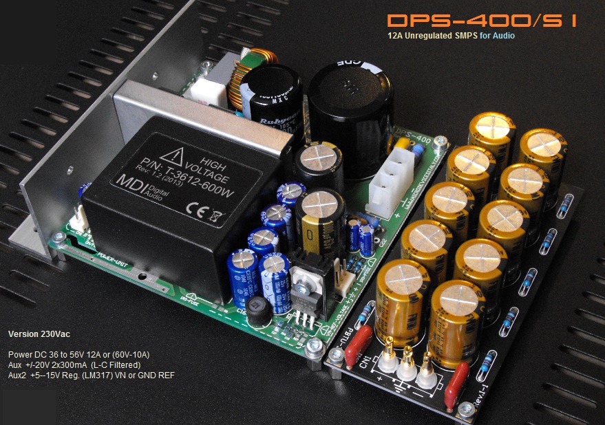

The DPS-400-S1,Provides professional Measures and reproduction of sound on amplifiers Class AB,in the range of 2x240W rms.
Or up to 350w rms (one for each amp)
This version also, supports up to 2x10000uF63V at output.

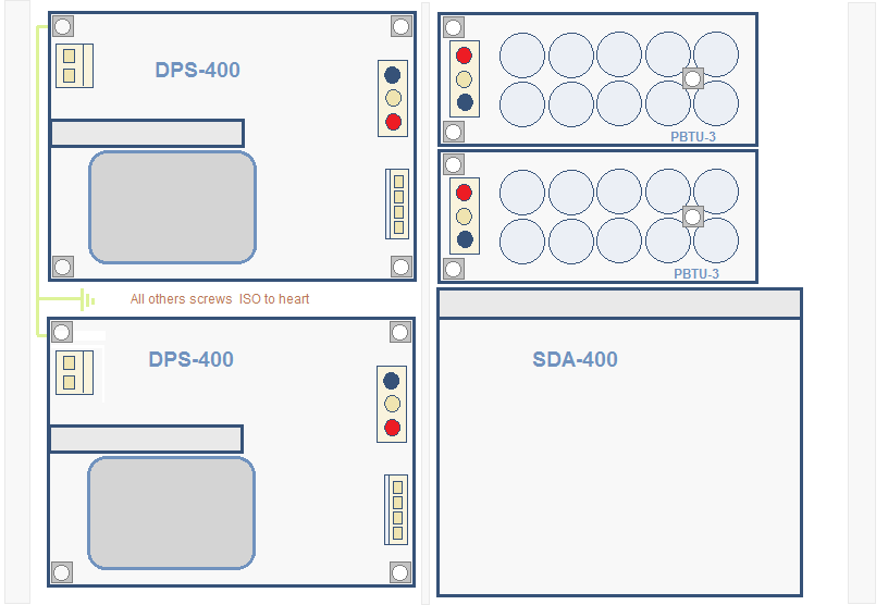

Thanks for shared your products.
You can follow this simple diagram,also well tested.
Remember the 2 small 10uF63V on Attenuator pcb.
Package complete? 🙂
P.S. this thread includes the photos of your version assembled on frame also.
Regards

Thank you for your answer Roberto.
Is your diagram for unbalanced version ? I will build unbalanced.
Also I thought of not using the attenuator board, is it not ok ?
The package seems complete as far as I can tell, I haven't gone through it all though.
This arrangement of the modules is independent of the type of input (unbal / bal) you want to use. (Dictated only by a better the hf noise reaction of 2 toroids)
I recommend the wiring diagram that I have already posted in this thread, Also for Unbal connection. no problem if you do not want to use att. board.
You can connect a shielded cable, 10Pin directly on the SDA, to the RCA input, just remember the jmp from (-IN) to AGND, just to SDA.

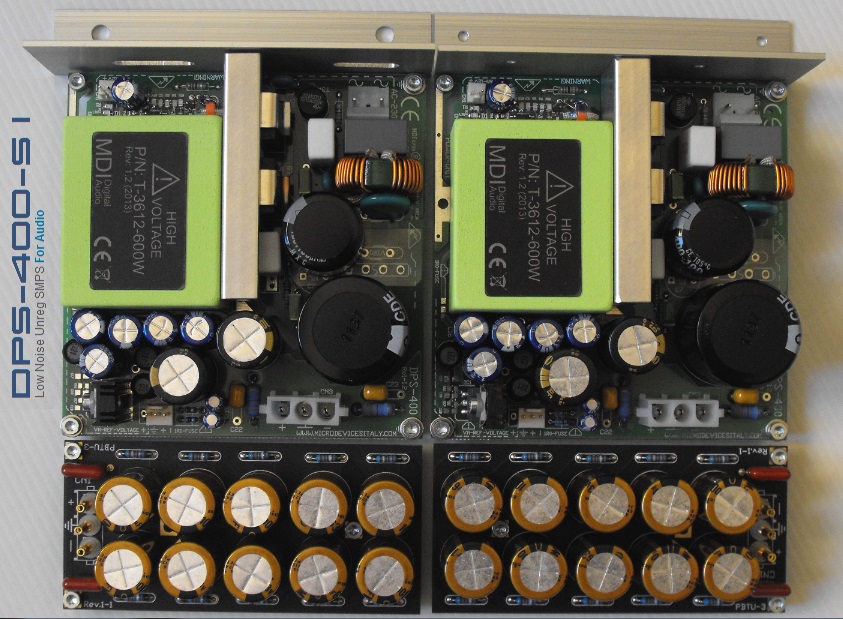

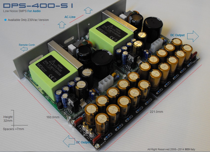

I have received the new DPS-400-S1 from our services,just want shared the version for diy. (Green Power-Unit)
The black Power-Unit, reserved for Audio companies.
Regards

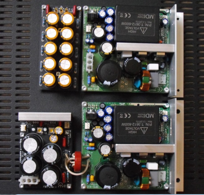

Hello,
got something today 🙂 :
Do you have any comment on the setup ?
I can't put the DPS side by side, they don't fit for a few millimeters...
I've isolated all but 1 screw on DPS, does the screws on SDA and PBTU need to be isolated from earth too ?
Also can I use fan 12v on the DPS to power the led on my switch ?
Thank you
Hi ..nice! very compact eheh.
The pbtu-3 are isolated.
route the sda please. emi filter side, not good near the input of sda.
or add the aluminum bar between smps and sda, 2mm thick enough.
for led yes, but at this point,use the remote controls. it includes the led function. (need main switch add)
I see the setup on dps-400 for 2x350w 🙂
P.S. what are dimensions at internal of case?
