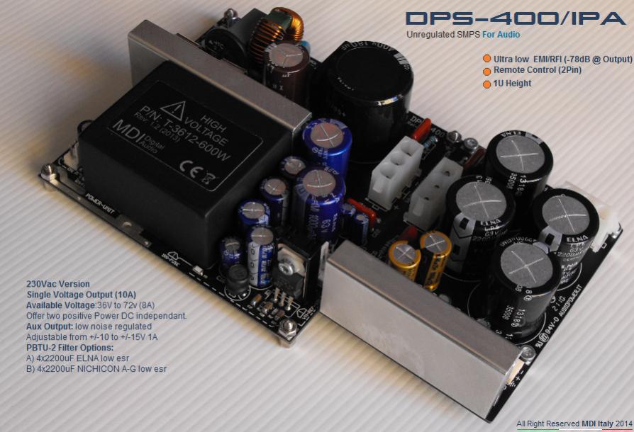

DPS-400/IPA
The last version for 250-500A ICEPower Amps.
It offers two independent positive DC output for better decoupling, in the case of two power amps.
-78dB at the output (300mA @ 70V) F0 = 120kHz
well studied for Class D Amp.
Availability 10/05/2014
Price: €85 VAT Incluse. (Option Caps as default: 4x2200uF63V ELNA Snap-In
Regards

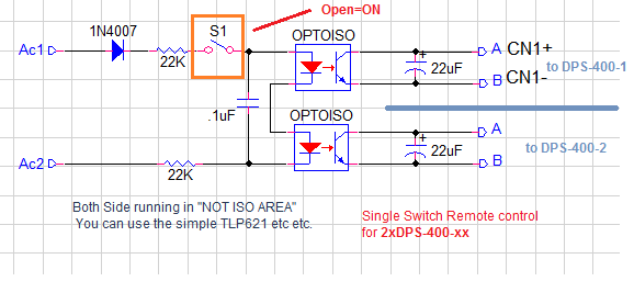

As DrizztDo have one way switch for remote control of two dps-400.
Suitable only for DPS-400 pin control.
Res 600mW metal oxide
C 0.1uF ceramic 250V
2x22uF 25V
