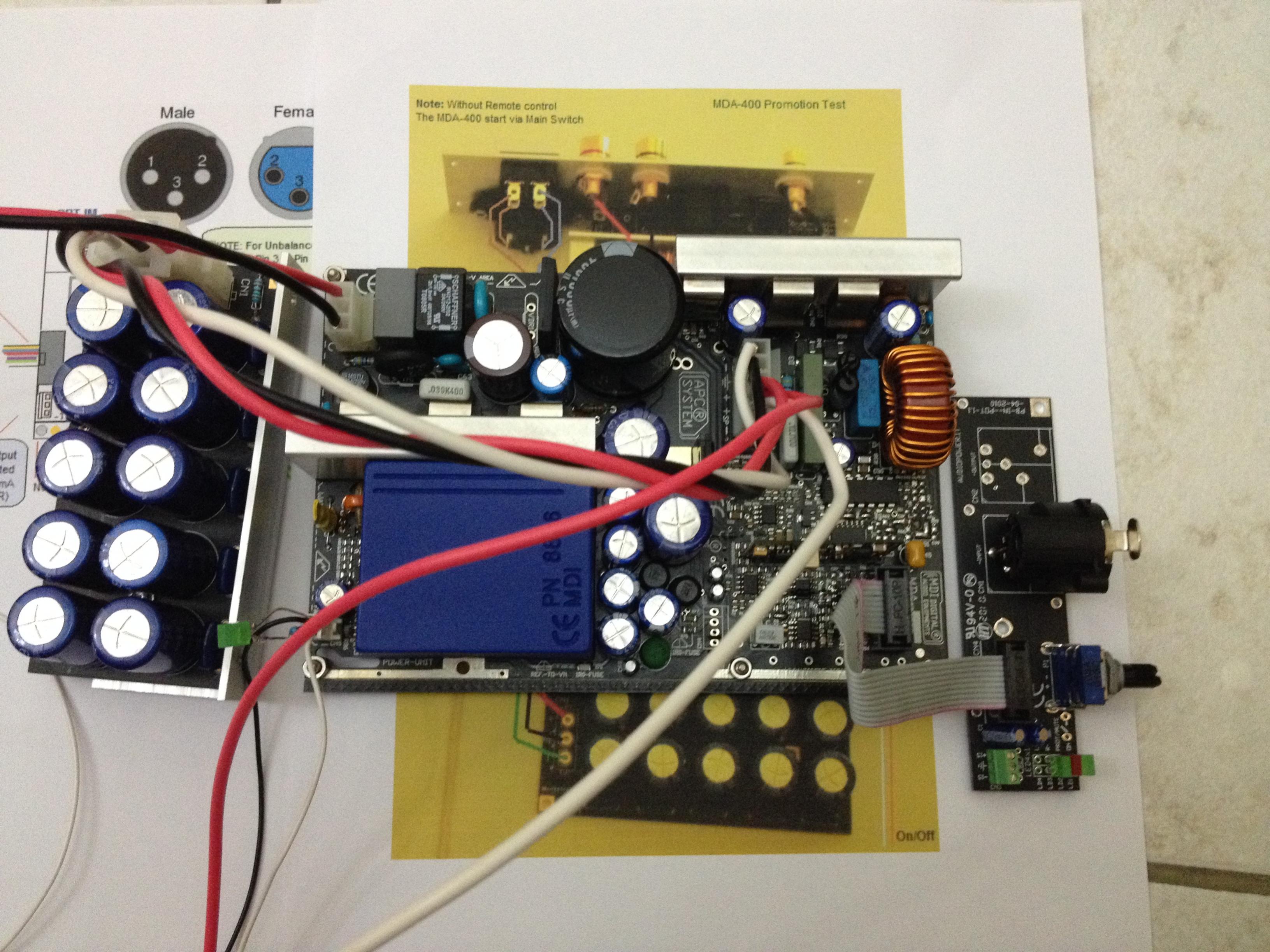

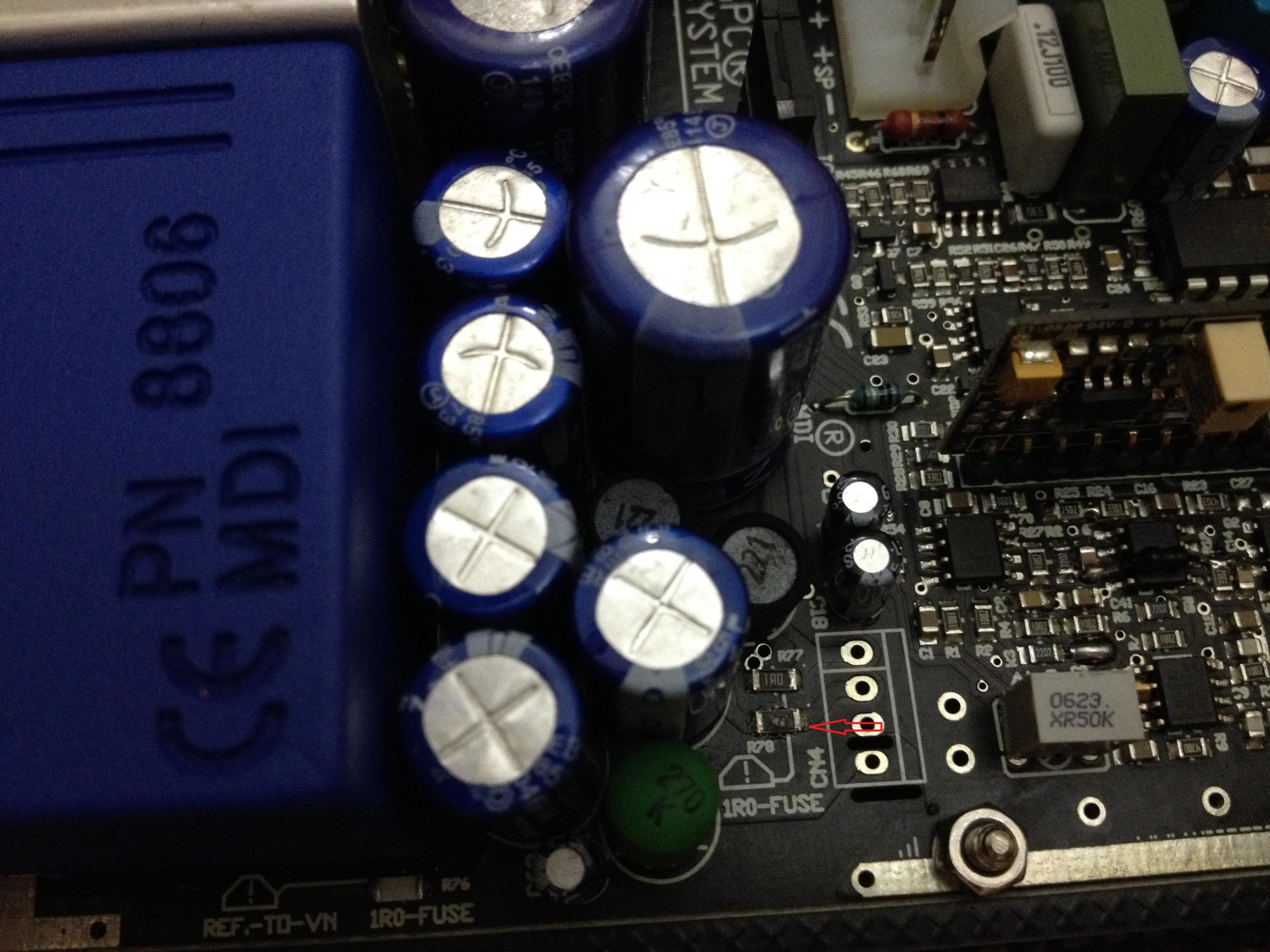

Hi weskoki, just want to ask you a favor if you can give me the value of the SMD resistor in the MDA400 promotion kit because I tried to power up the amp earlier tonight and this resistor got burned. see the attached picture.
regards,
mj777
Hi Nimaj,
do you know the value of R78, as stated on my earlier post #631?
BR,
mj777
Hi mj777,
The value of R78-R77 are 1206 1R used as fuse according to Audiopower. You can actually ask all your questions to Roberto and/or Stefania on this forum:
